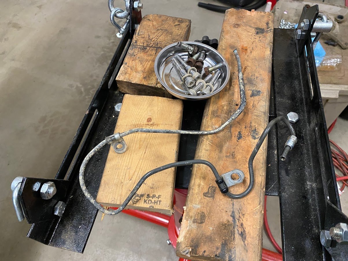

    Yep I was able to cut out and remove this rats nest.

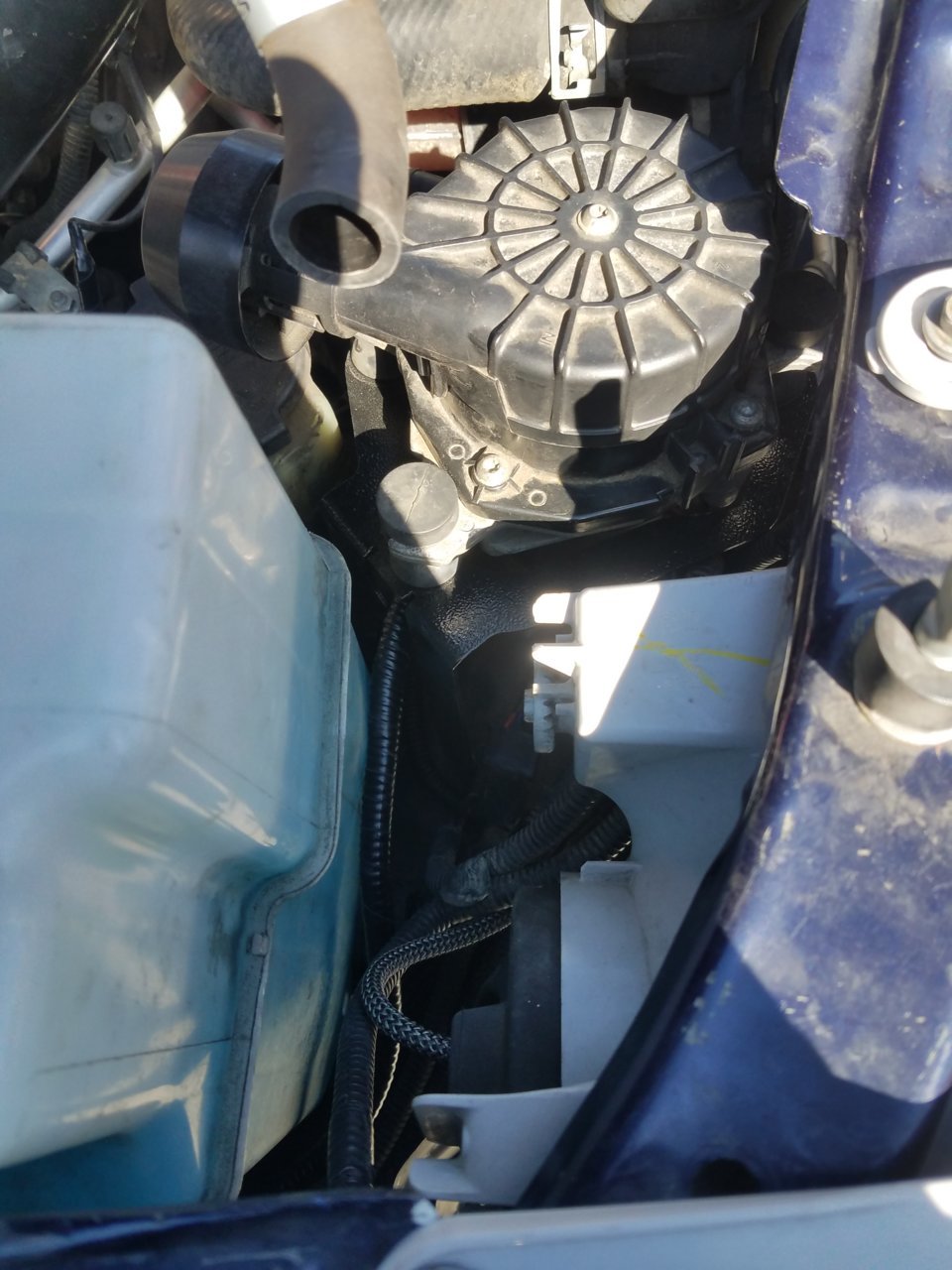

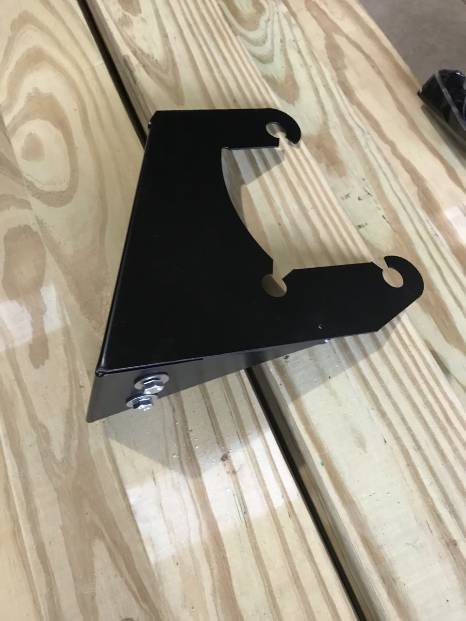

    @12TRDTacoma did you ever get your SAI pump sorted? I have a bracket from my AFE if that helps.

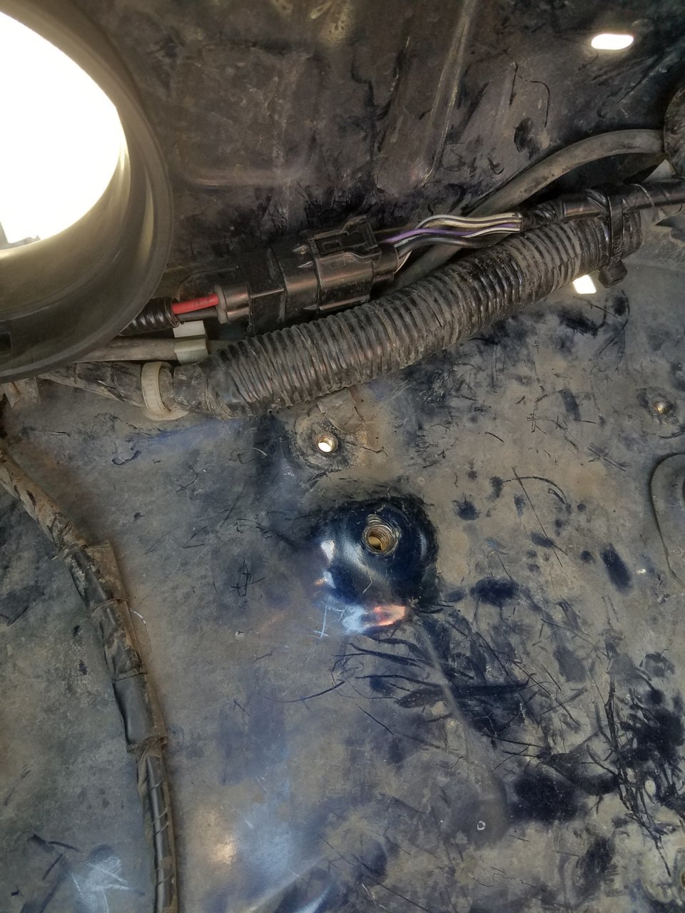

    Thank for following up on that brother. I did take care of it, but right now I am in a situation where I am going to have to lengthen the air pump wiring in order for it to reach the main harness connector. I'm currently trying to figure out what AWG size the wiring is, as it looks pretty thick and definitely thicker than 16 gauge but smaller than 10 gauge wiring.
    https://www.tacomaworld.com/threads...ricks-and-mods.518932/page-1305#post-23126723

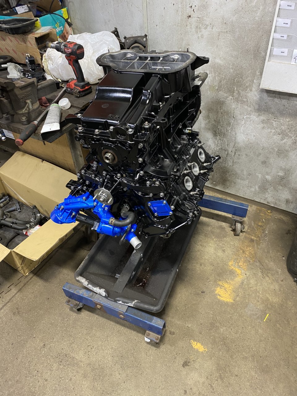

    Lift, pedal commander, led foglights, led interior lights, led back ups, led under lighting, urd tcai, led headlights, methanol injection, 76mm tb, hood struts, dif breather mod, ratiotek trans kit, x-series gauges, true cool trans cooler, belt wrap mod, 2.8 pulley
    so glad we opened this up for service. definately not what i was expecting to see. hope its running as it should now!
