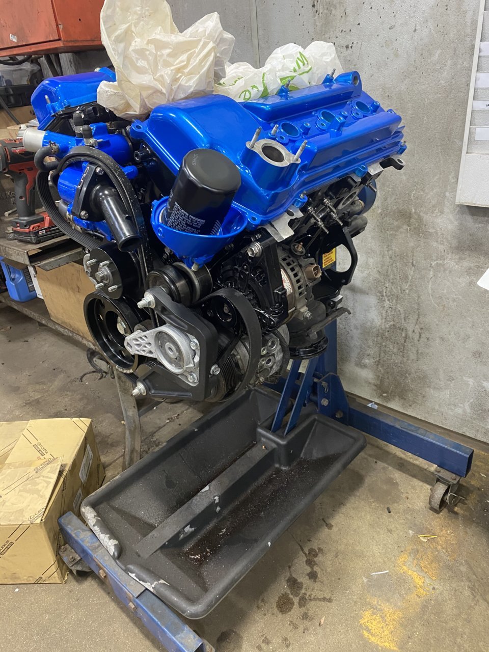

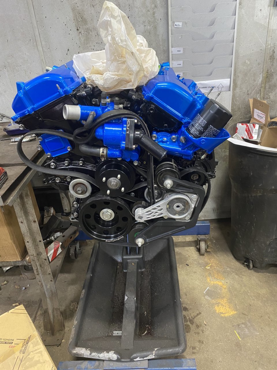

    Wow that's an expanse of a gap.

    Got an oil pan spacer for that thing?

    No sir. Would be the time to install one. Got one laying around?

    If I had one to share I certainly would. @Coupe might still have one laying around. Worthy of an ask.

    Put that beesh in!!!!

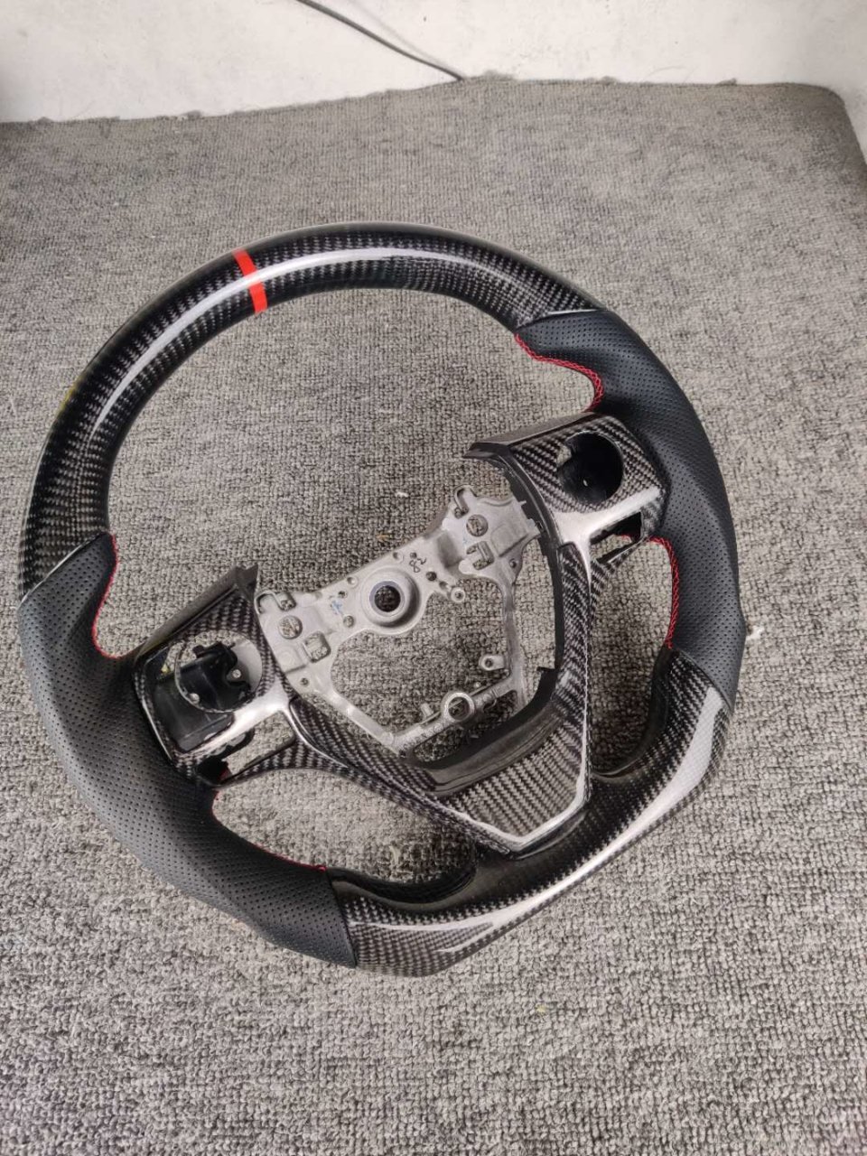

    I had to step up my steering wheel game @12TRDTacoma
    Full carbon

    Ooo.... Very nice!
    I'm not a huge carbon dude so I'm going to keep mine the way it is, but that sure is pretty!

    Is our airbag just a direct swap in? What about the Airbag cover/ horn center piece? Do they come as one whole unit?

    you need to use the airbag from a corolla also. The air bag is plug and play, for 2015 everything else is plug and play also.

    For every other year the air bag is plug and play, yes, but the steering wheel controls will require a major rewire and a repin as well, as the Z1 plug the Tacomas have at the spiral cable and Z5 plug that the Corollas have are vastly different.

    Is yours a 2013? I think 2014 is plug and play also.

    his is 2012 but I believe its the same as 2013-2015. There are a few wires missing in pre 2014 that need to be added. I had to add a few things when I swapped in the 2014-2015 controls and radio before.

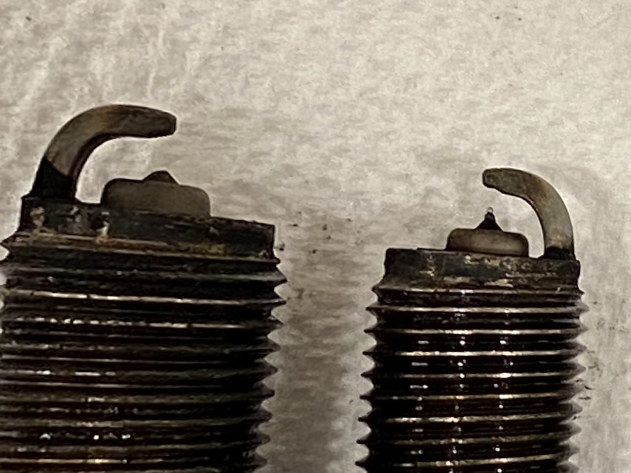

    Yeah... surprised cylinder #1 didn’t misfire with how bad the plug was.
