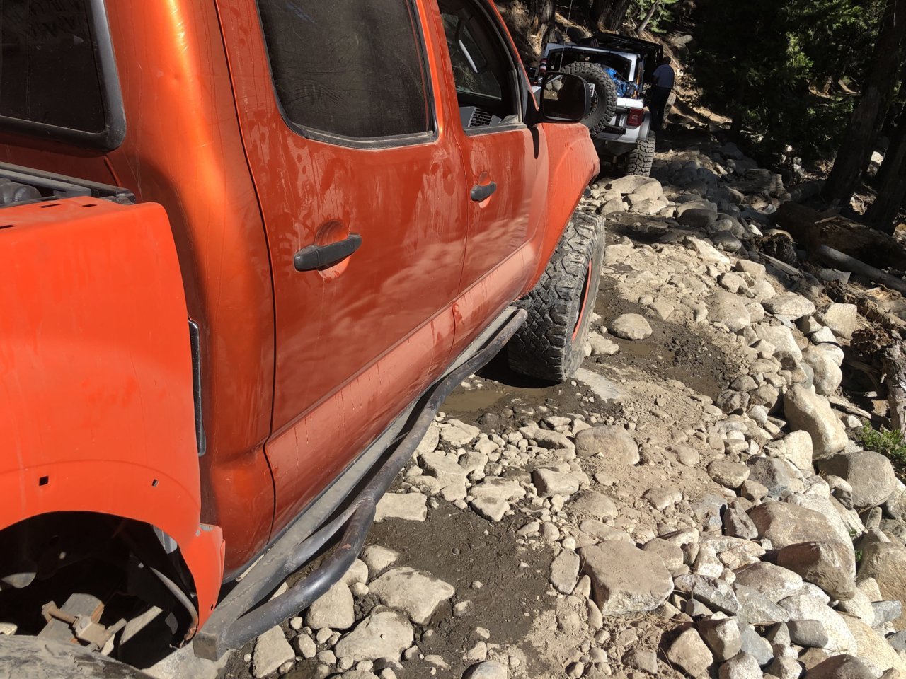

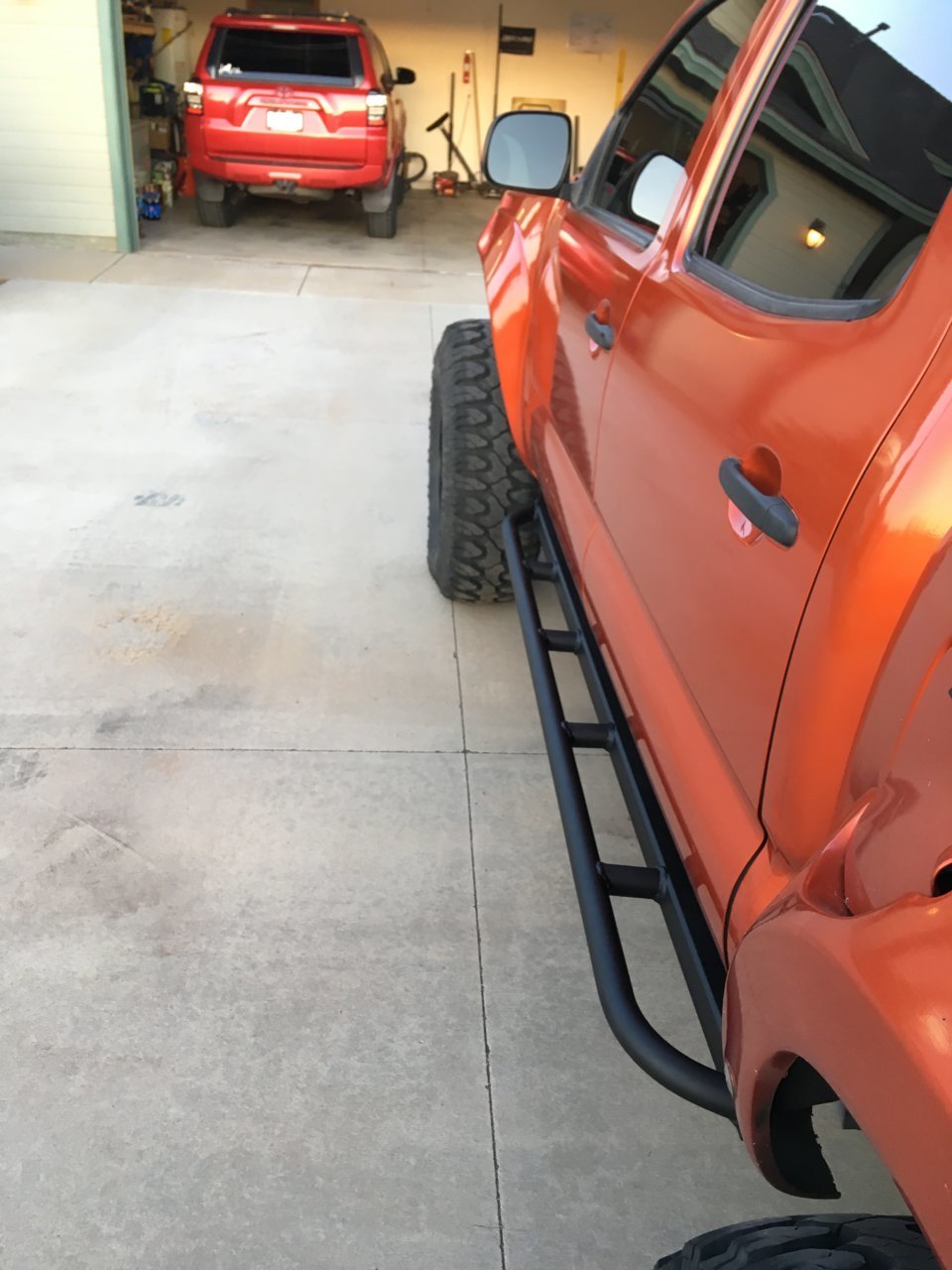

    I could be wrong as it’s hard to see in the picture, but I only see 1 tube support between the outer tube and “main tube” as I like to call it. And again hard to see but do you have 2 or 3 legs going to the frame? 3 is alright, 4 is better, 2 is not enough. DOM helps if it is 0.120” wall and will be better than hrew, but anything thinner than that will bend for rock sliders.
    Less supports between the outer and main tube will allow it to bend like my old ones.
    Granted these held up for almost 8 years before this happened.

    So it is 0.120 wall DOM. It has 1 support between the outer and main tube, and 3 legs to the frame.

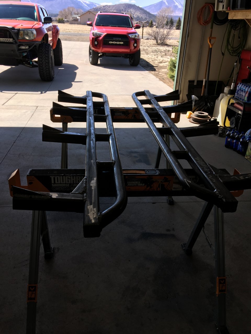

    3 legs to the frame will be fine but I’d add 2 more legs between the main and outer tube if you can and if you plan on putting them to good use.
    My new ones are all 1/4” wall, 4 legs to the frame, 4 between the main and outer tube, and 3/16” plate along the whole frame. Way overkill, but should be bomb proof.

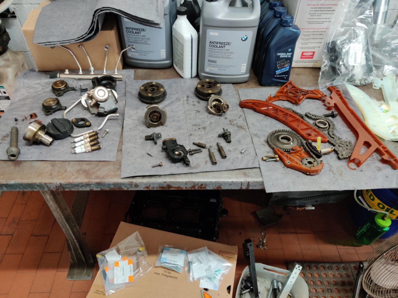

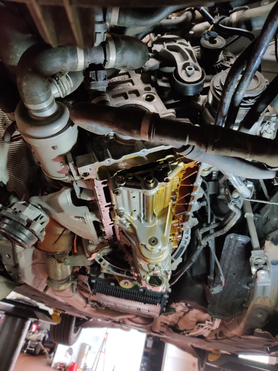

    I'm having fun with timing chains and broken guides today.

    no it is not my tacoma. its a clients vehicle. look at the front of the block. lol!
    i did all the timing components and valve guide seals when i installed the super charger. oh yeah, i now only burn about a quart of oil per 5k miles instead of every 800-1000 miles.
