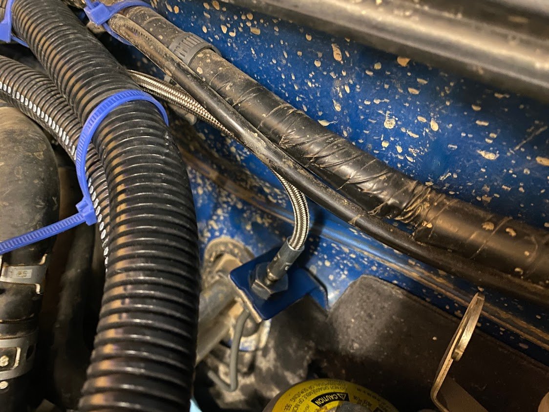

    This is the way. Wanted to thank you for this post. I did the same on mine and it cleans up a ton of that high pressure line that is all snaked in and around there.

    It does. Your chatter may end sooner, do to the CM TOB. It took quite a while for mine. About 2k miles.
