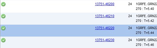

    Should I be aiming for
    .15 to .20 range? not .15 to .39
    .29 to .34 range? not .29 to .39

    I'm just using the charts.
    .20 mm is the middle of the allowable range on the intake.
    .34mm is the middle of the allowable range in the exhaust.
    I wanted to ask. Did you get the same gaps for each pair of valves? Like Cyl #1 intakes both measure .30mm and have the same buckets? etc...

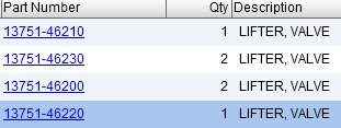

    The buckets you need are the numbers I wrote in red.
    I posted the part numbers below that.
    Double the quantities if in fact each pair of valves has the same gap and bucket.
