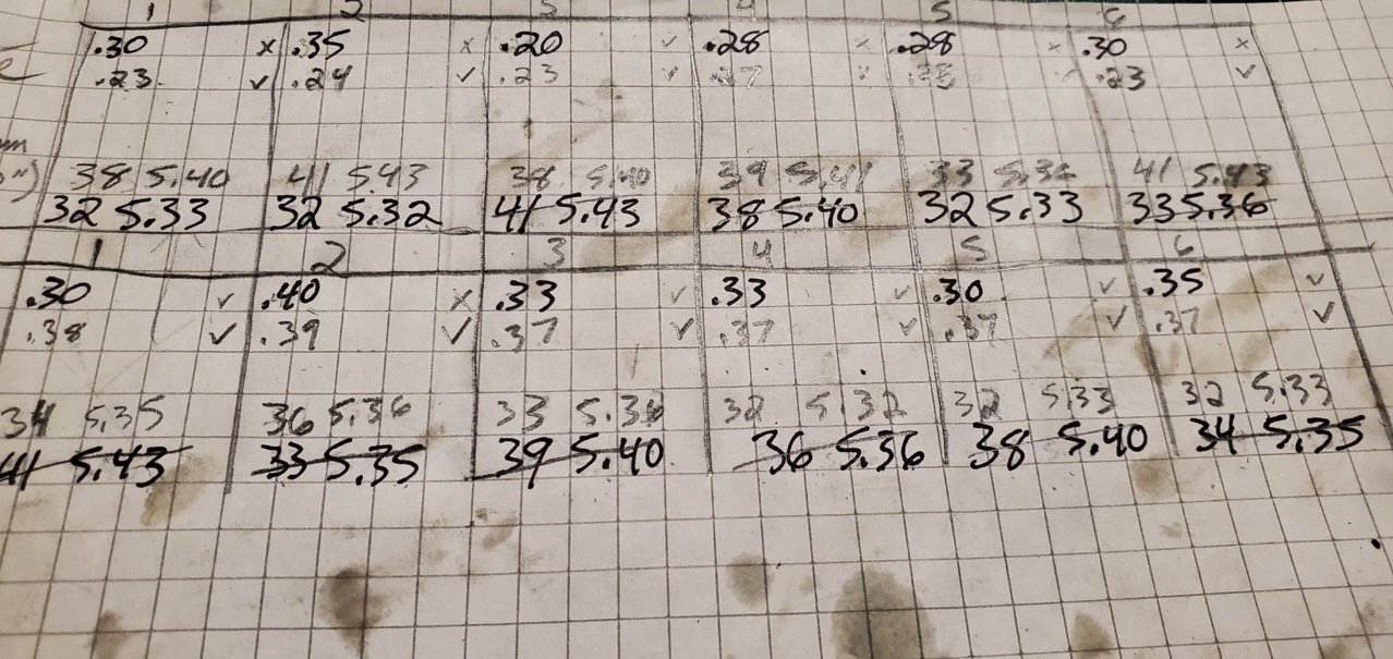

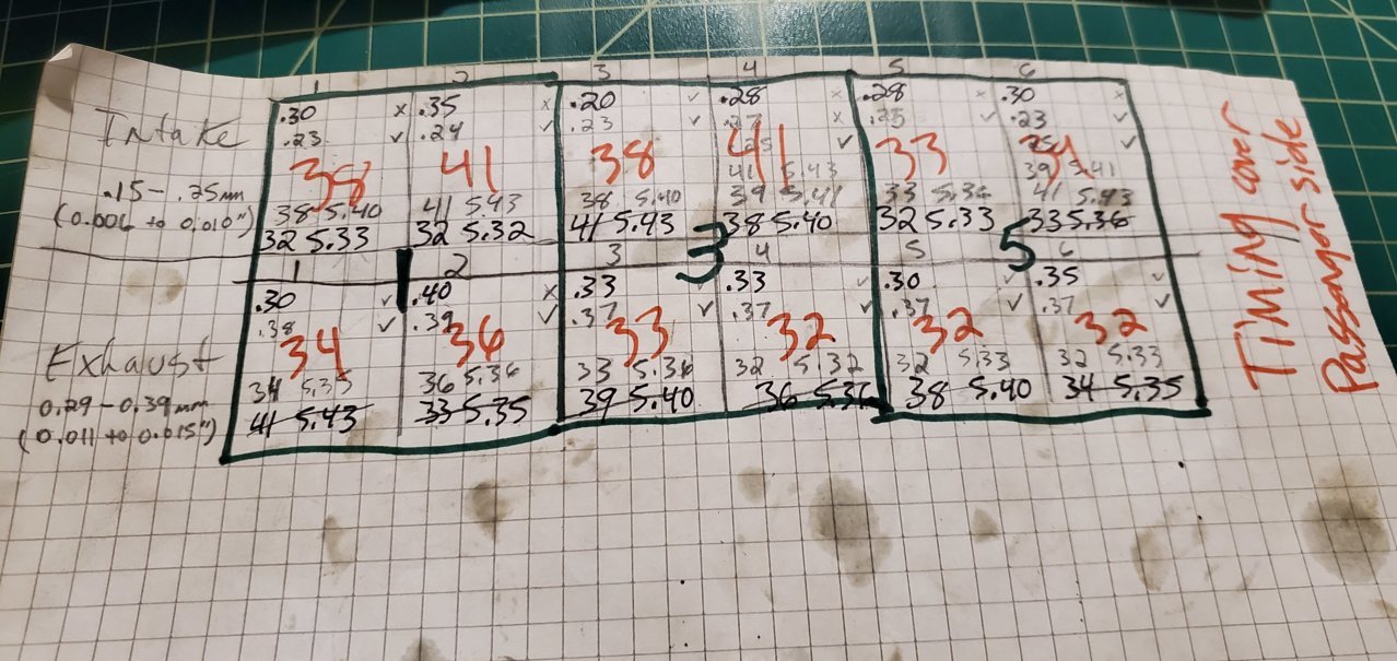

    @BillDaCat8 everything is CLOSE now and only one is truly out of spec by .02mm I'm going to order new. but this will get me on the road for now.
    Is there a link to all the cup part numbers? The service manuals I have do not have them. Or is it in the EPC?
    Thank you by the way.

    Ah so! Now there’s all the numbers! Will re-visit in the am. You’ve caught me “post cocktail(s)”.

    Here is the final Move around for this to get me on the road. all within spec
    I took the original stuff as is. Then started to move all the cups around on paper to get them in spec. Might not be the right way, or the easiest. But its what I have to work with right now.
