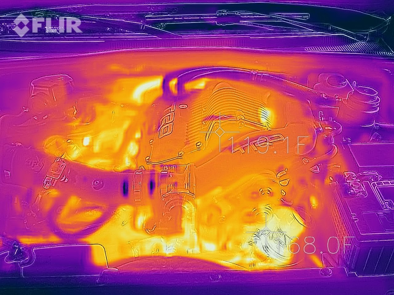

    I'm seeing that the plastic SC coolant resi insulates the heat rather well and is in a cooler part of the bay. Now if the same pic were to be taken with an aluminum resi... I do wonder if the resi would become a heat sink in itself to a degree. I think it would have to.

    Plastic is obviously an insulator and aluminum is a conductor, so the aluminum canister would conduct heat from the engine bay whereas the plastic one would insulate against it. The question would be does the increased capacity of the aluminum canister offset the heat conduction tax? Or what if one was to daisy-chain two plastic canisters?

    My thinking is if the resi is giving off heat, it is itself taking heat out of the cooling system making the coolant cooler.

    I cant recall the other brand folks have but do they give any reason why they made theirs out of Aluminum? Also with folks adding the CSF radiator and bringing temps down your thinking was how I was looking at this as well.

    Figs is the other brand/name brand. They don't go over why they chose aluminum that I've seen

    Aluminum is a conductor. However, it dissipates heat very quickly in comparison to steel and does not heat soak. I think it is splitting hairs on the material based upon its position in the engine bay as well as you would have to compare the delta of coolant temp vs ambient external temp as to which way the heat transfer would be occurring.

    Conductors absorb heat to equalize it between environments, that is it will transfer heat from whatever is hot to whatever is cold. If it is 130 degrees in the engine bay and the coolant is 100 degrees, it will input heat into the coolant. If the coolant is hotter than the engine bay, it will radiate heat out of the coolant into the engine bay. But it isn't apples to apples either due to the increased capacity. A coolant temp test would be the easiest way to tell the performance delta.
