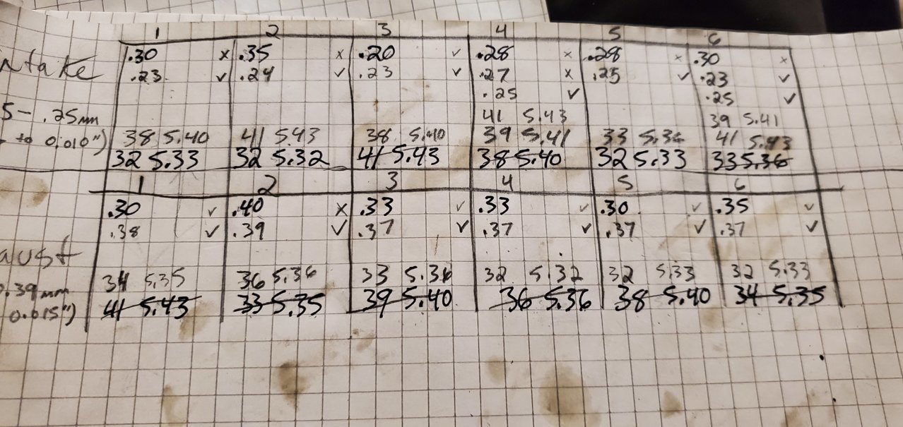

    That’ll certainly work. If you follow the charts, they suggest setting things up a bit tighter. But, the way you’re doing it is certainly fine. Definitely less expensive as well.
    You are at the “looser” end of the allowable gap like this. You had mentioned quieting the valves down. In my head I was thinking mid-spec or tighter in the intake and pretty much 50-75% of spec on the hot ones.

    This isn to get it on the road again. Same here with cams. When I do mine. I'm doing the complete upper end. Springs, valves, cups, seals, etc. Couple months. Didn't want to grab hundreds in cups that I wouldn't use again. If I am out farther than 3-4 months though, I am going to order the proper cups and get everything as close to the low end of the tolerances as possible.
