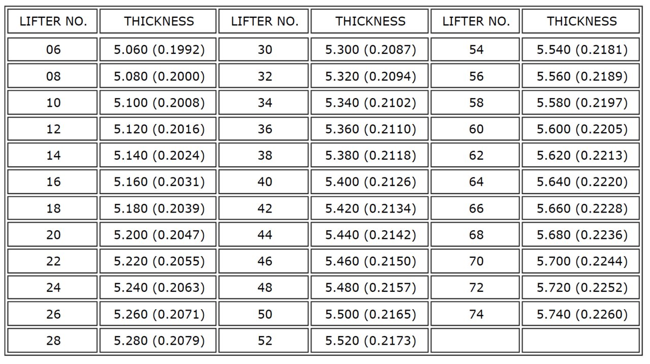

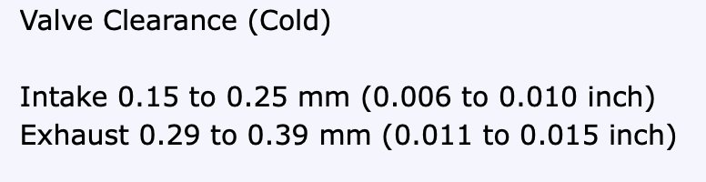

    If you remember, I was asking for the tolerances a couple weeks ago. Appreciative to all that contributed to that. It is simple once you have the tools you need to do it correctly.
    1. Feeler Gauges - Offsets are nice - https://www.amazon.com/ABN-Universal-Standard-Measuring-Thickness/dp/B01IPWOAOQ/ -- But these https://www.amazon.com/Acarte-Blades-Imperial-Measuring-Teaching/dp/B07C9YCZ17/ --- or the stainless versions are perfect as well https://www.amazon.com/Stainless-Universal-Standard-Thickness-Measuring/dp/B07XPD9L1C/
    2. Micrometer - Something like this.https://www.amazon.com/Micrometer-Professional-Thickness-Resolution-Protective/dp/B07DNNX9Y3/ - Personally I use the Mitutoyo normally - https://www.amazon.com/Mitutoyo-293-180-30-Micrometer-Digimatic-IP65-00005/dp/B01M3SLYFZ/ Any will work. The cheapie is a one handed click version, this Mitutoyo is also. One handed is best for this https://www.amazon.com/Mitutoyo-293-348-30-Digimatic-Micrometer-IP65/dp/B00N4MCLA8/ Just needs to be the 0"-1" measurement version. -- Useful tip, don't need to open the micrometer all the way to put cups in and out to measure. Open it up to ~10mm and tilt them in and out.
    3. 24mm Wrench to move the cams. https://www.amazon.com/Craftsman-Polish-Metric-Pattern-Combination/dp/B07CXPPWVK
    4. The chart that has all the numbers on it. Including the cup measurements. Attached to this post at the bottom is the .pdf
    Screen Shot 2020-04-22 at 12.02.57 PM.jpg Screen Shot 2020-04-22 at 11.57.11 AM.jpg
    5. paper, markers, pencil - I put my Hard Measured numbers in Black ink/ marker. Then used the pencil to move new numbers around and do the addition, subtraction and crossing out of numbers.
    You can do without the Micrometer if you aren't worried about possibility of wear on the shim putting it a couple thou out of spec. Just use the numbers on the cups and reference the chart.
    Process is simple enough. Pull the valve cover. Start using the feeler gauges and shove them under the round part of the Cam bottom. (Bottom of PEAR) until they cant fit anymore. the last one that fit is your tolerance/ measurement.
    on the intake and the exhaust that is in the same position. Move the cams again to get the next set, and one more time for the last set. (You are measuring 2 valves on intake and 2 exhaust on another cylinder at a time.
    Make the 3 boxed for the intake and the same 3 boxes underneath for the exhaust. Put the numbers in the box as you measure.
    I measured each cup/ shim. as you could see, only a couple were out of spec by .01 or so. Ultimately that slight variance got me in spec.
    If you are starting with all new components. Including cups. Put all your new springs, cams, valves, etc. in first. Use the old cups in random order and you should be able to measure them all in the manner I mentioned above. Then start switching all the cups around on paper. Adding and subtracting the differences in cups to get you in spec or close to it. Then order whatever additional cups you need.
    Each CUP is 5.XX mm
