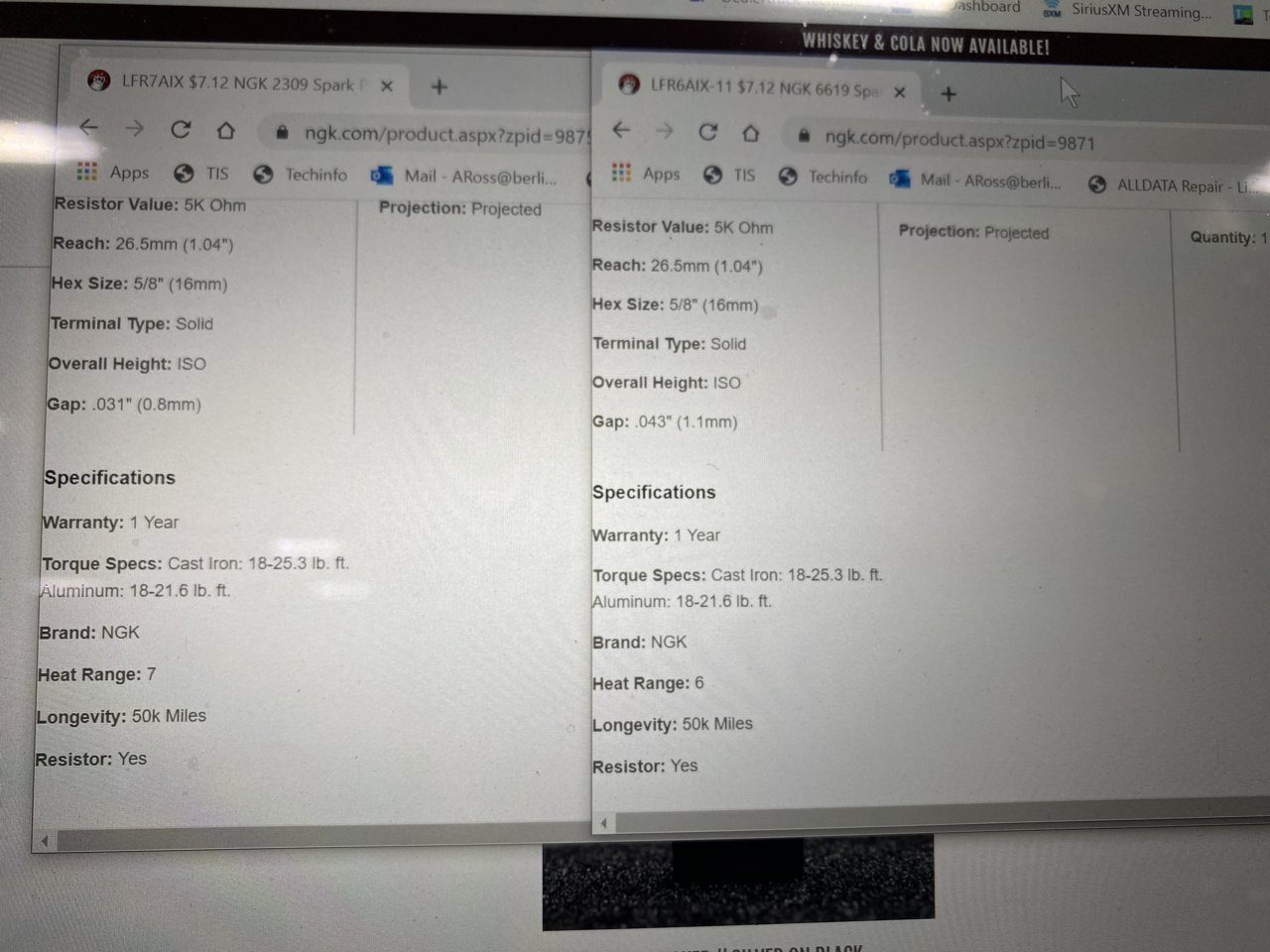

    These plugs aren’t on the first page. Can someone please explain to me the difference.

    image.jpg This is the difference on the website. The lfr7aix on the left and lfr6aix on the right. Just different gap/ heat range.

    @o0opackersfano0o those are a heat range 7 plug with a likely gap of around .031. They a step colder than our own.

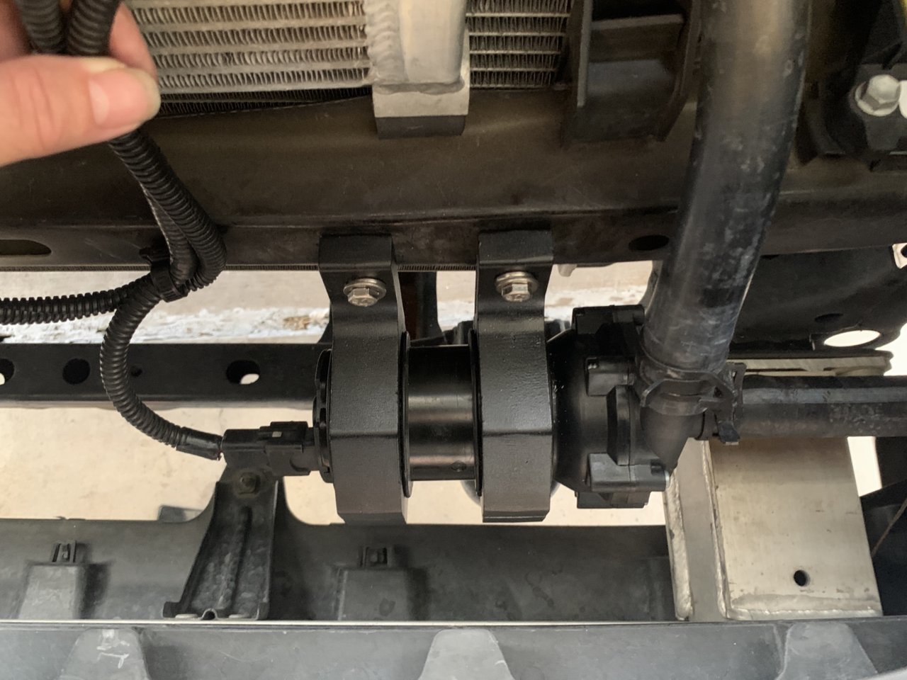

    did you get the 2.375 that shows up first? I had been debating on getting some of these before after @White lightning boosted posted his.

    one clamp is fine. my dumbass bought two so i used both.
