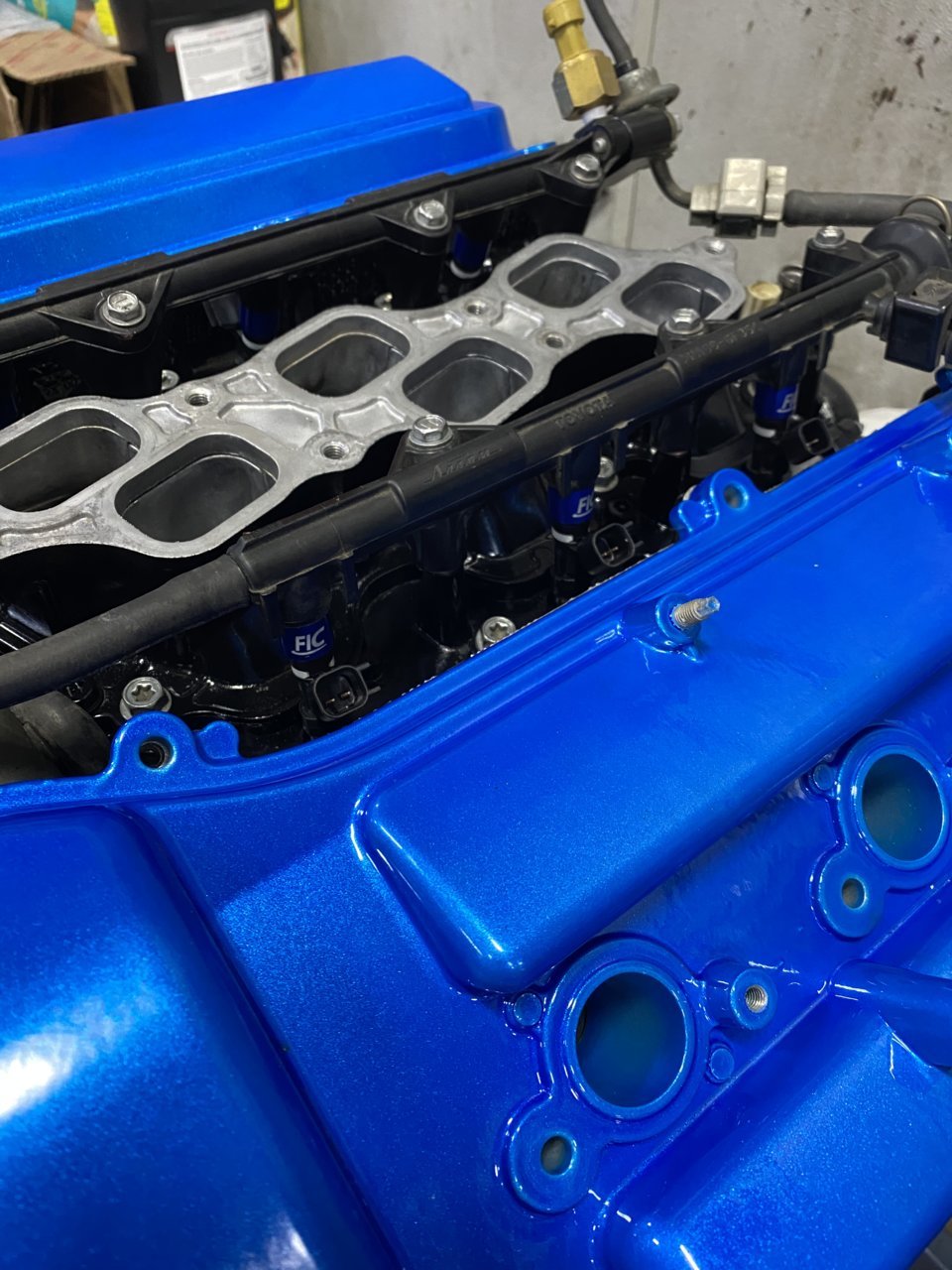

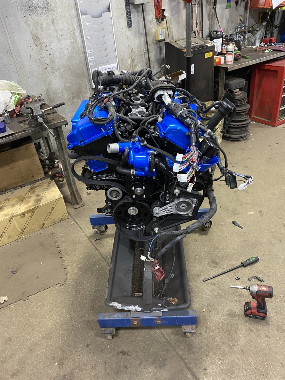

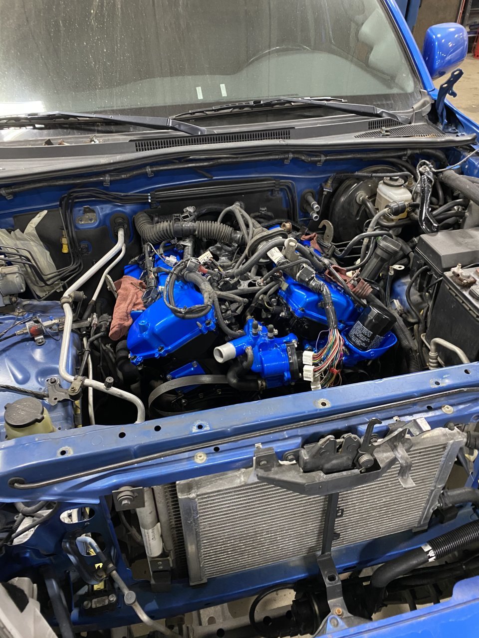

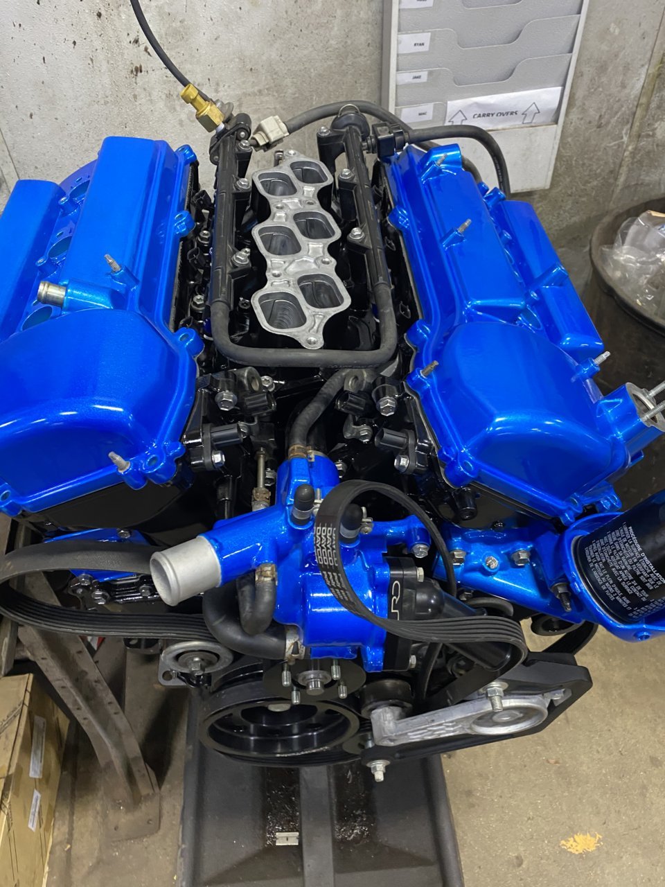

  10. Apr 24, 2020 at 9:14 AM
    snowsk8air2
    snowsk8air2 how hard can it be?
    Sep 16, 2011
    #63607
    10,558
    Flagstaff, AZ
    Supercharged TX Pro
    2011 S/C and basic mods
    Just needs to get a little dirty and that blue will match up perfectly
  11. Apr 24, 2020 at 9:23 AM
    Torspd
    Torspd Tor-nication
    Sep 18, 2009
    #22958
    26,471
    Tor
    The Great America!
    MMVI 4.4L 4x4 Access Cab
    Torspd Custom Turbo kit [] Borg Warner 9180EFR Turbo [] Haltech Elite 2500 [] TiAL Q BOV [] TiAL V44 Wastegate @ 15psi [] CP Pistons [] CP Carrillo Rods [] ARP Head studs [] ARP Main Studs [] ARP Header - Head Studs [] Ported Heads w/ 1mm oversized valves intake/exhaust [] Brian Crower Forged Stroker Crank [] Darton M.I.D. Sleeved Block [] Kelford Camshafts [] Torspd 160* T-stat mod [] APR Large Fuel Rail [] Walbro 460 LPH E85 Fuel Pump [] FueLab FPR [] APR T56 Conversion Kit [] KP RACING Built T56 [] McLeod Racing Custom Twin Disk Clutch [] One Piece Aluminum Driveshaft [] MGW Shifter [] Custom lowering kit [] Ohlins Front Coilovers [] QA1rear shocks [] Custom Ron Davis Radiator [] Dual SPAL Electric Fans []
    :laugh:
    12TRDTacoma[OP] likes this.
  12. Apr 24, 2020 at 9:25 AM
    Torspd
    Torspd Tor-nication
    Sep 18, 2009
    #22958
    26,471
    Tor
    The Great America!
    Pretty close to fluid fill and engine break-in time! :woot:

  14. Apr 24, 2020 at 9:36 AM
    nudavinci64
    nudavinci64 Robert @ Holy Horsepower
    Nov 14, 2013
    #116533
    10,146
    Robert
    San Mateo/Cayucos, CA
    13 S/C TRD OffRoad 4x4
    Boosted Money Pit....
    I have to say that is looking pretty clean but with Packers Fan, I was expecting a different color theme. =p Will be nice when you get it all up and running. I am hoping to have my truck running this weekend.

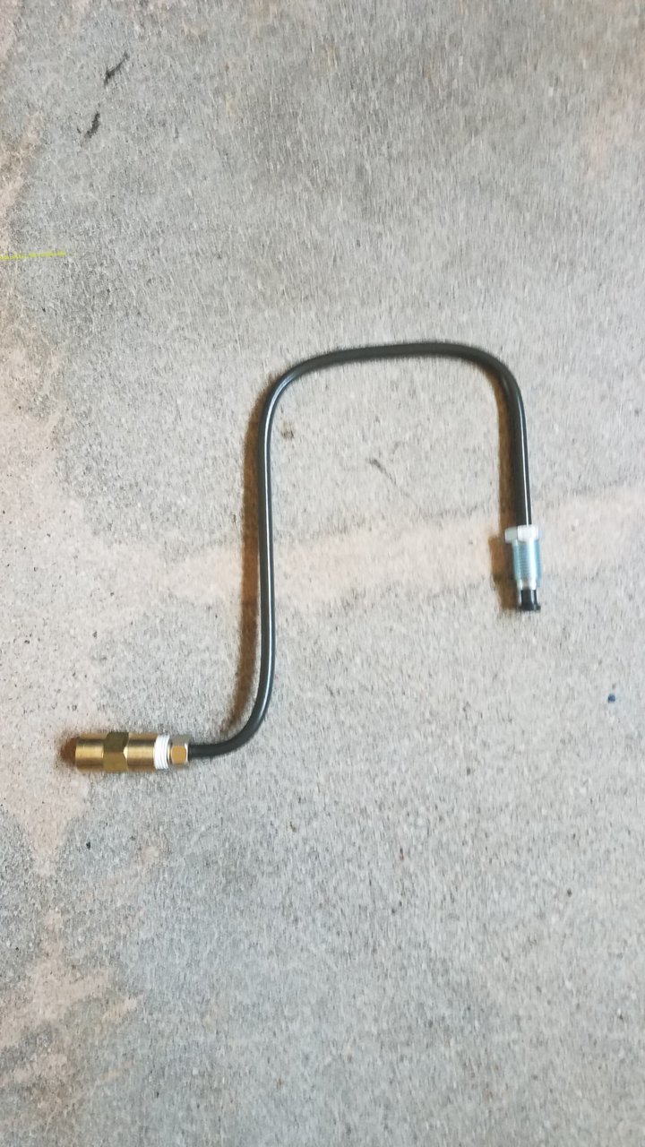

  18. Apr 24, 2020 at 1:40 PM
    TheFang
    TheFang No Big Deal
    Jul 15, 2014
    #133985
    2,643
    SoCal
    Tacoma TRD Sport
    TRD Exhaust, URD Short Shift, TRD Supercharger, Hellwig rear sway bar, TWM shift knob, limo tint, URD Y-pipe, URD LT Headers, URD Rear O2 Sim, Custom tube front and rear bumpers, LED spot pods, K&N CAI
    Anyone looking for an accumulator delete kit as made by trident904? I never installed mine as the CM TOB deletes it.
    Norton likes this.
