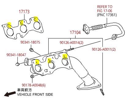

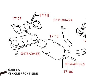

    The heads are different. He'll need to use the later exhaust manifold gaskets and hope that his manifolds cover the air injection holes.

    yes, you can use older manifolds on the newer heads but you have to use the old style gasket. I went through this considering 05-11 long tubes on my 14. The older gaskets block off the SAI holes.

    i think he could just use everything from yours. just needs some block off plates for the air injection ports. now that mine is off i assume any 05-15 motor would work in mine for example.
