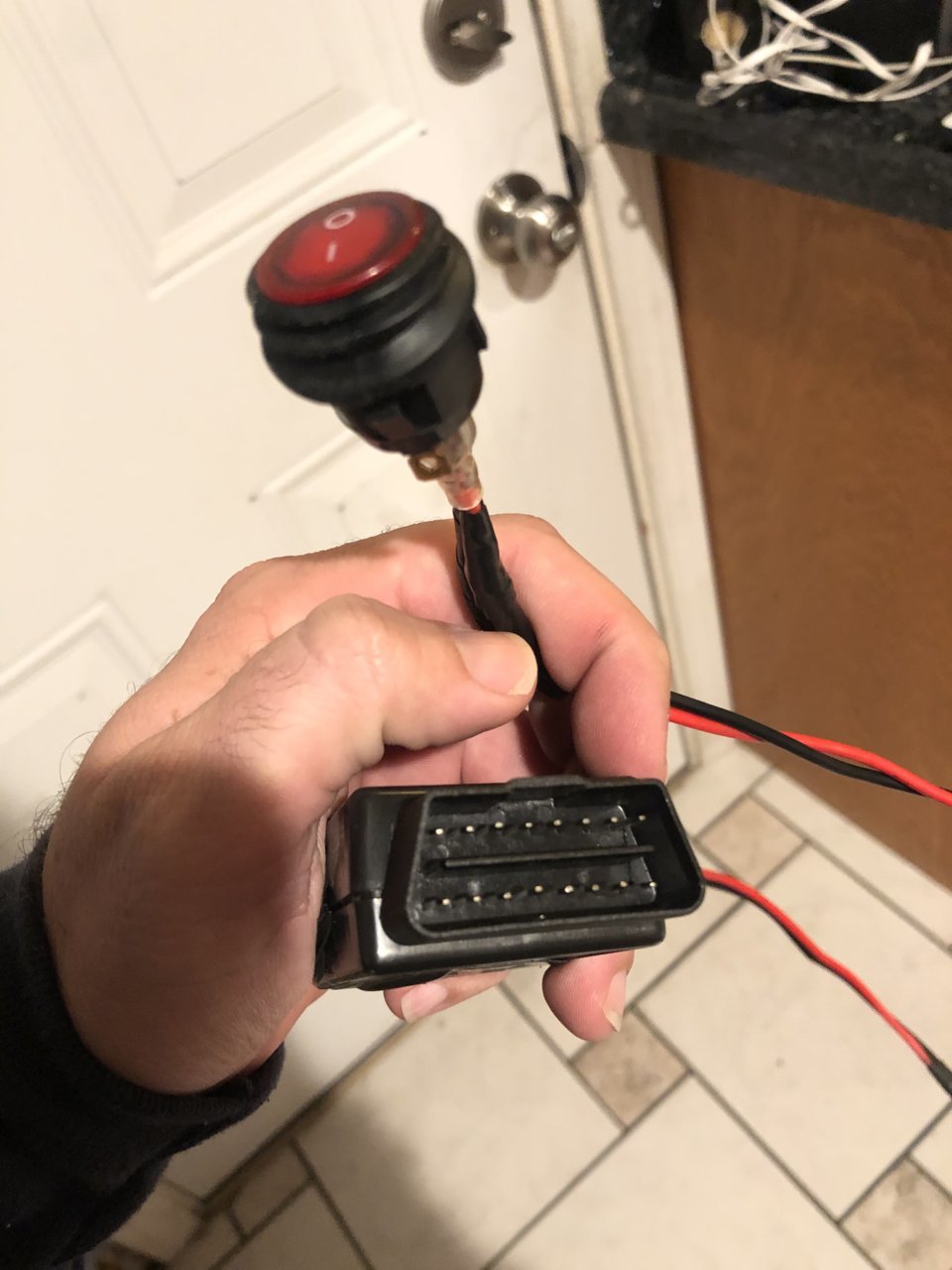

    all depends on how much adjustment was needed. I’ve had to reset the VSC a few times. I just drove with the light on for awhile. You can make yourself a switch to make it easier for future adjustments.

    what obd plug did you use? i have an ultra gauge thats kinda messed up, i could use that.

    Let me look. Actually was a blank one from eBay or Amazon. Just weld a switch onto it. I cut the switch off some light harness I had which also had the wires already. Shoulder to blank odb2 and you golden. Makes it way easier than shifting wires in and out.
