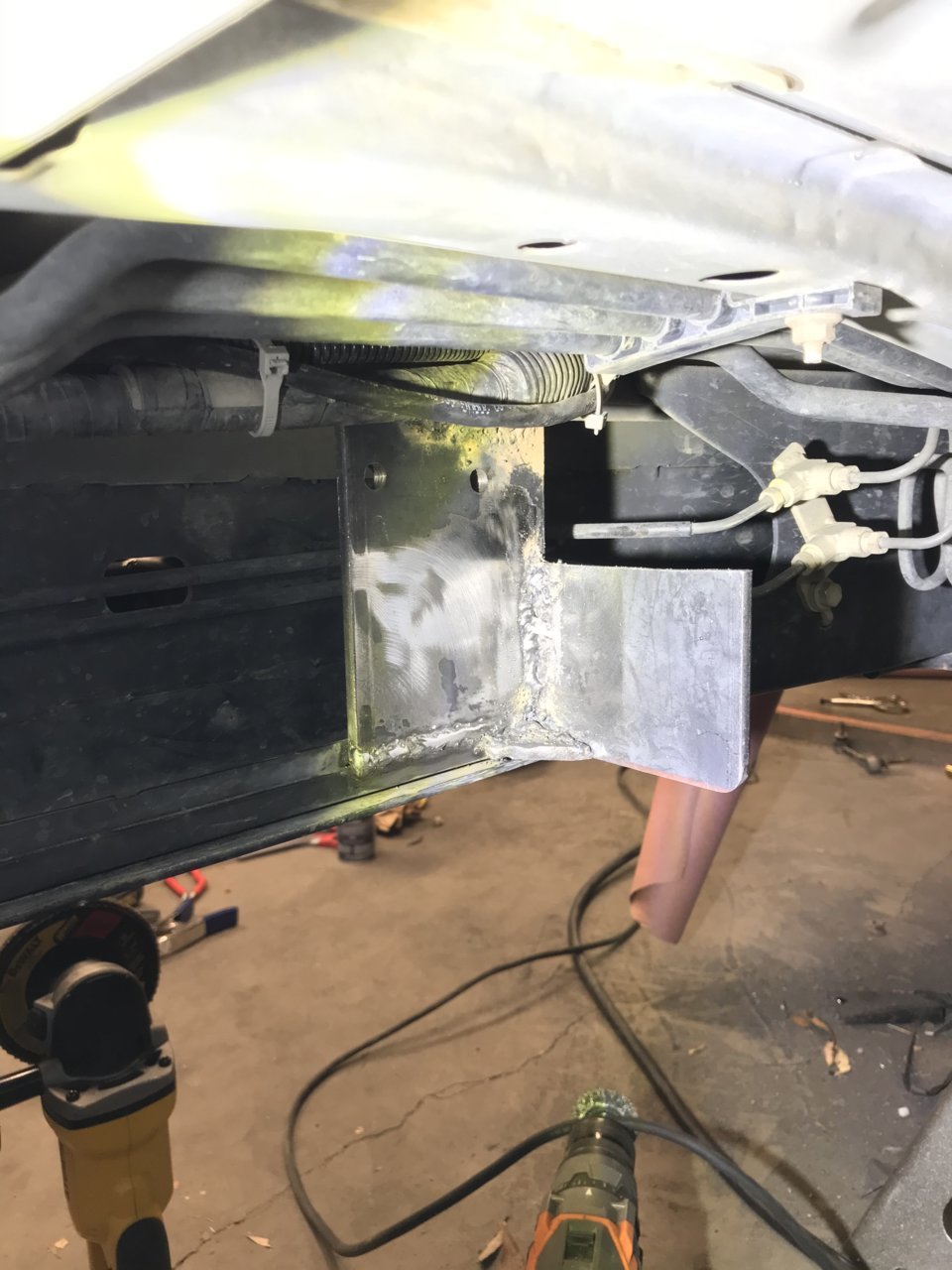

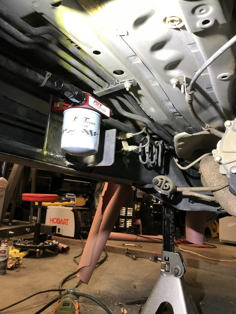

    Cuz I’m a copycat. Here’s my fuel filter. Custom welded by a welding novice.

    like the incorporated shield!
