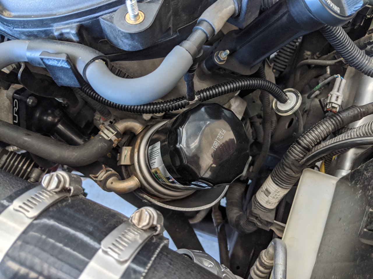

    The line running down from the clear disk filter piece goes to the BOV, for context.

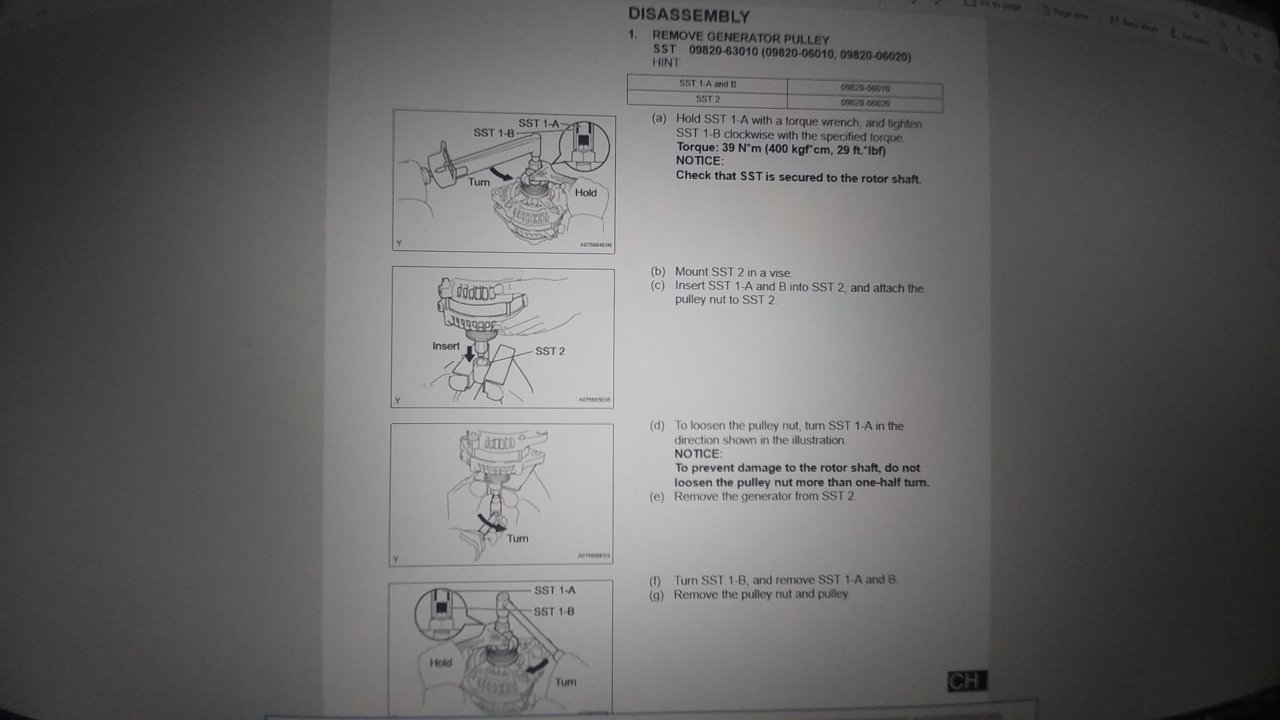

    Incase this is still needed for the alt pulley deal.

    Better quality on the alt pulley

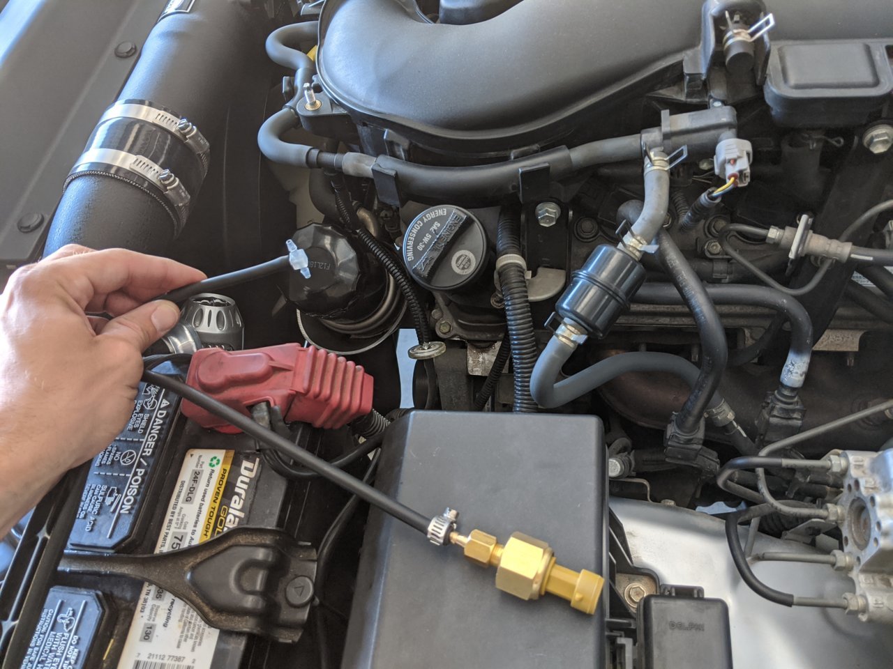

    Yes. you van just cut/ tie that "T" anywhere in the line you already have for the BOV. OR to make it cleaner. Take that sensor off and get that ~$30 coupler I linked before. The sensor is 1/8" npt and will thread right into the 3" coupler.
    Less money. Less wait time. CUT THE LINE ANYWHERE>
    Cleaner looks the best. Get the coupler/
  10. Apr 25, 2020 at 6:16 PM
    Flake Boost
    Flake Boost FORCED
    Mar 18, 2020
    #322445
    207

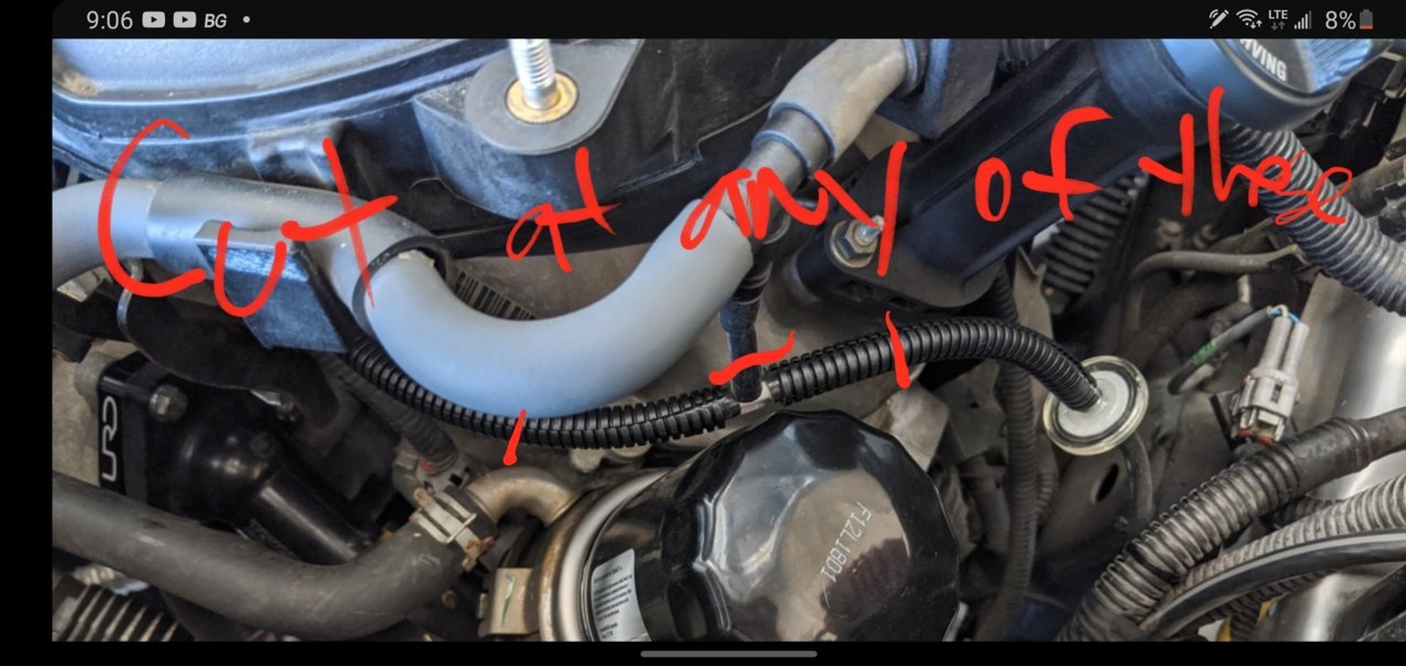

    @Sirnick88 You can go either route here. 2 places you can replace the 3" coupler with the 3"with 1/8" bung or just cut in to that 1/8" vacuum line going to the BOV
    If you use the coupler. Unscrew the nipple off the sensor and discard that, the line, and the "T"- Then screw the sensor into the coupler. It is cleaner this way. The sensor isn't flopping around. Or zip tied to something. Not that critical. Just a thought.

    It it a T tap. It's the same diameter as the BOV T. It will work on any of that line where I made my marks in the pics above.

    @Flake Boost thanks man, the visual aids really help. @12TRDTacoma this is the URD mk3 setup, so it'll be different than the TRD s/c setup.

    @12TRDTacoma sorry, I didn't fully answer your question. This is the aem x series boost gauge. Electrical connector to brass fitting to vaccum line.

    @12TRDTacoma no worries man, I'll go with @Flake Boost 's recommendation using my existing hardware, and upgrade to that sick red coupler later.

    If you are going to put that coupler on later. Then cut the shortest line coming off of that large T splitting to the BOF and recirculating line. Doing that. You wont have to shorten and replace any of the other lines IF you go with the 3" with 1/8" coupler.

    Alt pulley was actually real easy to remove with a small impact. Just hold pulley then torque off.
