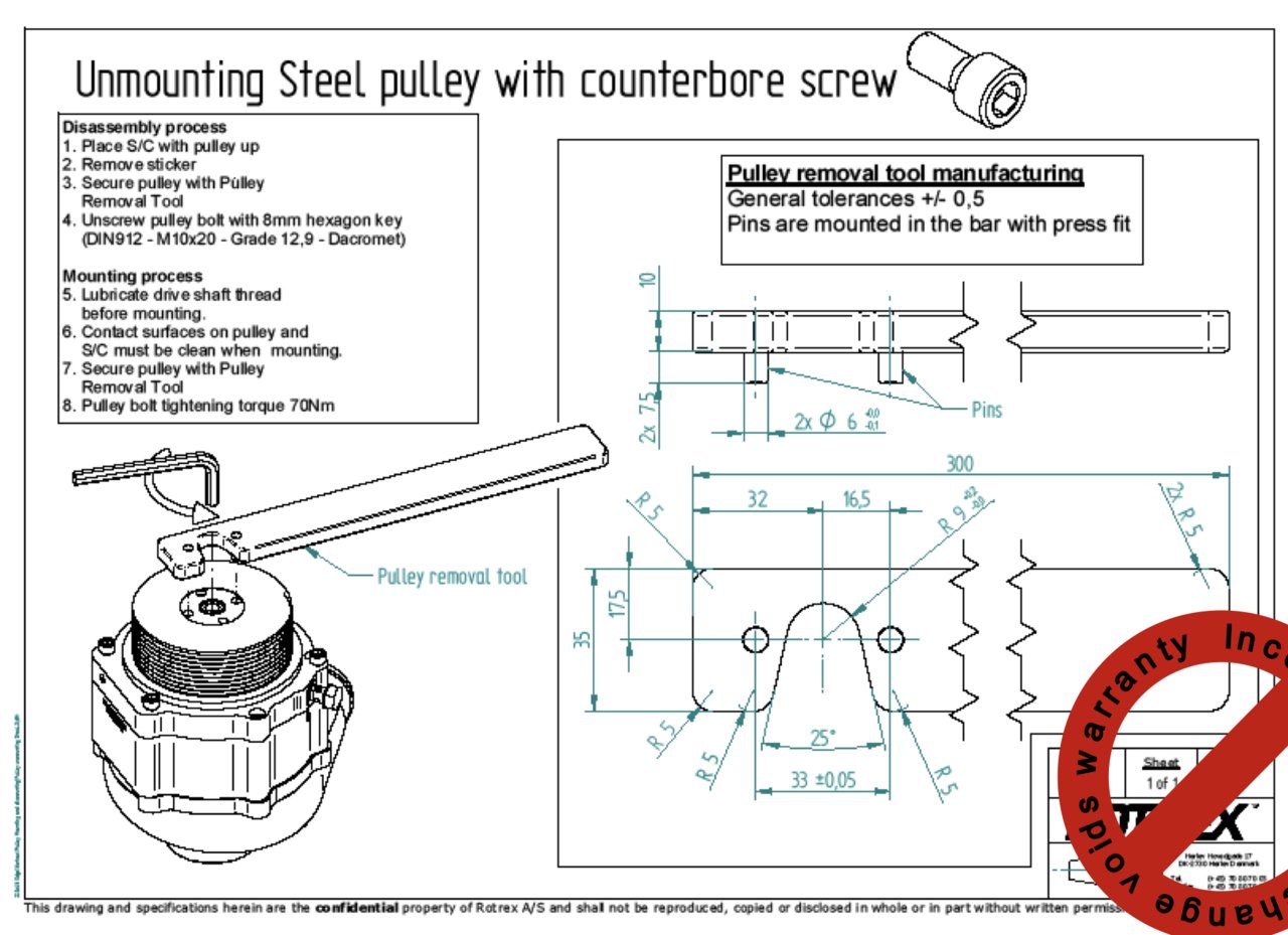

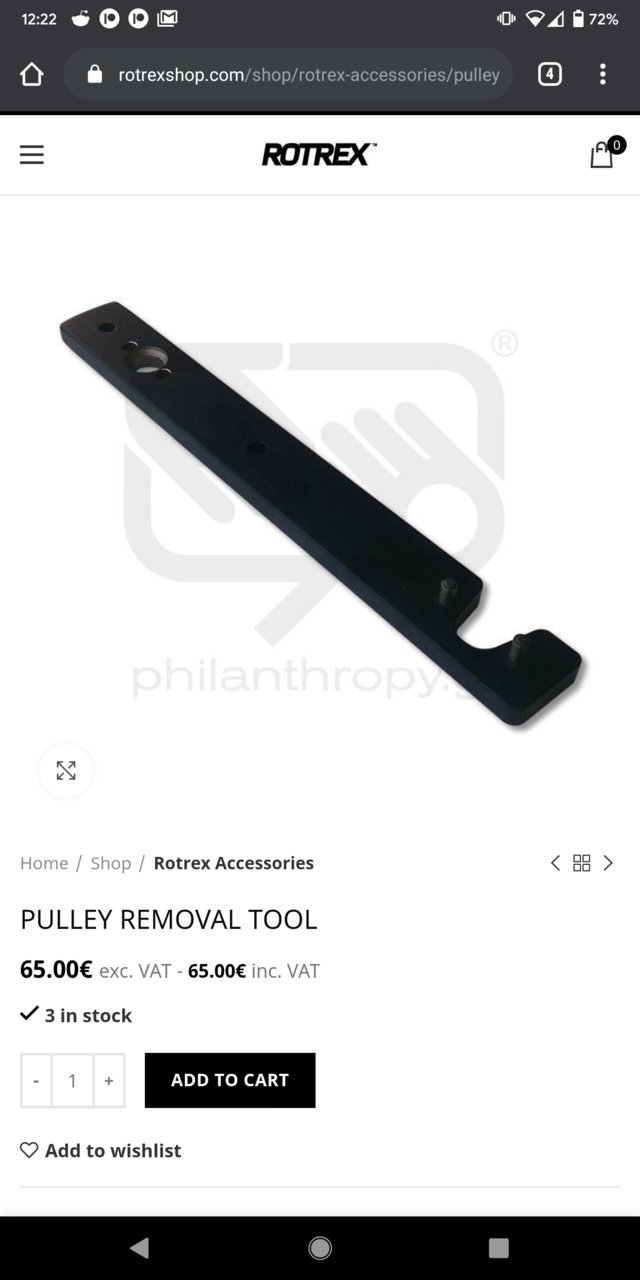

    @Flake Boost @Sirnick88 Do yall know where I might be able to find a pulley removal tool that works with the Rotrex pulleys by chance? I am thinking about changing pulleys and am trying to figure out if any old pulley change tool will work or if I need to get one from rotrex

    I would imagine URD has them. Page 30 shows it. https://rotrex.com/wp-content/uploads/2018/12/Rotrex-Technical-Handbook.pdf
    I would use a belt wrench/ something to hold the exterior pulley itself

    Thats the one. I didn't link it due to it being in a currency not USD. Probably shipping from overseas.

    Yes, that's the one I was looking at, but wasn't sure if it was specific for their pulleys or if i'd be able to find an alternate one that'd work

    could probably make one with some flat bar and bolts.

    Didn't need a tool, when I pulled my friend's. A simple strap wrench perhaps? Been a while.

    Good thinking, I will give this a go. I definitely have stuff to make this laying around:thumbsup:
    Yeah I have a strap wrench, I just wasn't sure how good it would work. I am kinda worried about having the pulley spin backwards on me and cause other problems since I'm trying to do it myself. May just have to wait and get someone to lend me a hand. Finally got the truck running right after fixing some exhaust components this weekend. I believe a small exhaust leak before the upstream o2 was causing some pinging under high loads. Truck is driving stellar for the first time in 5 months:taco:
