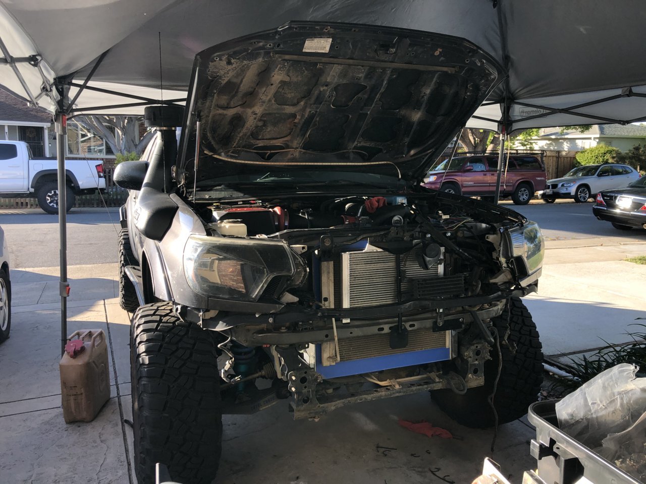

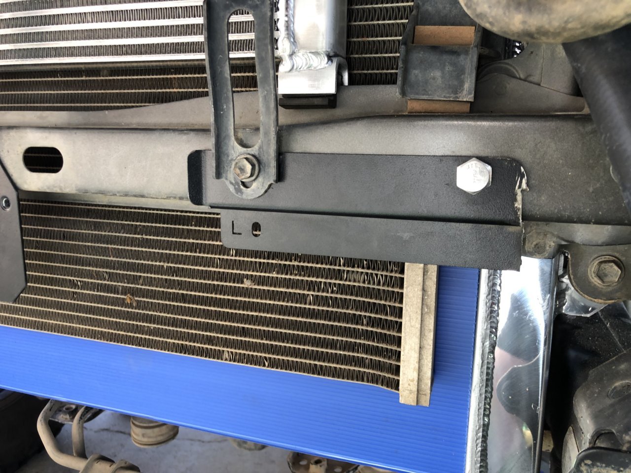

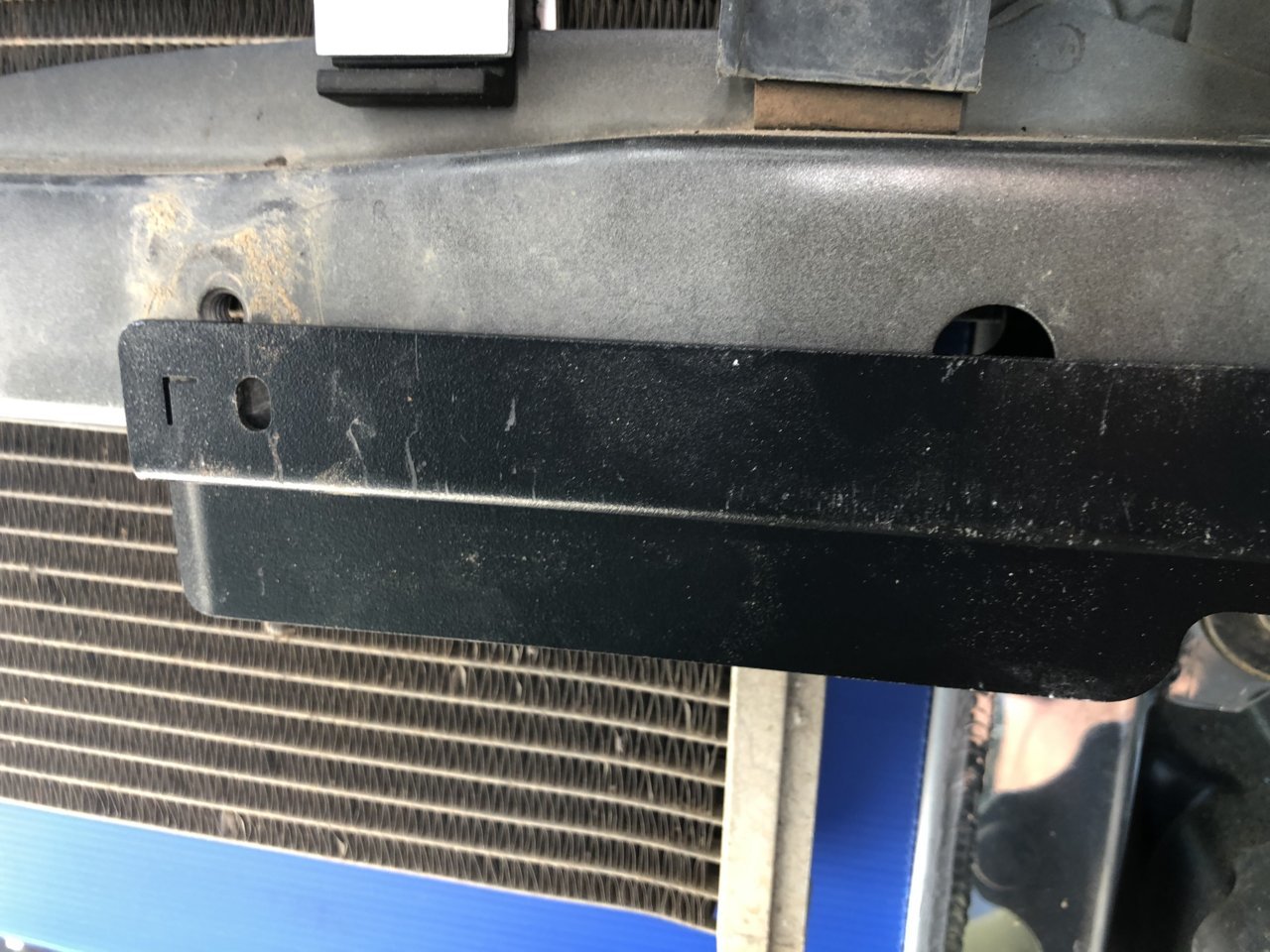

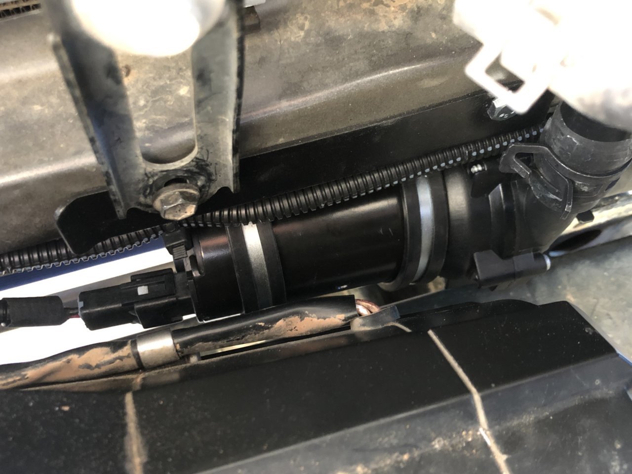

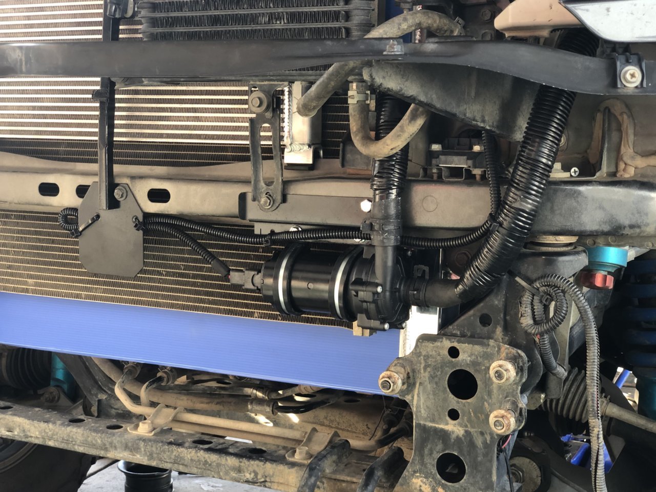

    Adding on another relocate job. @Toynado had some random part. we had no idea what it was from but posed a nice option for the relocate. Did some test fits then cleaned it up and painted it. perfect clearance behind a warm 12k winch and Pelfrey bumper.
