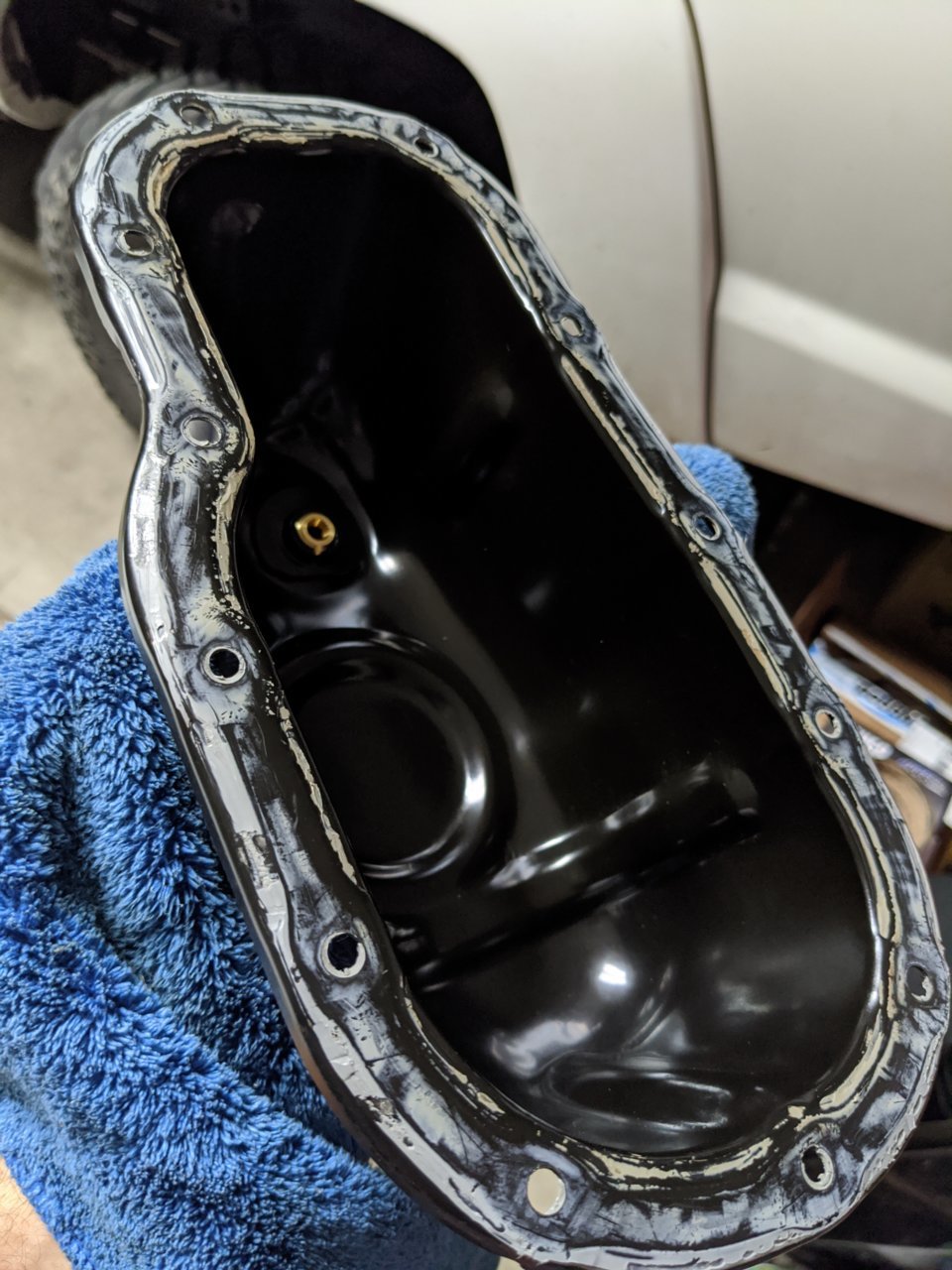

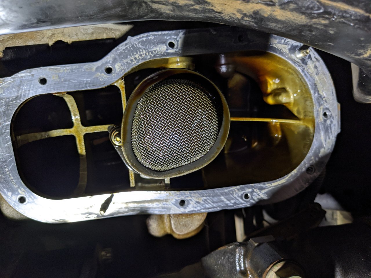

    I'll have to rent that from someone later for peace of mind. I'm hoping this will do for now. Just hit it with my impact and gave it all it could. I'm heading out of town for the weekend so I'll check it now and then. Trying to finish up everything by Saturday morning.. got the oil drained, oil pan pulled, cleaned up both faces.. but wondering what you guys think. This good enough? Have any tips for the sealing process? I'm going to grab some alcohol tomorrow at work and do a final prep/wipe down.

    So why did you pull the oil pan?

    > BUILD LINKS >
    Had a gnarly leak.. was seeping from the seal.

    > BUILD LINKS >
    I figured I'd knock that out too while I was in and under the truck. It's been slowly getting worse.. I stretched it out long as I could. Lol

    Just a nice bead of RTV and you'll be good to go. Let it dry for an hour or so from the moment you you put it on, then you can fill it with oil and back to action!

    as long as you get a nice bead and then hand tighten the pan on to let it sit for about an hour. Then, torque it down, or just tighten it with tools. Point is, give it some time to coagulate where it needs to be thick instead of just smashing it on and you get a paper thin seal of RTV inside and big booger all the way around it.

    :thumbsup: THAT'S what I was curious about. I was thinking I should do the same, because it did look like that's what happened previously. It didn't set long enough and squished it all out to the inside. Had a lot to scrape off. I wasn't sure if if should let it set, then install, or do what you suggested. Thank you.
