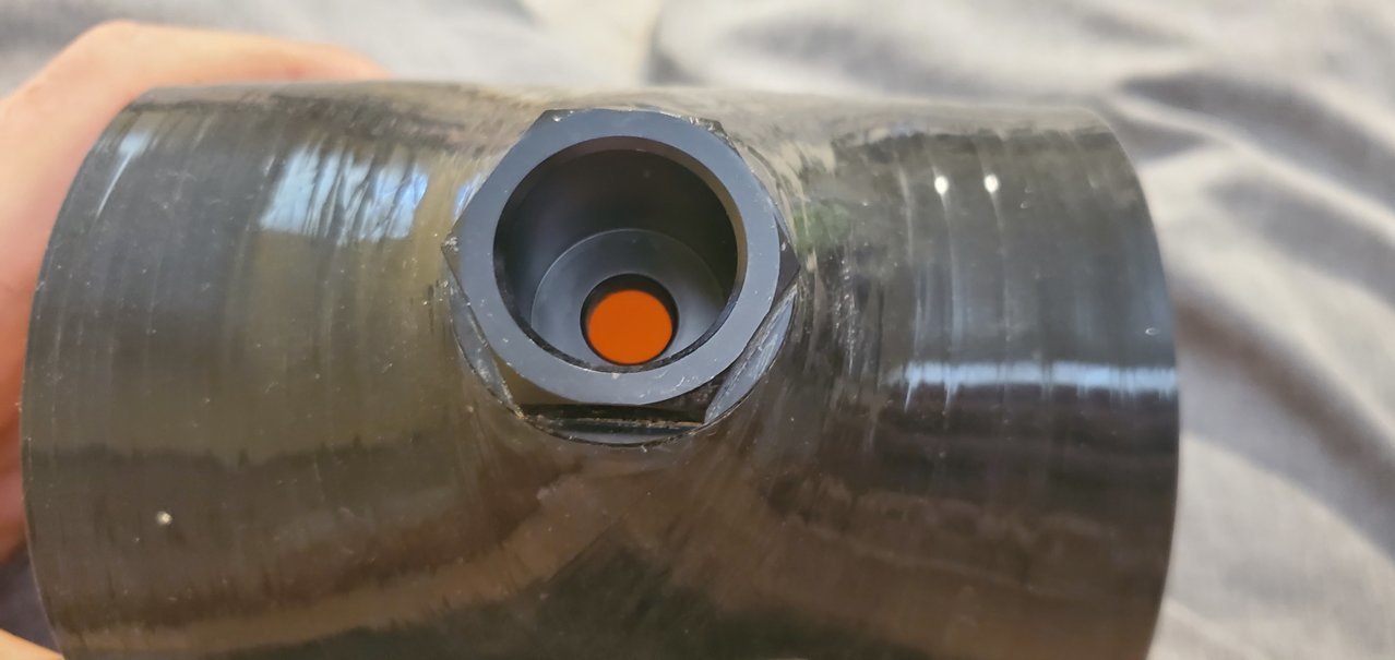

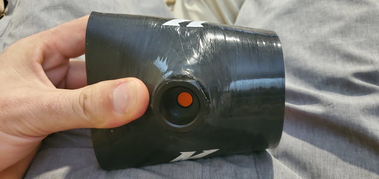

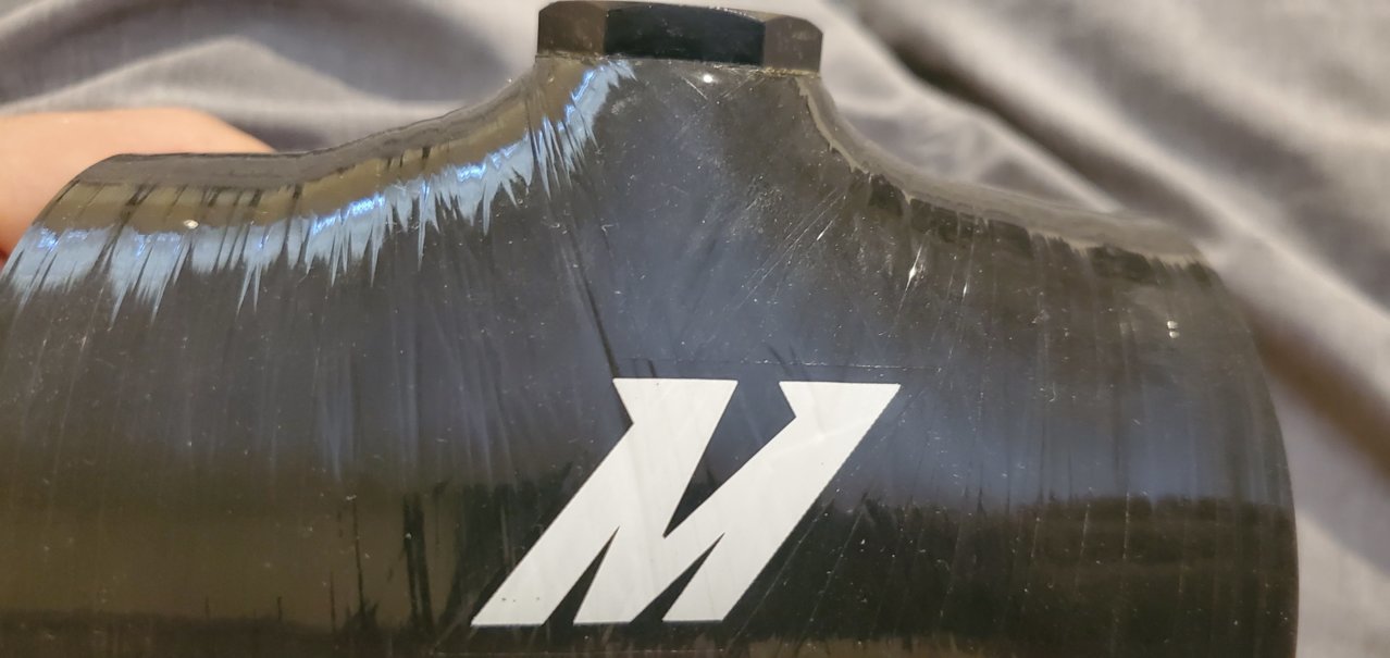

    Fyi if anyone was curious what this looked like. Recessed 1/8" threading and protects the sensor.
    - Depth of 1/8" threads
    4.00mm or 0.157" or 5/32"
    -Depth of the orifice before the 1/8" hole is
    20.35mm or 0.800" or 103/128"
    - opening width is
    20.91mm or 0.823" or 105/128"
    -Exterior dimensions on the 'nut' are
    1-1/8" or 28.52mm or 1.23" .
    With it being as deep as it is, gets the sensor right in the stream. Air /intake temp, or boost before the throttle body ( vacuum will not be accurate. Surge will though) .
    Some mentioned in reviews elsewhere the fitting was plastic. On the contrary, it is anodized aluminum. The bulge is quite substantial. Leaves you with a little over an inch of usable clamping space. "M" logo is on both sides.
    https://www.amazon.com/gp/product/B00860E43A/

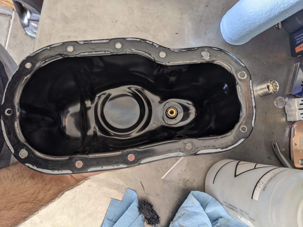

    What do you guys think? Good enough?
    I gotta clean up the block side a bit now, then ready for rtv.

    Looks good enough to me. Rub some isopropyl alcohol or acetone around the lip to help dissolve anything that may still be on there. Same thing on the engine. Then bead on.
    It was fairly nerve wracking when I replaced the oil pan on my 2010, but I cleaned the hell out of everything and I think that helped ensure a proper seal.
    There is a post somewhere that has a pretty good picture of how the bead should applied.

    Yessir. Snagged some IPA on my way out of work. Both are cleaned pretty damn good. And wiped down with IPA. Should be ready to go.

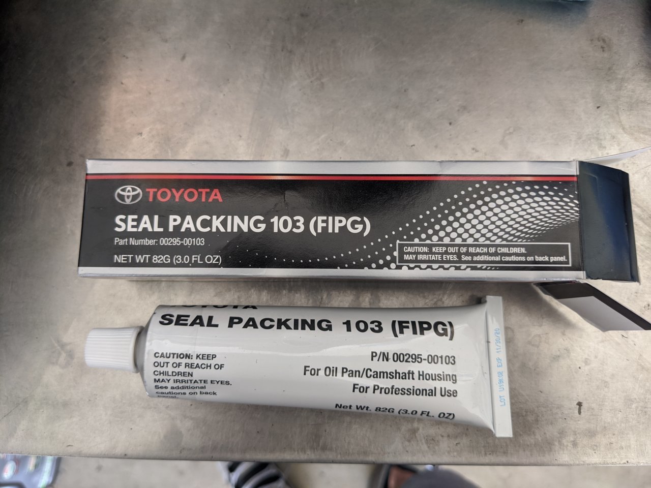

    Found this on TW..

    It’s best to squeeze it out and leave it in a cylindrical shape. Flattening it out like that prevents it from performing its main task, forming in place. Hence the name F.I.P.G. Maker. If I recall correctly, I believe the box also has the F.I.P.G. Printed right on it.
