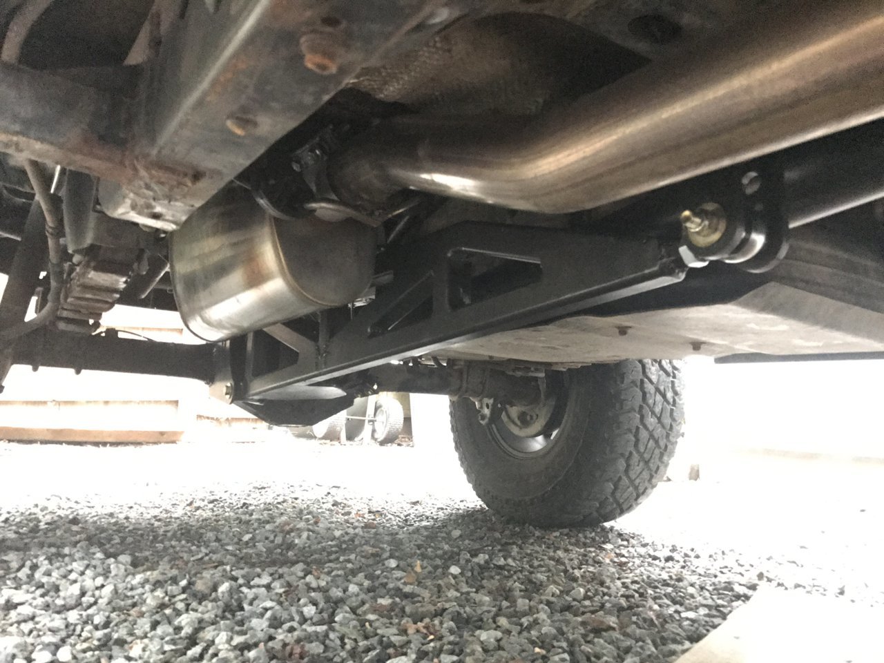

    That’s a point of contention...
    In the middle? A little.
    At the rear where it’s most likely to be hit? I gained clearance. The slip joint on my one piece is in the rear. It’s a smaller diameter than the tube.
    I also have a custom made, by @stairgod , traction bar. It helps with axle wrap, and more importantly, protects the DS on ledges. It’s saved me a $200 re-tube multiple times at this point. Especially in Moab.

    OOO, group buy on the traction bar! Kinda like a panhard rod...

    Lol! Jon says he’s not making any more. I got the last one :cool:
    It is pretty cool though. The mount is welded to the axle tube, instead of being bolted to the third studs.
    The way we wheel, I’d always be worried about the bolt in one.
