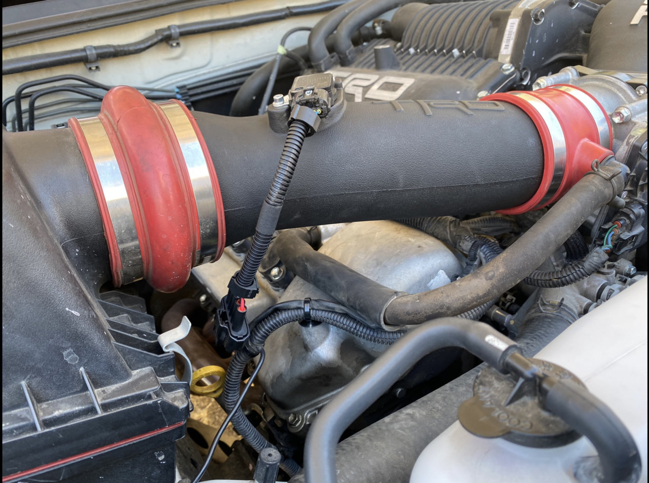

    I don’t have the smog pump relocation bracket anyway but I did want to test fit it and see if I am going to have to trim the tube. My afe intake barely fit on my truck. I installed one on a 2011 supercharged truck and it fit fine..

    No trimming required

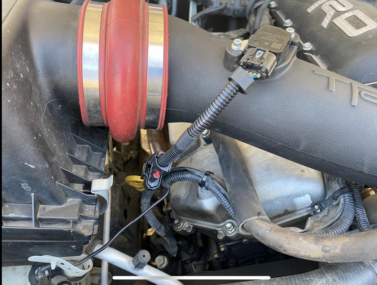

    I had to trim mine. Same with the Tacoma specific one that I’d had on there previously. Otherwise the tube distorts the flexible boot too much at the air box end. Especially if you have any kind of throttle body spacer. Test fit and see. The boot at the throttle body is tapered inside. If you jam it in there too far you’ll be into that taper and distorting that boot.

    Ah I have no spacer of any kind so that’s prob why. A spacer would make sense for the folks that have a larger TB on.

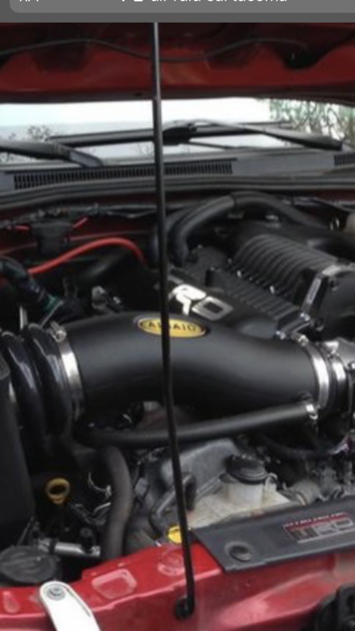

    So does the MAF sensor on a 4Runner have a bigger table for tuning? I’m having a hard time believing that TRD 4Runner stock filter has more MAF than something like an AFE Pro5r.

    Larger tube means more airflow through the tube for the same voltage on the MAF (higher airflow). I can't speak on whether or not the 4Runner has increased resolution in their MAF calibration (more break points), but the 4Runner tube will flow more air for the same MAF voltage. That I can say for FACT.
    I don't think it's necessarily a comparison of which filter or intake (pre MAF) flows more.

    The air raid has a very large intake tube. It did not sell very well because of lean issues. But now that we have access to tuning...

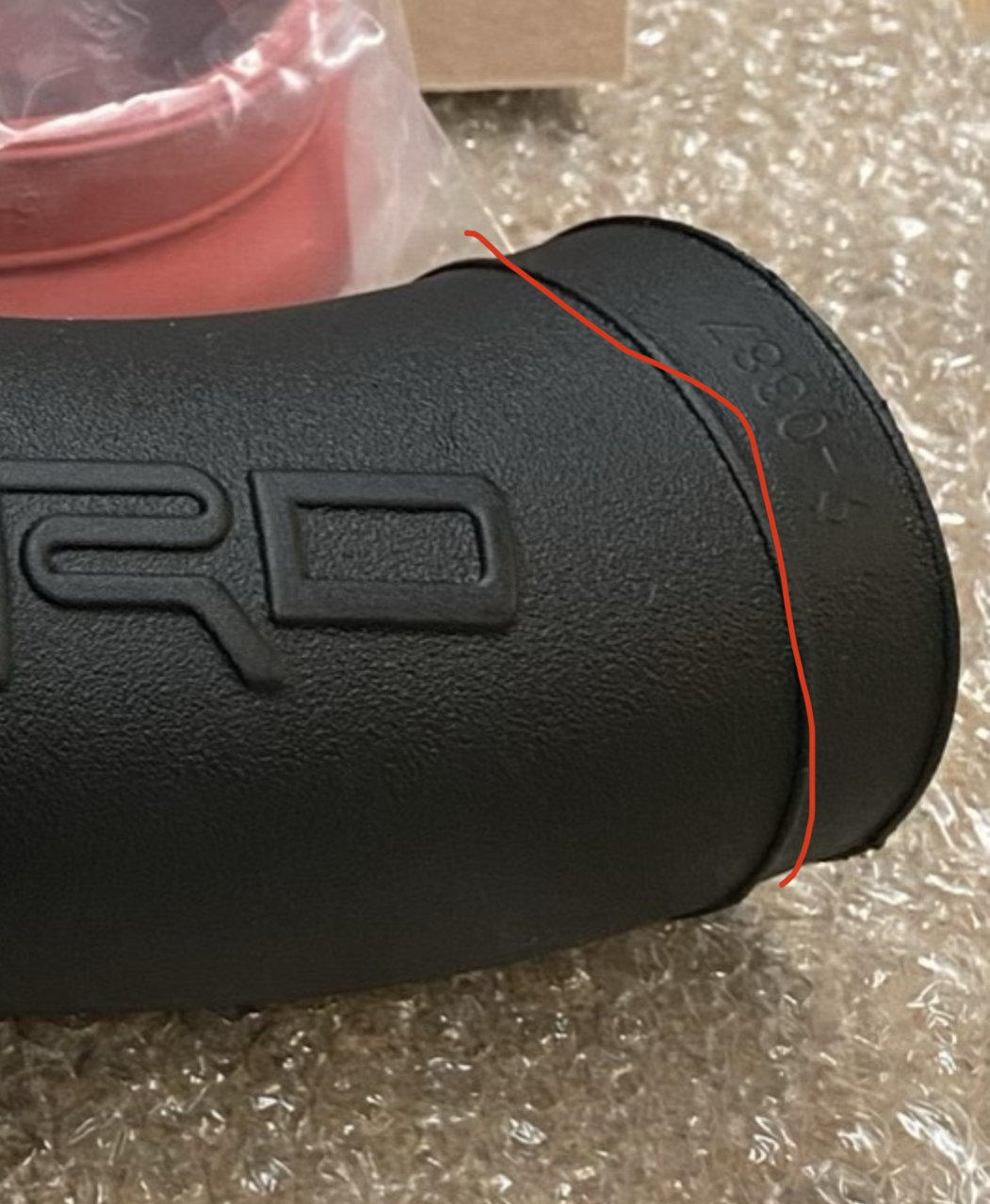

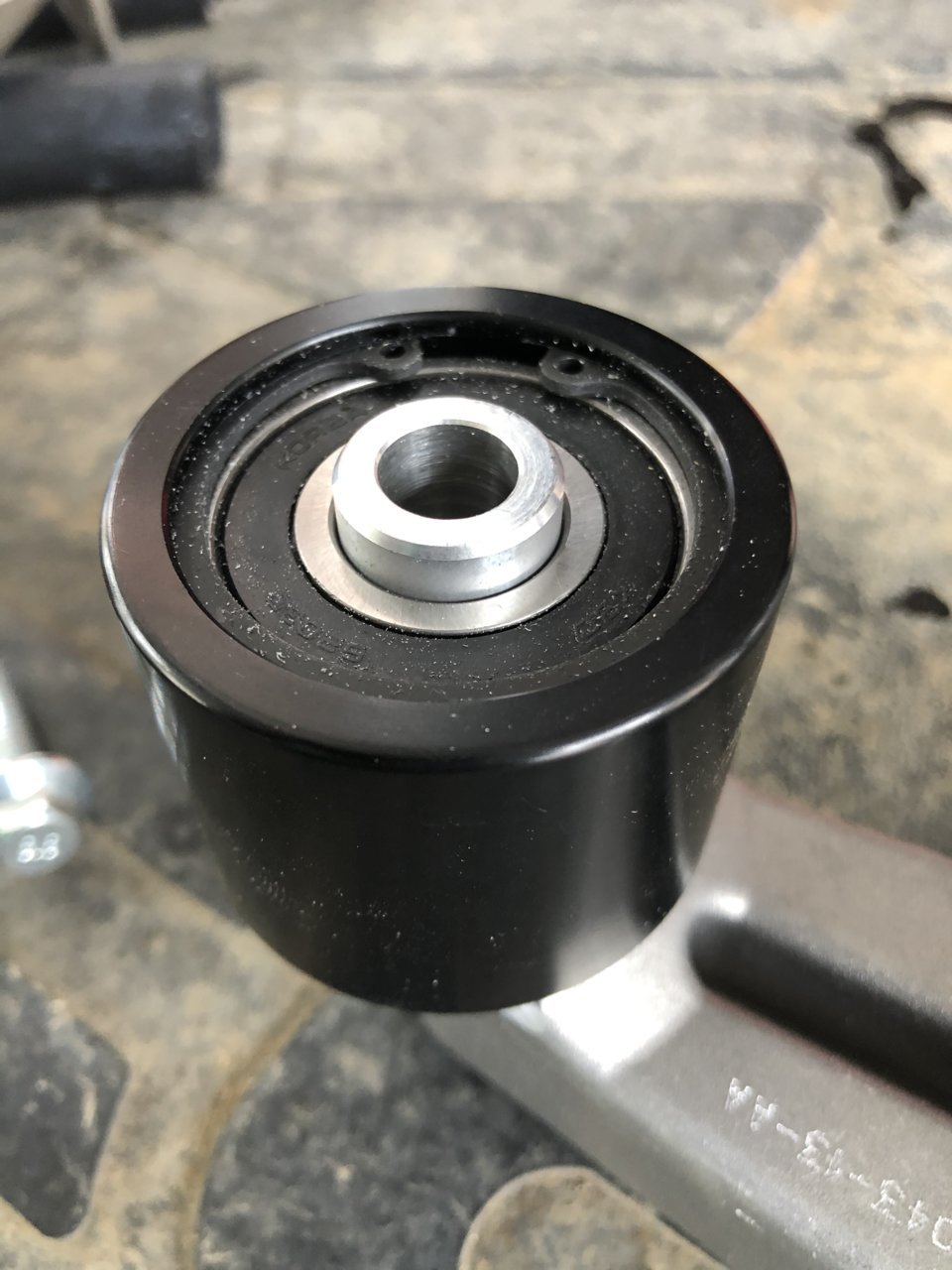

    Trimmed down my Rousch today. What did you guys do about the extra length when using the double roller for the inner sleeve. I can’t recall if it was cut it or find a new one.

    Take a sharpie and draw it along the line where the excess sticks out. I instructed @White lightning boosted or @Murphinator on that recently if I remember right. With the excess which needs to be cut you could take a grinder, but to make the cut precise I used a pipe cutter to make the cut precise. You will be cutting a long time though.

    Makes sense. No pipe cutter so will go at it with the grinder. Im fairly good with it. A washer should help if it’s slightly short.
