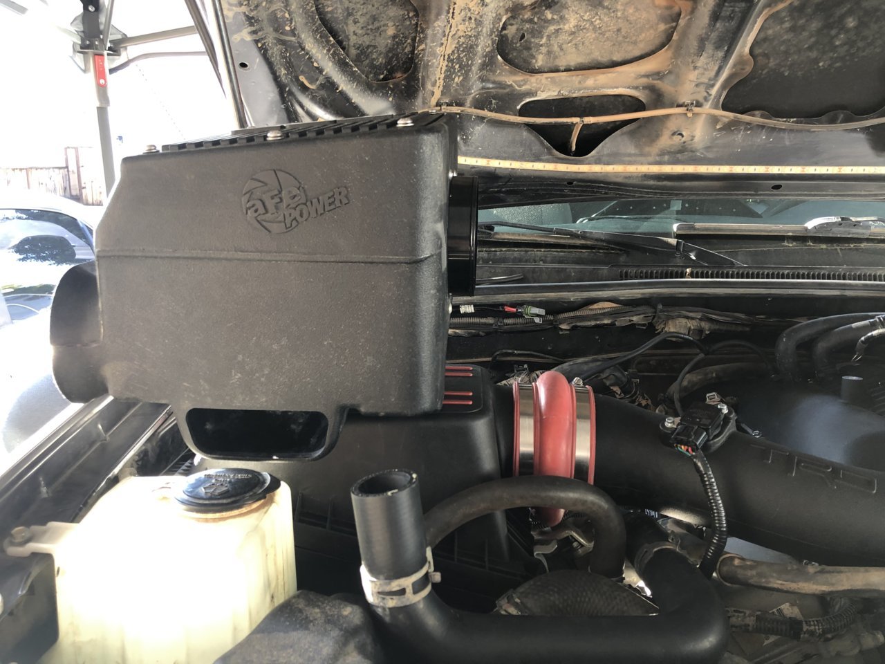

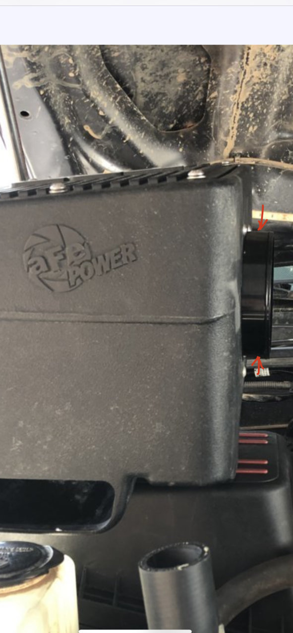

    Here’s an AFE on top of that TRD box. It’s a good 1.5–2” shorter. The opening is also lower but that shouldn’t be an issue, might actually make up for some of the shortage.
    update: looking at it again I did not factor in where it actually sits in the coupler. Might be 2-3". Nothing a nice silicone one couldn't solve.

    I forgot to grab the tube for the AFE but its def longer and skinnier. But not to say it would not work.

    What’s the O.D Here on that AFE box ?

    4 1/8"

    What’s that, like 105mm. Dang close.

    The TRD one is 4.25"
    The couplers you get for the TRD intake would work just fine for the AFe version.
    Unless there is something here I missed.
