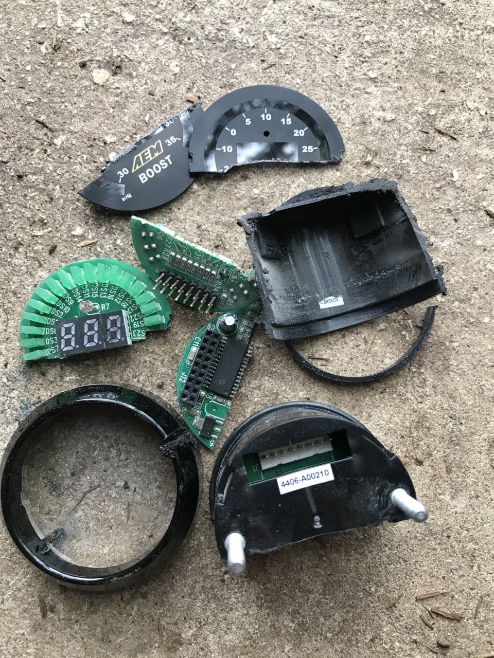

    Full-time AWD & BorgWarner EFR 6258
    Cut my boost gauge in half tonight so they'd send me a replacement. Figured someone in here might find the internals interesting!DC01D467-09DA-477F-BC1E-A095B4E991C0.jpg
