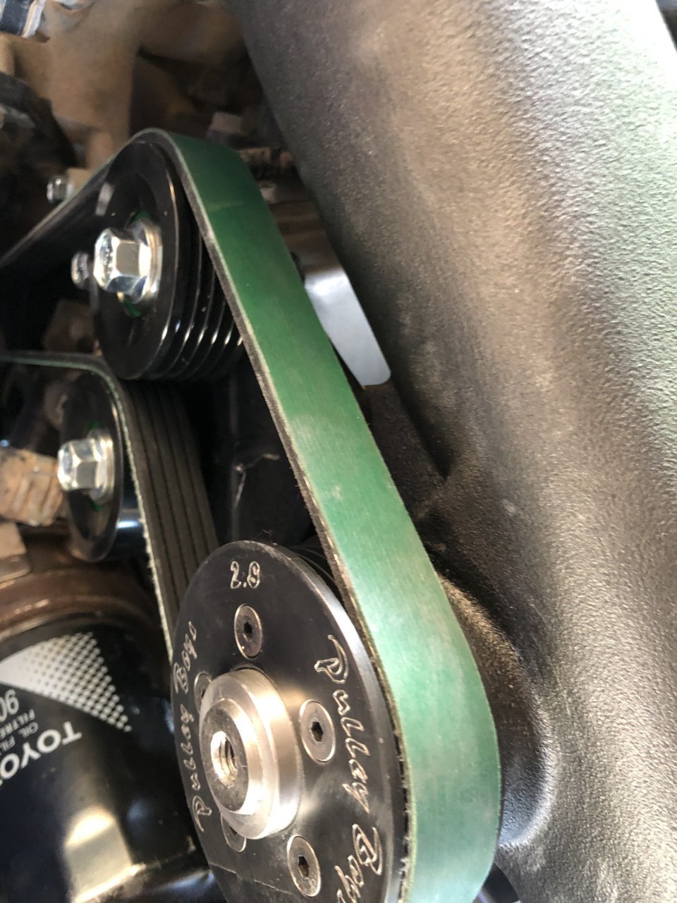

    How much margin of error do I have here. Pressed it on close to another 1/8. Just shy of it. I could go a little more. Still a tad left behind the hub.
    I had a straight bar on SC to the pulley to the left and seems like it’s a lot more so still. Doesn't t seem right. Maybe I’m checking in that wrong place.
    Seems to line up nicer than before.
    Props to @JustDSM for lining up with an initial tune with all the extra mods. Still needs work but it will be drivable

    looks good to me. Once I fire it up, I look down the belt to see any flex or deformation pulled offline.
    In retrospect, I may not be the best person to give belt advice.

    you and your belts!
    Yah figure check is it looks and see if it’s smooth and hope that shit doesn’t break.

    It looks pretty good actually. I would let it idle in park and then in drive. No noises? Cool. Belt look like it's riding nice while idling? Yes? Cool. Enjoy the new setup.

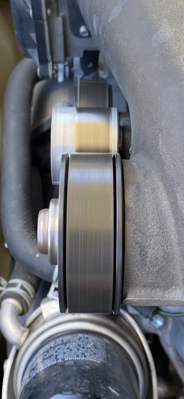

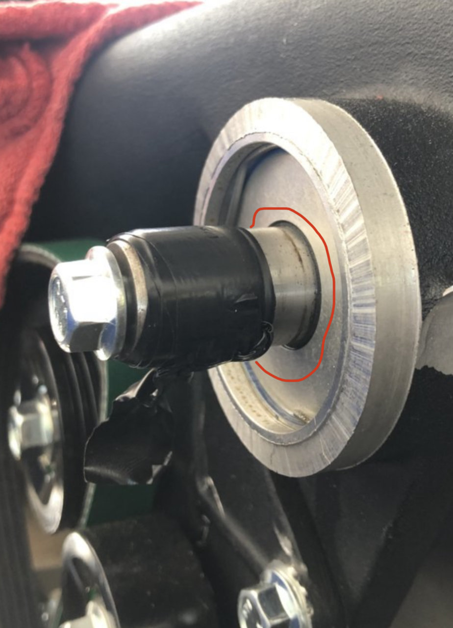

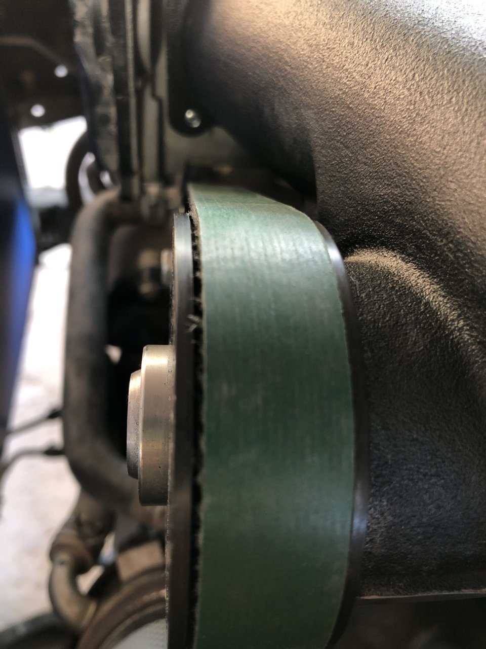

    Here’s mine. This pic was taken with the engine running. Looks like you have a ways to go still to get it lined up well. Remember though, don’t let that hub contact that bearing retaining washer behind there.

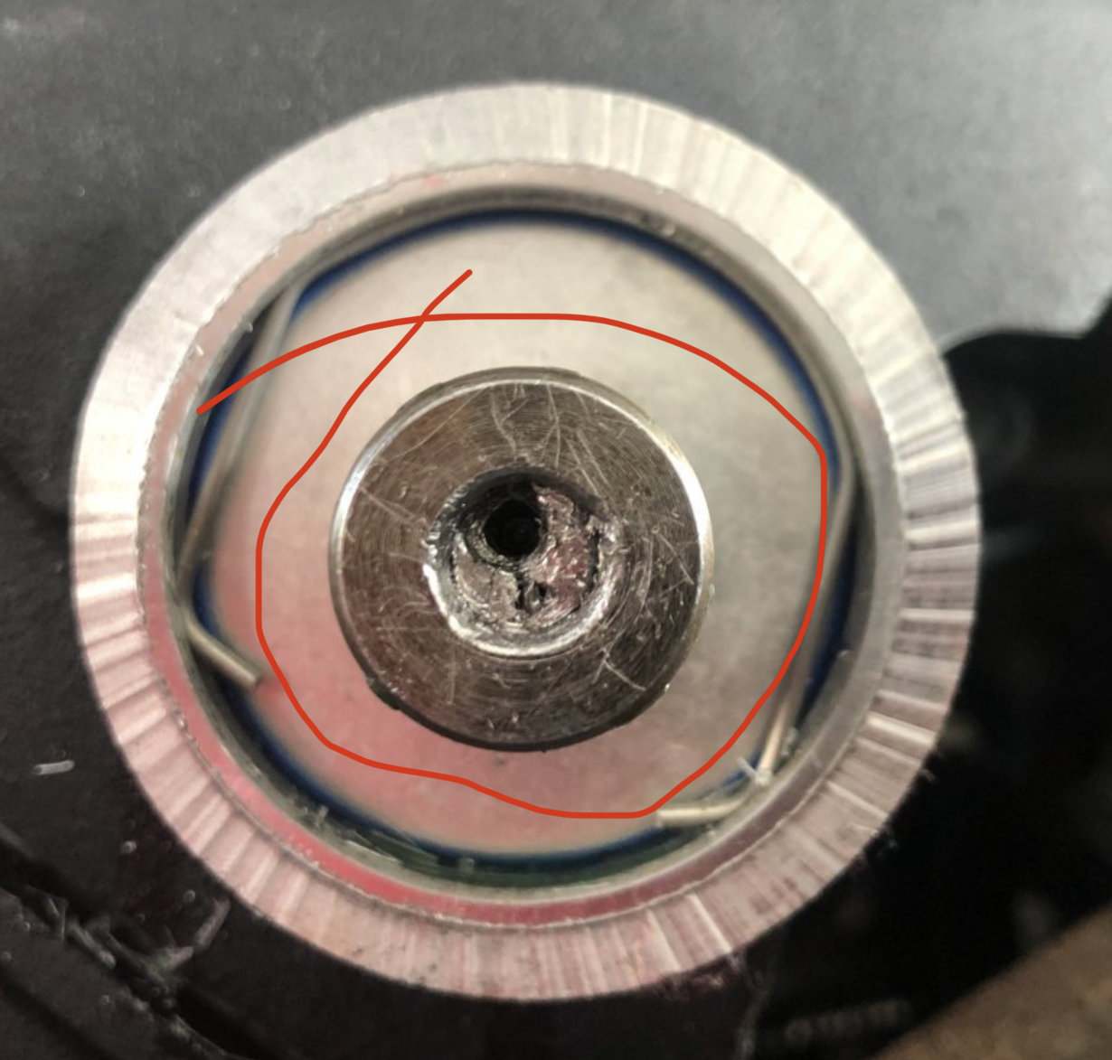

    This washer. No touchie!
