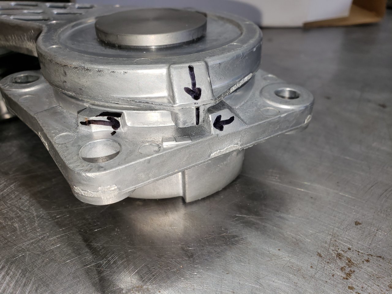

    Hey guys I really need your help. I just snapped the 3rd tensioner pulley on the magnuson supercharger. I only have about 35 thousand miles on the supercharger. What could be causing this to happen so often. I know the tensioner is built kinda weak, but this is getting expensive replacing this part. I do have urd 2.8 pulley with smaller gates belt. Any suggestions would be appreciated. I think I'm going to purchase the beefier one this time around. Thanks

    There was a lot of talk on some of the newer tensioners that would appear to be showing signs of casting failures. The failures can also be caused by too short of belt. Might want to post up a part number. With the 2.8" pulley, I just ran a stock belt length (gatorback).

    K080702HD this is the belt I used from gates.

    I’m running a 2.85 stealth on the stock belt. I think you may be using a belt that is too short. You may also want to look into getting the upgraded rousch tensioner. It’s on the first post of thid thread if you wanna get that one. Its much stronger but if your belt is too short you may start shredding that instead of the tensioner

    You are most likely snapping the tensioner due to the tensioner being out of it's normal range with the shorter belt. Something is going to give in this situation and for you it seems the tensioner is the victim.
    I'd get a Rouch tensioner anyway (what I use) since you need to replace anyway and make sure after install whatever belt you choose keeps the tensioner in approx the middle of its range.
    Check this after installing belt and turning engine over to seat the belt.
    This is uninstalled so no tension. When you use your breaker bar to get the belt on this should be approx in the middle.

    ok thank you guys, I will purchase the steeda tensioner. I swap the pulley onto the steeda correct.

    or the Roush and the 50mm double roller! This is what most people use on here. No experience with the Steeda but the Roush gets a ton of praise.
    Either one you can swap the stock pulley onto it.

    No issues running the Roush tensioner and double roller here on a smaller belt @Tennessee98
