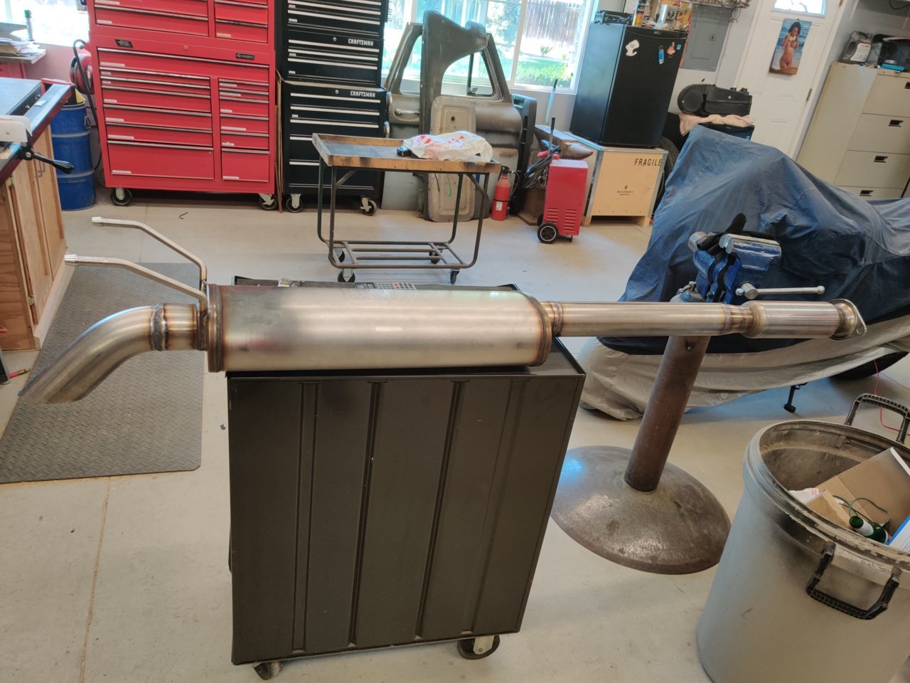

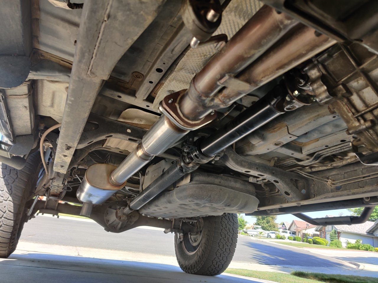

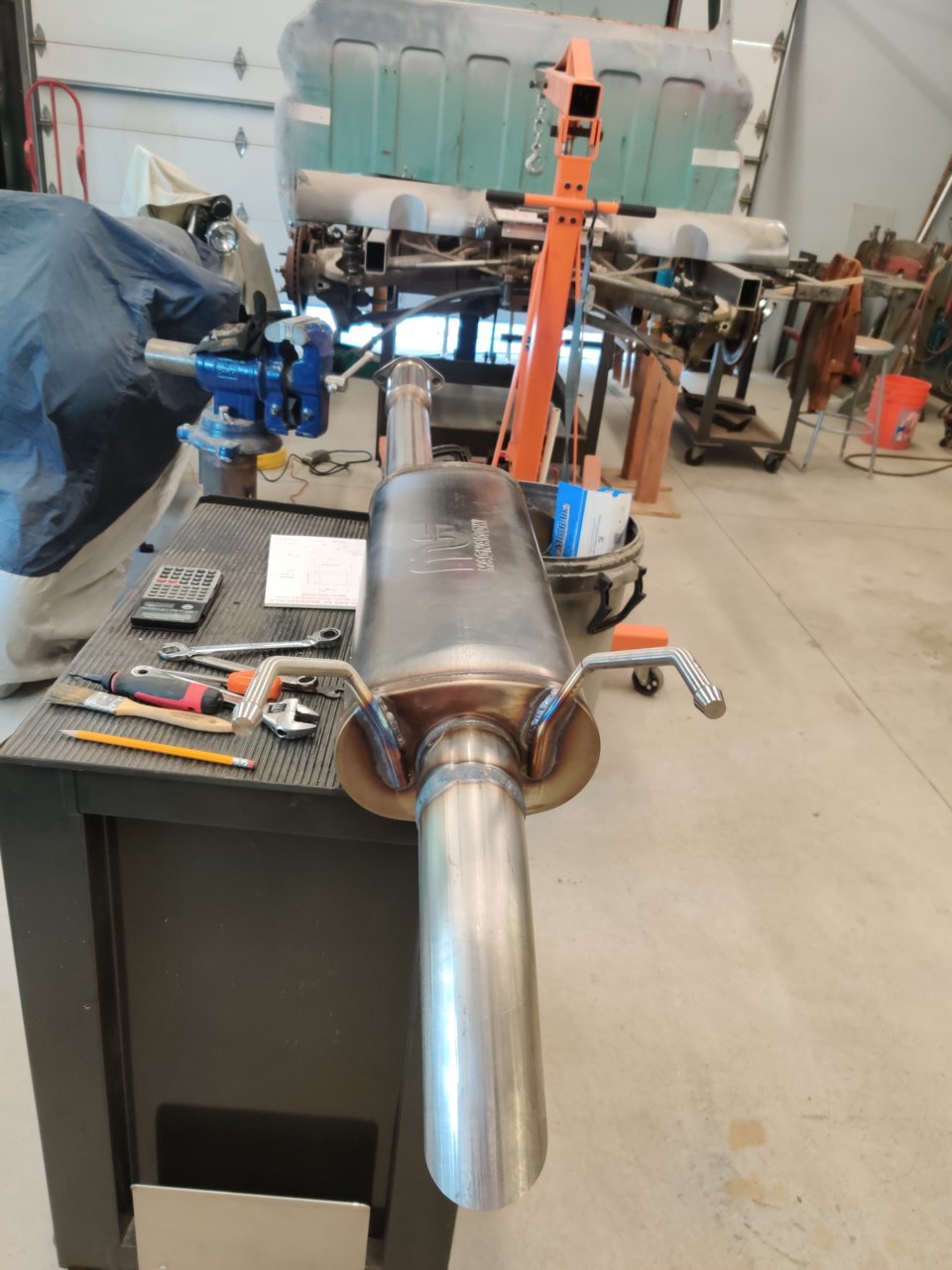

    I just put a new exhaust on my truck with the help of a friend that can weld. 2.5" factory style flange at the y-pipe to 2.5" resonator that's 10" long that has an adapter to 3" pipe to a 8x5 muffler and a turndown. It's loader than I wanted, but no drown and throttle response is smoother.
    It's amazing how a 2.5 exhaust with a chambered muffler choked down the engine.
