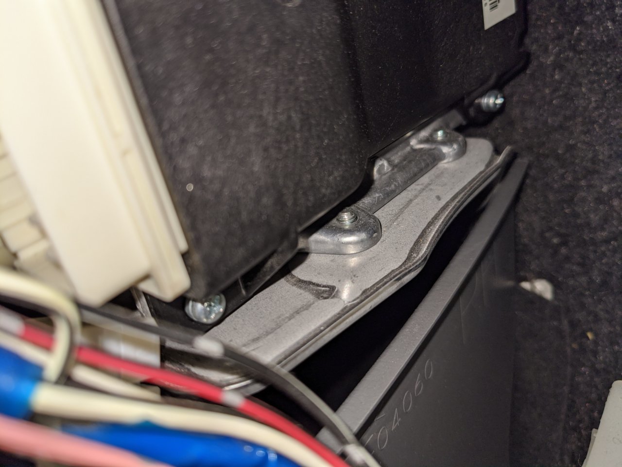

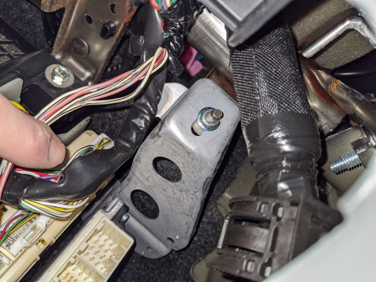

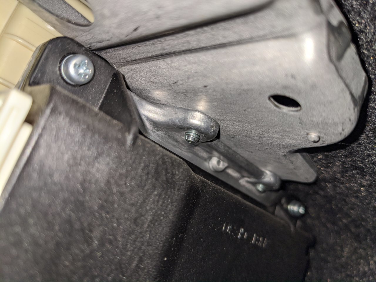

    Thank you, have no doubt you will.
    Now, on removing that ECU, got all the plugs disconnected, no problem there.
    Re getting the unit out, do I unscrew the four phillips screws that appear to be holding the unit to the bracket, or remove the bolts and bracket assembly?
    I think the bracket needs to be removed, as the screws look like they hold the UCR together.. If it's the bracket, how do I get to the back top bolt?

    OK, found this thread https://www.tacomaworld.com/threads/ecu-swap-2013-tacoma.602328/, looks like it might just be three bolts. Think I got it figured out. Will repost if I run into any issues.

    Bingo, take the brackets out with the ECU, then take the brackets off the ECU once out.
