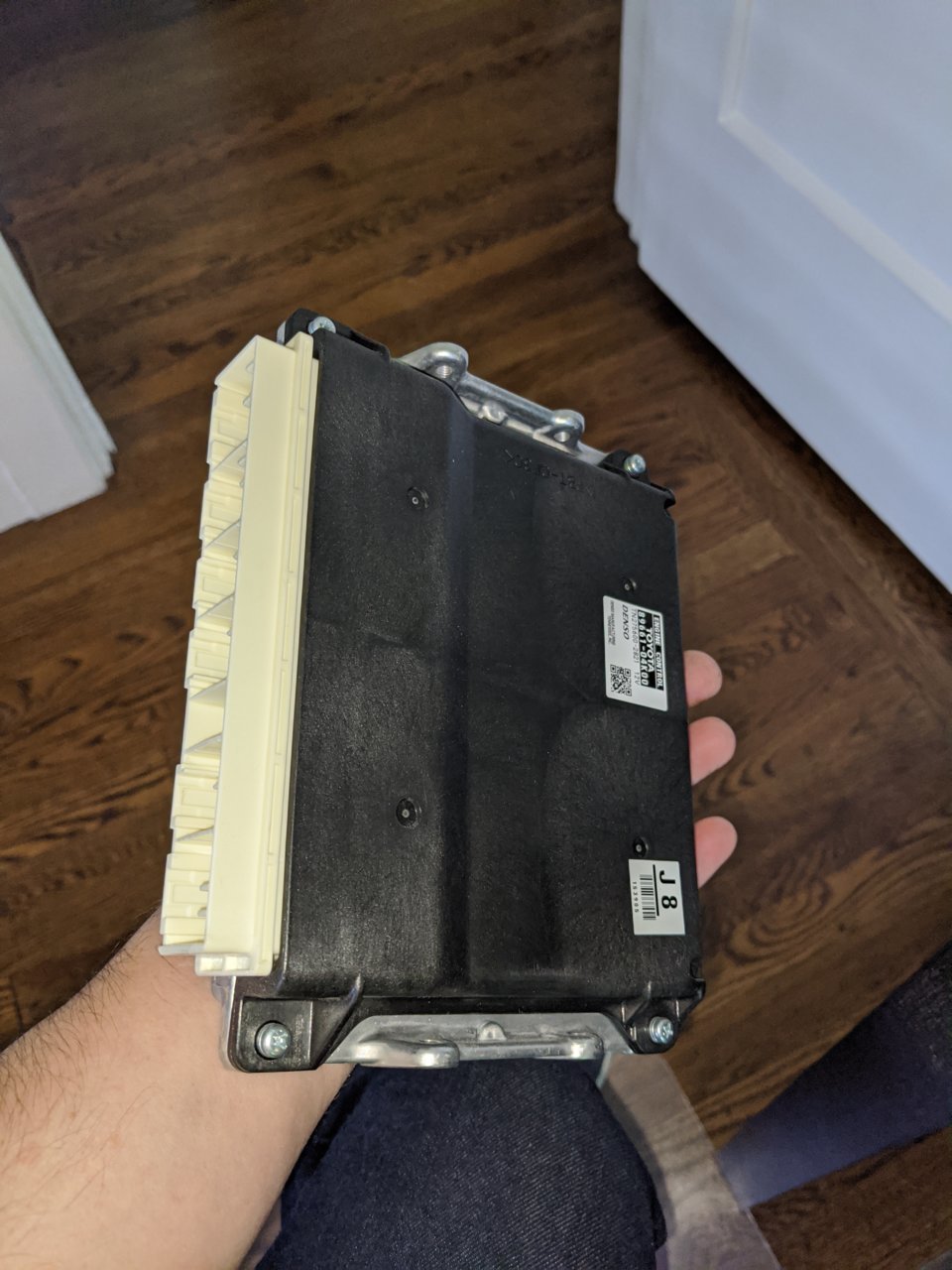

    That’s it! If you can get a USPS Regional Box A, they fit good in there and are about $11 to ship

    Awesome. Thank you.
    Hopefully that's the last of my dumb questions that can be answered using search. :facepalm:
    Thanks for the shipping method info. I found USPS to be the best, thanks for the info on the packaging.

    Yep, the PCM SHOULD fit in a nice flat rate box and be there within two days.
