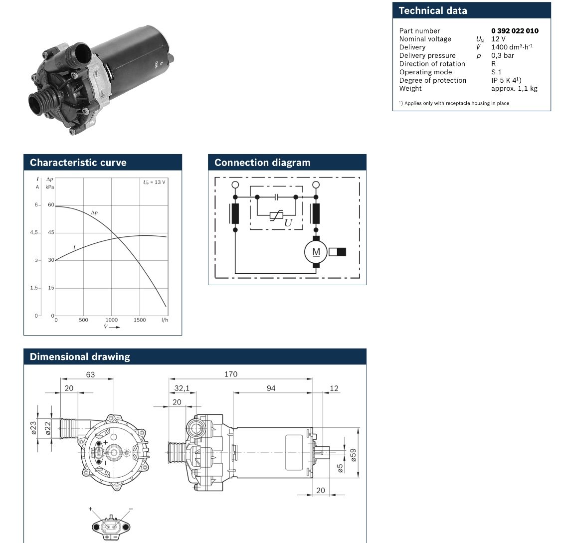

    I’m looking at that coolant pump that @12TRDTacoma found. He states that it flows 1.1 GPM more than the factory pump.
    What is the flow rate for the factory pump anyway?
  10. Apr 7, 2018 at 5:00 PM

    I can’t remember the exact gpm, but just know you can find pumps that are 30 gpm or more and will flow less than stock, because they have to be able to pump high flow under pressure (going through the heat exchangers)

    So, the Mercedes pump is no beuno?
  15. Apr 7, 2018 at 6:31 PM
    #2735
    Murphinator
    Murphinator Well-Known Member
    Mar 1, 2015
    #149903
    3,335
    Anthony
    SoCal
    14 DCSB 4x4
    Nothe mercedes oump is an actual upgrade to the stock pump. Both pumps are made by bosch, But just incase you were researching and found some of the other pumps out there, figured I would save you the trouble of going down the rabbit hole.

    An, thank you. I’m only looking at the Mercedes pump right now. I can’t find any specs on it though.
    If the factory pump flows 5 GPM, adding 1 additional GPM is a good upgrade.
    If it flows 15 GPM, not so much.
    Just making up numbers there.

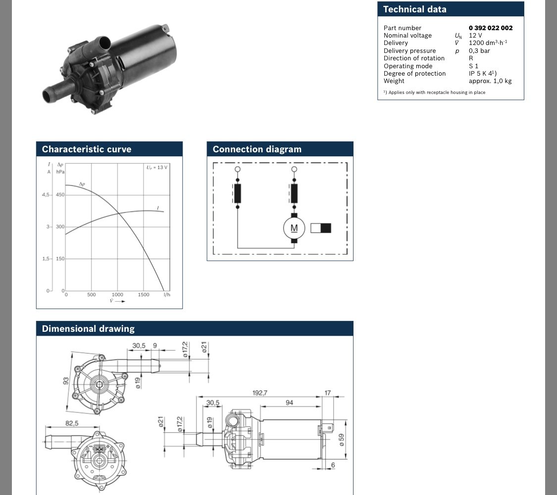

    Here is what I could find. Top pic is stock, bottom pic is mercedes pump.

    I actually did find that sheet for the Mercedes pump. I couldn’t find one for the Stock pump though, and I don’t understand the unit of measure TBH.
    Nice. Are you running this pump?

    Nope, im running the generic bosch (same exact part# as factory toyota one)
    That one i linked to says 6.9gpm
    https://www.amazon.com/Johnson-Pumps-10-24504-03-CM30P7-1-Circulation/dp/B00LHKHRKS
    I am not experimenting with coolant pumps, sorry.
