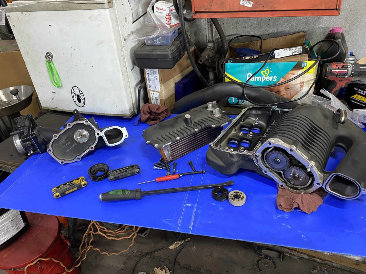

    Next up is a Quickchange pulley! =p

    you change out the coupler for the nylon, non-spring loaded version too? Definitely one of the best changes I've made to it. no more "rocks in the screws" sounds..

    Any reason they do not include one of those from the get go?

    I honestly have no idea. Some of these other more edumacated guys here could shed light on that. I think the spring loaded OE version was to help create a smoother coupling between the rotors.. but wears after time.. then gets sloppy. The solid nylon is just that. Solid.. so keeps them engaged together better with no slop. Kinda like going from regular rubber bushings to Poly. That's just my shot in the dark guess.

    That makes sense.. Usually the default idea when they do not use solid parts. More comfort.
