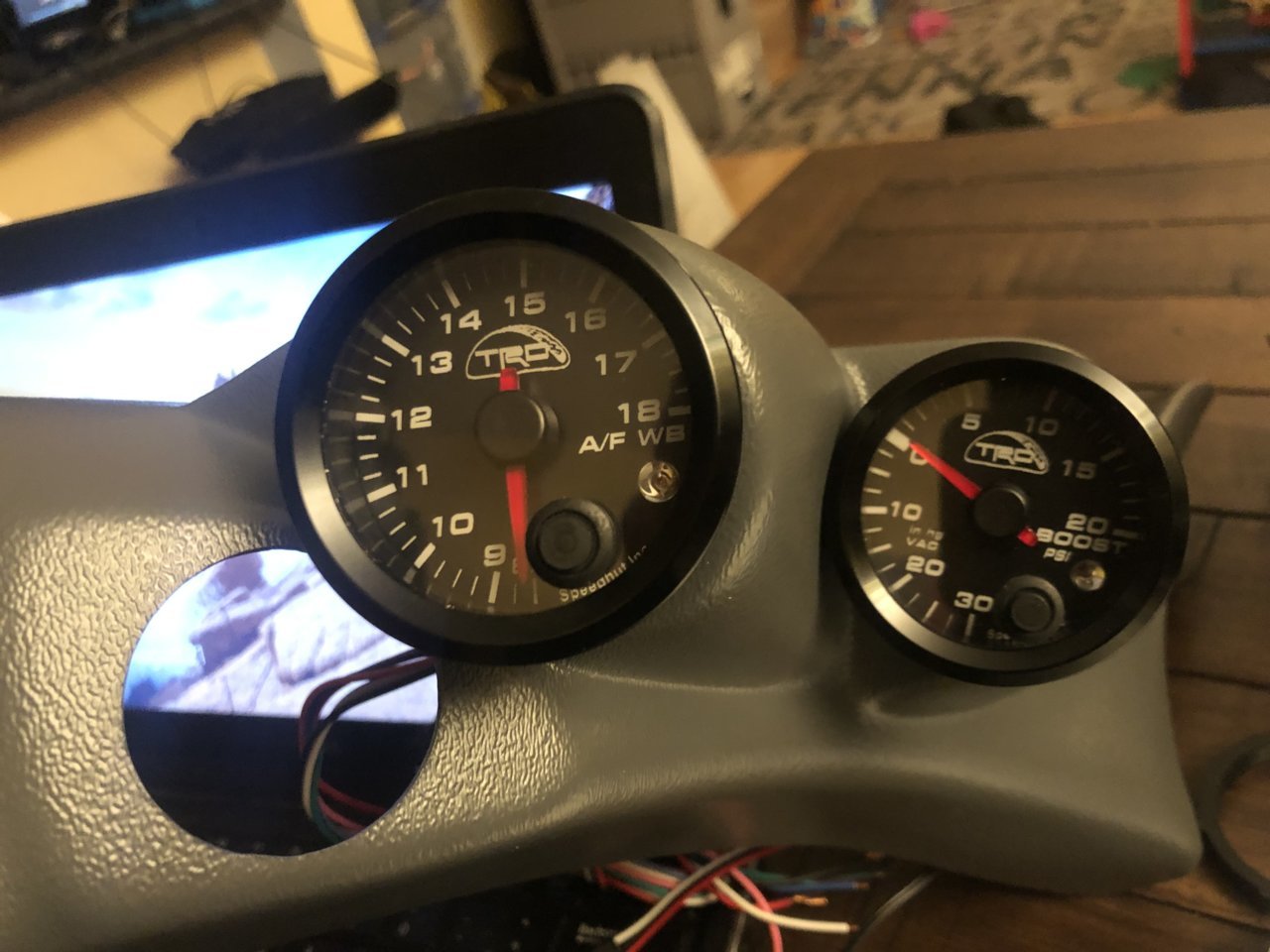

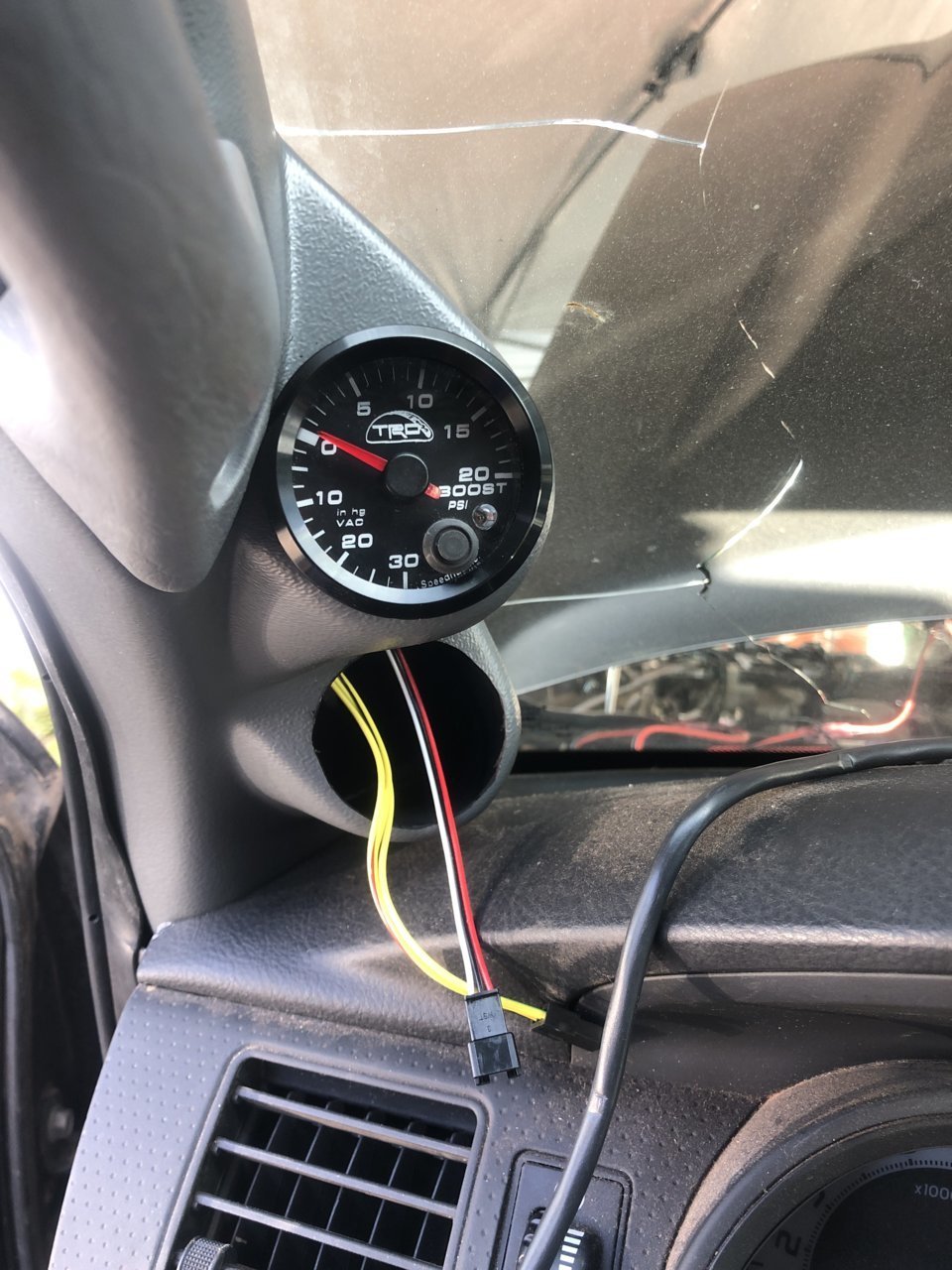

    This is the set I ordered.

    Yah we’ll see. @JustDSM got his hands on the OE FJ MAF tune. I am going to give it a run tomorrow on a new tune and see how it goes.

    after the TRD tune I would guess to some extent. He sent me one to accommodate the list of mods. Which comes form what he’s seen and it’s had a several revisions since the weekend. I need to get my AFR to get him some good wideband data

    Ha like I said, he gave me a tune to start but not sure exact settings. We have been going back and forth on tune revisions since Sunday getting it initially dialed in. Some spicy tuning but not sure all parameters yet. I’m a newb when it comes to tuning.

    Thats the same ones I purchased, except my boost gauge only goes up to 15 psi.
    I don't think I will ever get that high though.

    Totally. as I am learning more about this I have noticed each change he has made. We can compare notes with Justin and see how mild or similar it is to yours. Right now were trying to get the MAF dialed but my lack of AFR gauge is making it harder than it needs to be. Shooting to get to that this weekend.
