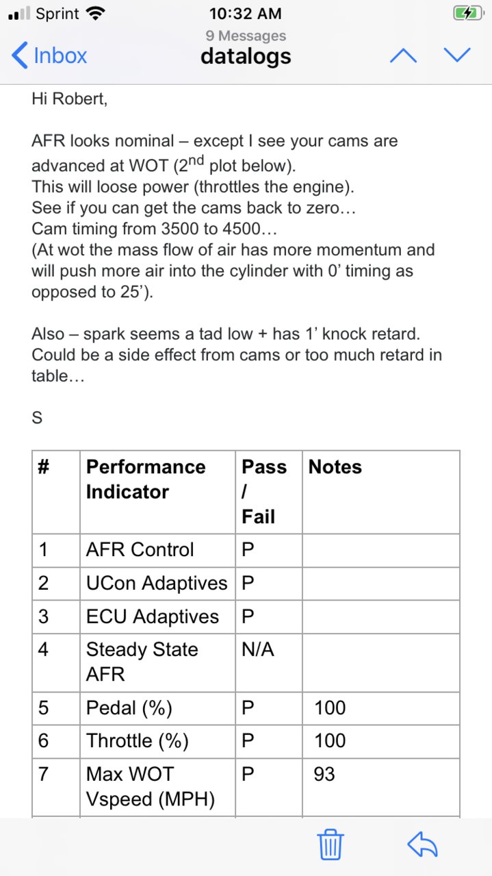

    Sounds so much like what I experience with the UCON. I actually got a good data log of it at the time. Here’s some feedback on it. Don’t know if it’s relative to your issues.
    First off, the steady state and wot are nominal (plot 1) below:
    AFR control excellent
    Adaptives are tight
    Spark is excellent at 20’
    No signs of knock
    Regarding the unexpected decel:
    I do see the throttle pulling back from 21 to 8.79 when the pedal is firm increasing (plot 2).
    Mass airflow is spiking high then low (toggle) around the event (plot 3, point 2536)
    The CAMs are both falling from 16 to 6’ around the same point.
    AFR control is nominal – no lean spikes.
    Engine acceleration does not decrease until 300ms later.
    Spark angle is being driven by torque control mode…
    So the MAF toggle presents like a physical issue.
    It occurs before the throttle drop.
    And you mention that this only happens more when turning.
    I would examine your air induction pipes.
    Make sure there are no vacuum leaks and all pipes are moving when the vehicle flexes during turning…
    It could also be related to bad wheel speed sensor going into the traction control computer (UCon does not access).
    Try keeping traction control off and see if the unexpected decel disappears…

    Full-time AWD & BorgWarner EFR 6258
    I have had issues with throttle cut on initial acceleration, with my UCon, and it ended up being the cams were being advanced at wot and it was cutting throttle to the engine. In my case it was caused by traction control being turned on. After i turned it off the issue went away and it spun the tires willingly. This always happened right when i would punch it from a stop

    Ogden, UT
    Good datapoint, but completely different scenario from a casual/gentle take off and a "hammer it off the line" take off. In your case however, It is to be expected to be a traction control thing and thus be dealing with throttle closure.
