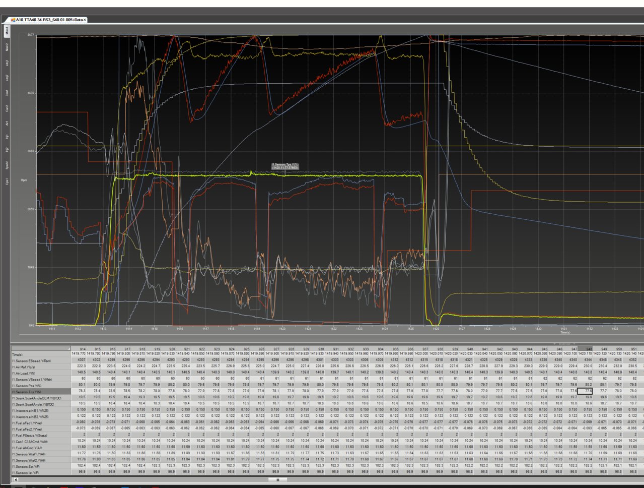

    Okay, I'm sorry, but the outcome of your issue was a HILARIOUS @snowsk8air2
    :rofl:
    Hey @JustDSM
    new log has been taken and sent over your way and my supercharger coolant reservoir is no longer making a disgusting mess thanks to @mightytacoman I'm ready (and long overdue) to regain the power I have lost again. :)
    Let's put this debacle to rest at last!
