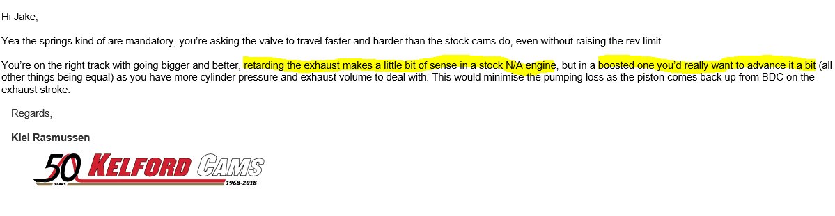

    I figured that might be the case. Pressure cooker. And he claims that he saw more boost after doing the cam gears. That, and what Kiel at Kelford was saying was saying when we were doing the group buy has me wondering...
    I suppose one could simply flip the cam gear over to go the other way...

    This is interesting, especially since cam gears are on my to do list for this weekend. Any other supporting information you've seen on this?

    Do you have cam gears? Part of me thinks that the cam gears still bump boost even if there is no restriction in the engine.

    So who’s gonna be the first one to flip them to advance timing a little.....

    Interesting.
    I have the cam gears.
    They retard exh valve timing 3° which keeps exh valve open later to help evacuate the cylinder.
    Stock the exh cam closes too early creating a built in egr system.
