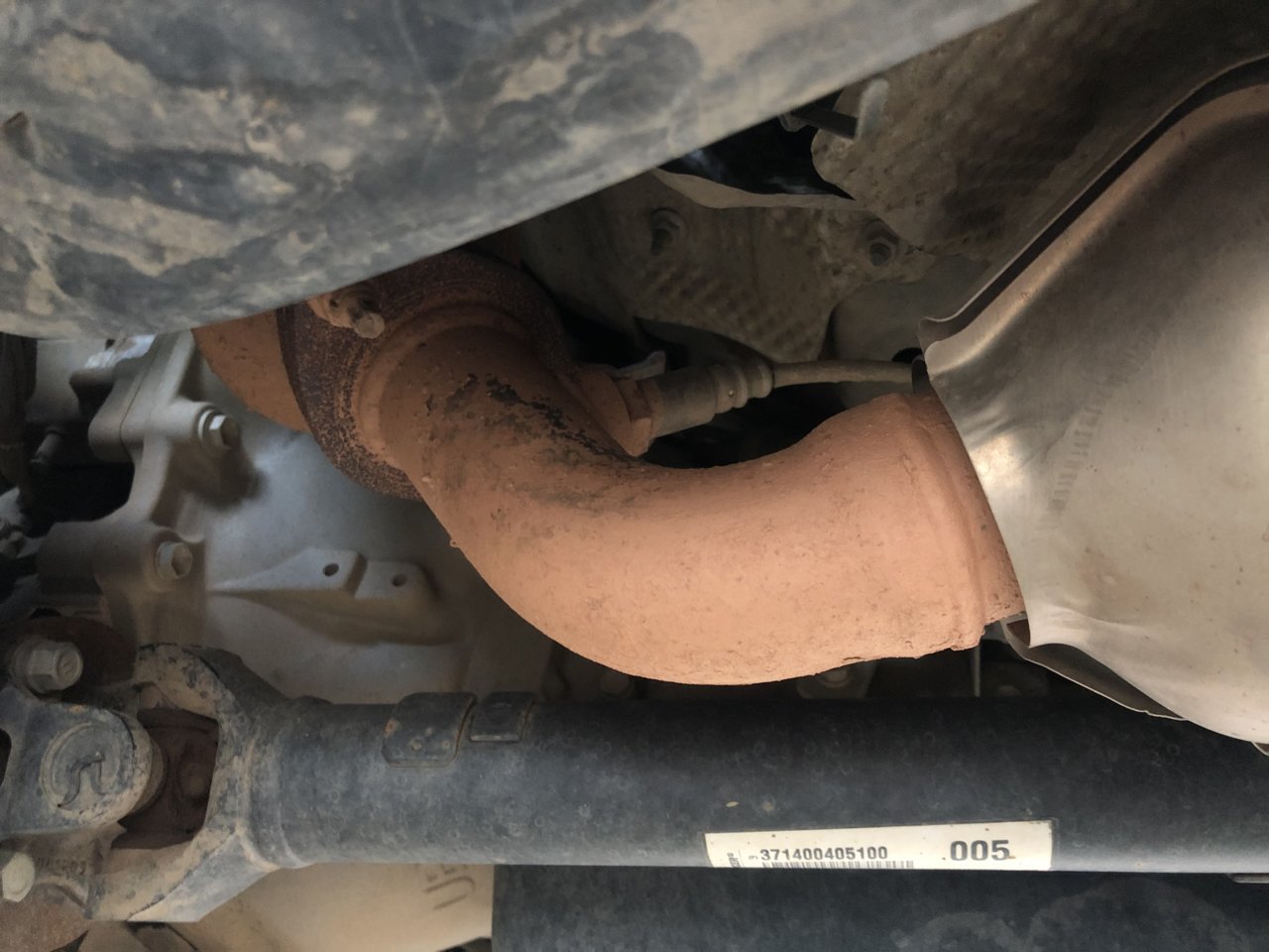

    12TRDTacoma
    12TRDTacoma [OP] Powered by Ford, GM, VW, and Mercedes
    Aug 20, 2012

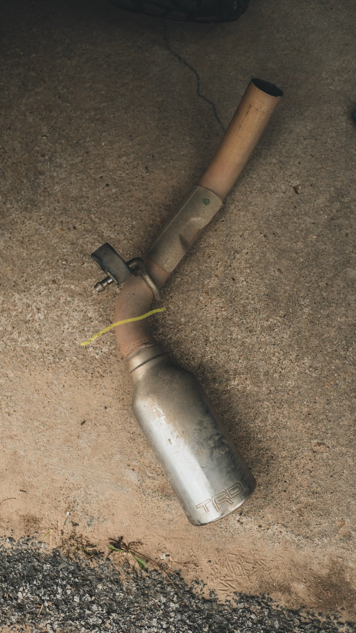

    Does anyone in here have an exhaust tip they've cut off the TRD catback like this one? Im trying to find another so i can cut the tips off my aFe sidepipes and have these welded on. Just need one more.. if you've got one let me know what youd like to get for it!

    I haven’t taken mine off but it looks flat and I’ve got the stepped NST from my order. Emailed them but no reply.

    for the AFR gauge does it matter if it’s closer to the headed cat or the secondary cat? Tossing on a no weld on the drivers side to hold me over.
    Flake Boost likes this.

    I would do a centralized one right on the Y pipe.

    Interesting idea.. Is the idea if your only running one that your getting a more even reading for both sides?
