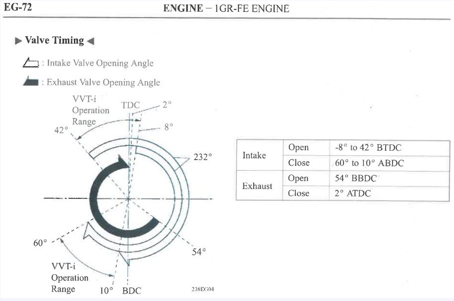

    I'm not a cam expert by any means but exh valve timing (actual valve timing) stock opens at 54° BBDC and closes 2° ATDC.
    The retarded gears just skew that number 3° for a new exh valve timing of open at 51° BBDC and closes at 5° ATDC.
    The later opening of the exhaust valve allows the power stroke to push down on the piston for 3 more degrees and the later closing of 5° ATDC allows the exhaust a little more time to evacuate the cylinder.
    Since exhaust is a gas and gas has mass, then momentum must be taken into consideration.
    Allowing the exh valve to stay open 3° later gives the cylinder a bit more time to empty while also pulling in a stronger intake charge during valve overlap.
    Yes we are pressurized now with the sc but that also means much more exhaust mass with each power stroke and we want as much of that mass emptied from the cylinder to prepare for the intake charge.
