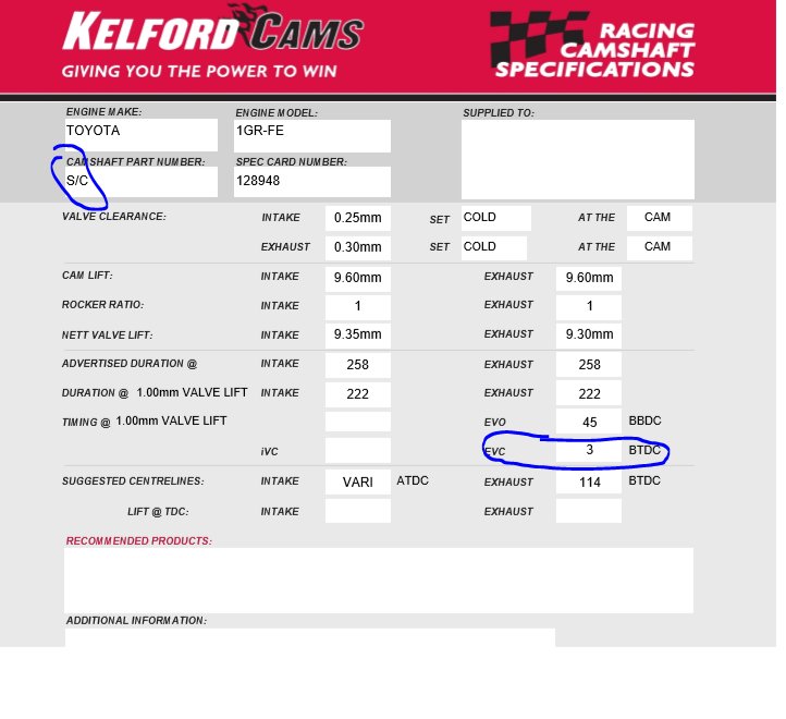

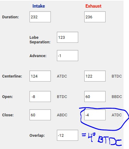

    You're mixing up crank and cam degrees. (see last pic) But, I see what you're getting at. First off, Retarding the cams has not given us any more time to evacuate anything. Duration has not changed. The events are just happening at different times.
    Opening up the exhaust valve earlier is surely going to evacuate more exhaust gas in a more efficient part of the pistons up-stroke as well as reduce pumping losses. We're also barring more exhaust gas from being present when the intake valve opens. (your EGR effect) We got rid of it earlier.
    I don't have a horse in this race. I bought the cams. Just sayin. Narrower LSA and more overlap is the wrong direction for a supercharged engine.
    I'm betting that going the other way (advancing) makes more power under boost and that retarding them would make more power N/A.
    Here's Kelford's strategy:
    Wish I'd had this calculator yesterday. :rolleyes:
    Exhaust cams advanced:
    Retarded:

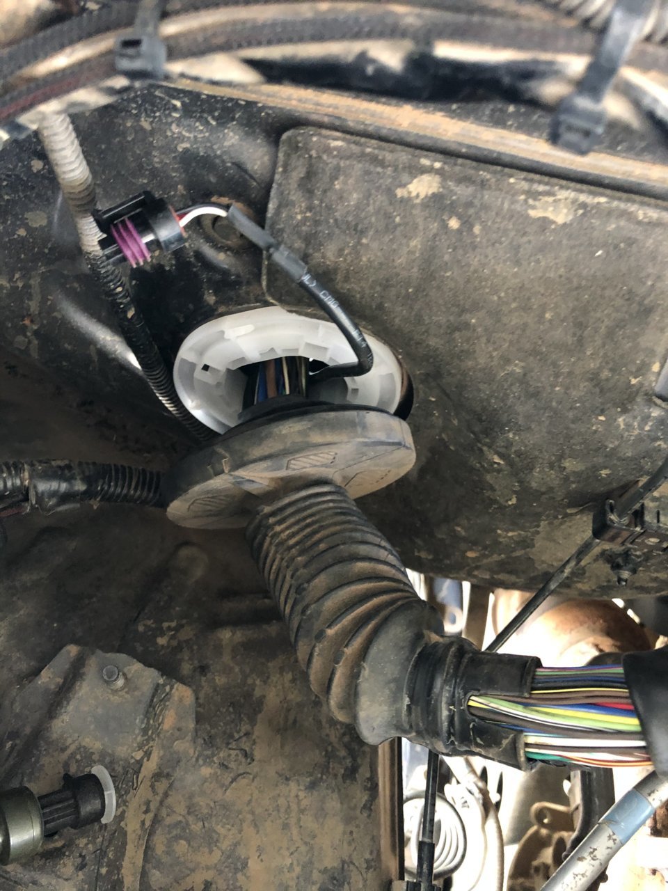

    Trying to feed my boost line through the main passenger. Did you guys that did it here manage to feed it through the boot or feed it a different way?

    I did mine through the little hole above it. Just depends on how firm your hose is.

    I was debating that one. I may swap and do that. I can’t see a way through the main without cutting the rubber cover. I’d rather cut the small one
