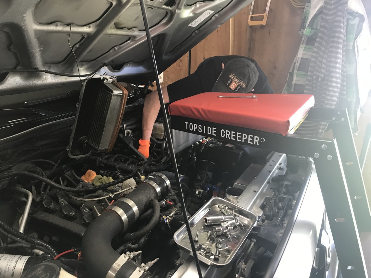

    Dad helping me get the headers loose.

    Why is the blower too lid off? Other work or is it required to loosen the header bolts?

    The Topside Creeper is KEY. Taking off the blower lid lets you get after the header bolts topside without twisting yourself through the wheel well.

    I am going to do spark plugs and install a sensor for IAT at the back of the manifold. So I just took it off before starting the headers, in the hopes that I'd have a bit more room to loosen the header bolts.
    I love that topside creeper, more than I thought I would. I have a bad upper back and it's saving my life.
