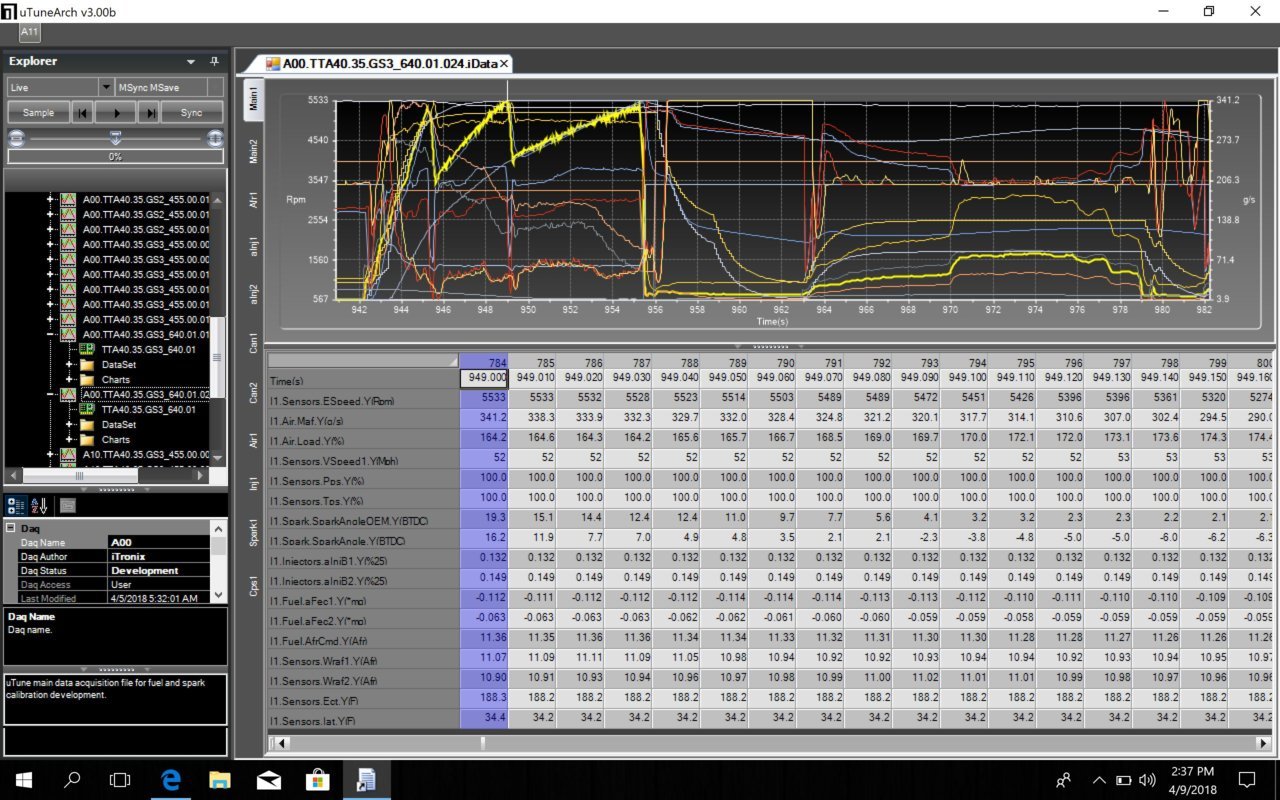

    I believe 341 g/s (highlighted in blue) is the MAX MAF g/s, correct?
    What is the max percent load? At which RPM as well.
    Then, with that what is the MAF g/s at that load rpm?

    Looks like 381.944 brake torque at 5533 rpms.

    That I believe will be lower than peak load which should happen much sooner than 5533 rpms. I could be wrong though. Just want to check.

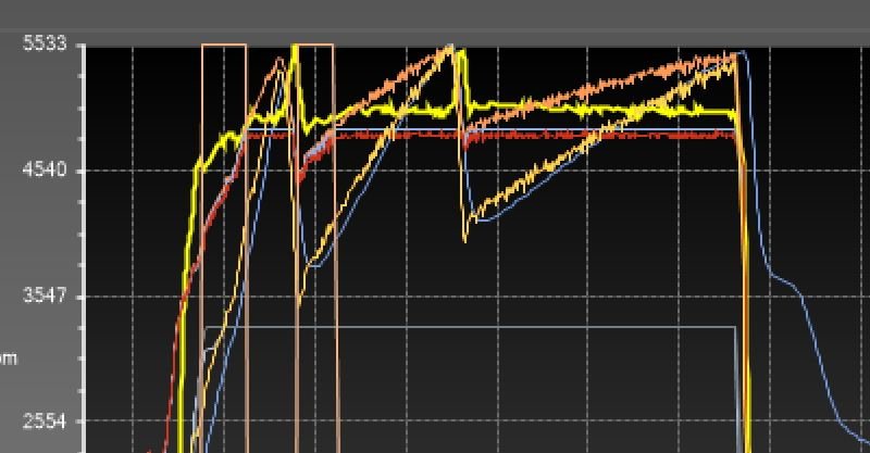

    Yes, peak MAF was 341.2 g/s @ 5533 RPM
    Peak air load is 182 @ 4874 RPM with a MAF of 251.1 g/s
    EDIT: I'm don't think that is the correct value. That's the only thing the UCON logs that says load. And based on the way the graph looks, that is occurring DURING a shift, so on the way down in RPM.

    Air load is the yellow line.
    MAF is the light orange line.
    RPM is the blue line.
