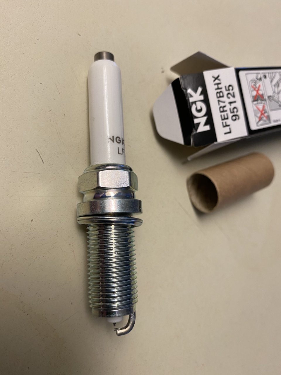

    I went ahead and pulled the trigger at last on some Ruthenium plugs as per @Kelvin 's suggestion long ago and @BillDaCat8 's recent install of them due to his finding of them at Napa auto parts (apparently these guys got the serious go fast stuff with the RPM belts, Ruthenium plugs and what have you). Went ahead and got started throwing them on today at about 8:15 am and came home at about 9:15am... Whoa.. night and day difference. These are not like your traditional Iridiums.. they smoothened out the engine a lot and spark knock is like 1000% nonexistent now. Like entirely. There's even been a small bump up in power. At least butt Dyno confirms it.

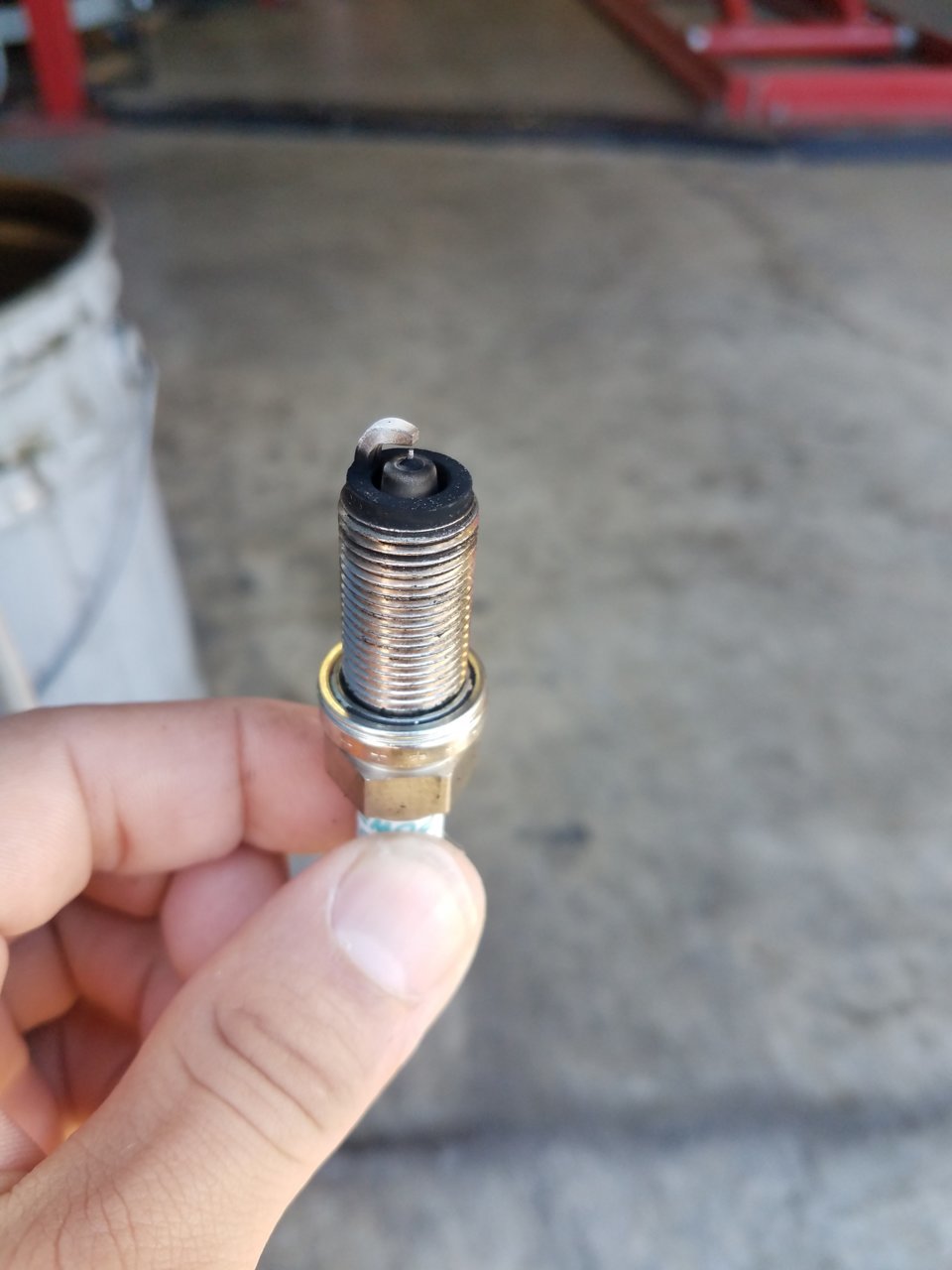

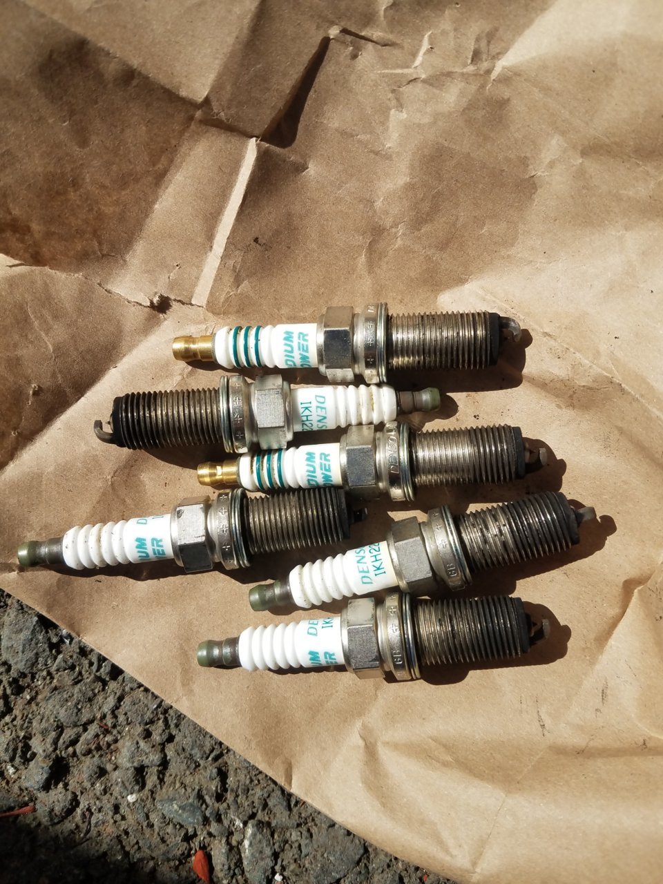

    Look at these garbages.. lol. This is after some 5 months of install in my engine mind you. o_O:mad:

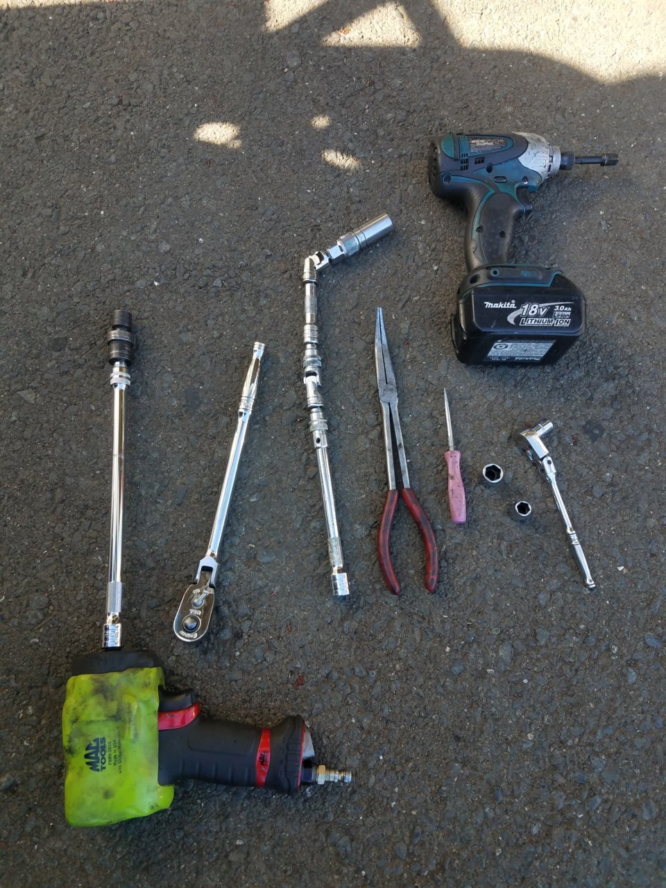

    Also, here is the set of tools needed to pull this job off without pulling the blower.. a short 10, a short 12 and two 3/8 swivels.

    Which of the Ruthenium's did you do? I did the 95125's with the PSPE tip and the weird ceramic end.

    Mine had less than 8,000 miles on them for sure. There is no way they could had been that bad.
    The PSPE square end tip is supposed to offer a much more volatile flame kernal over the Iridiums due to the increase in real estate available. Theoretically they should increase our fuel economy due to the more complete burn better ignitability factor. Due to these theoretics, they should last us longer as well before replacement is required.
    They almost remind me of a higher tech version of side gapped plugs because while the indicated gap is .039" the square end closes that gap a little more while the actual ground strap is higher up above the the square tip.
    95125 NGK
