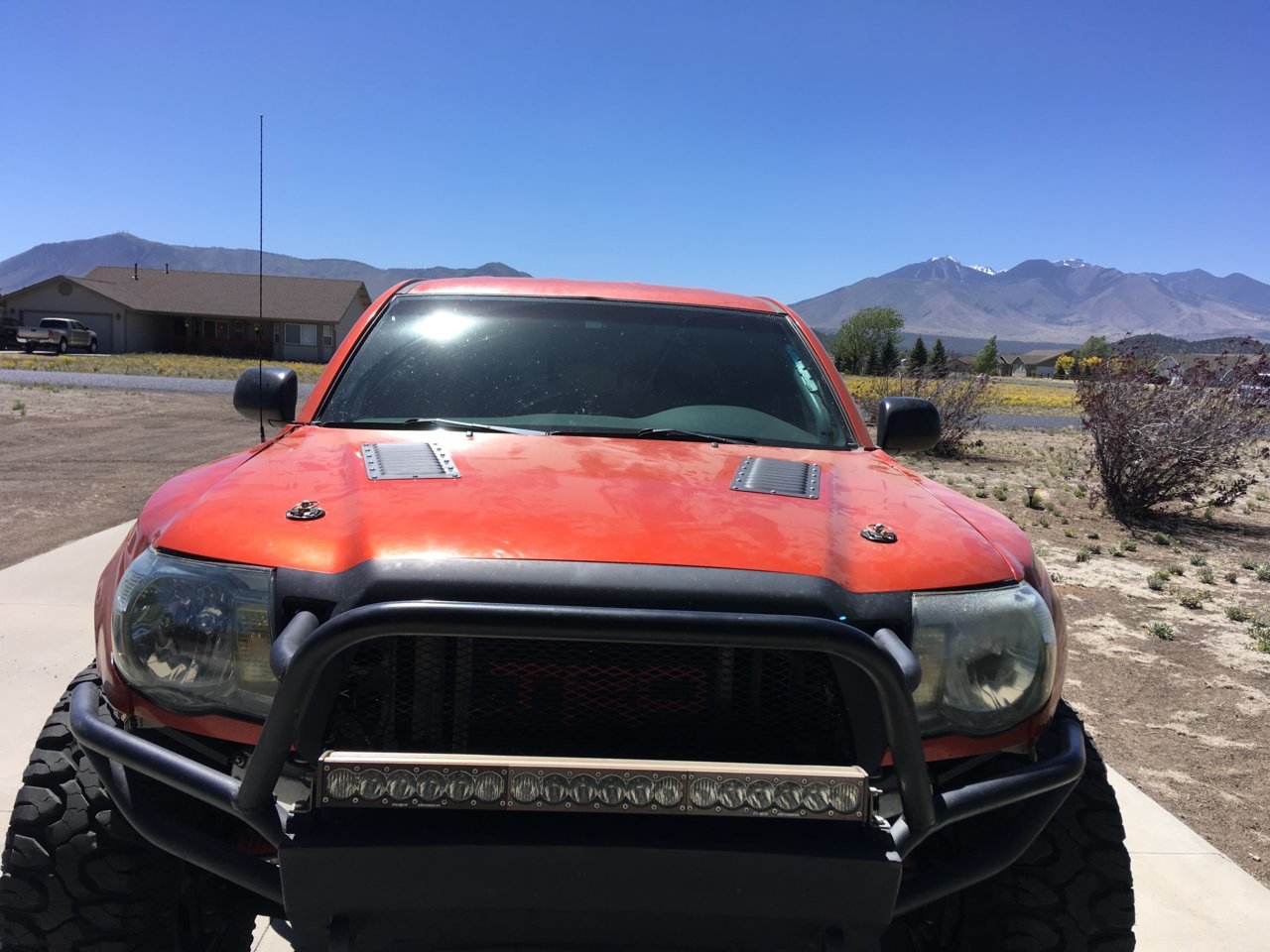

    lets see a pic of your louver setup.

    passenger side one is just inboard of my new air filter location. This mornings drive into work had IAT’s about 10-15* above ambient depending on my speed which is better than the 25-30* before them in similar temps. This afternoon will be a better test as it should be in the mid 80’s

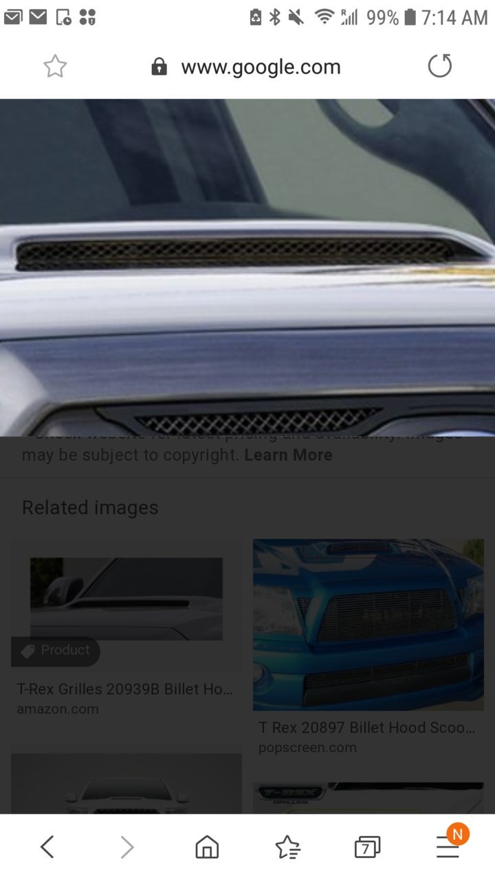

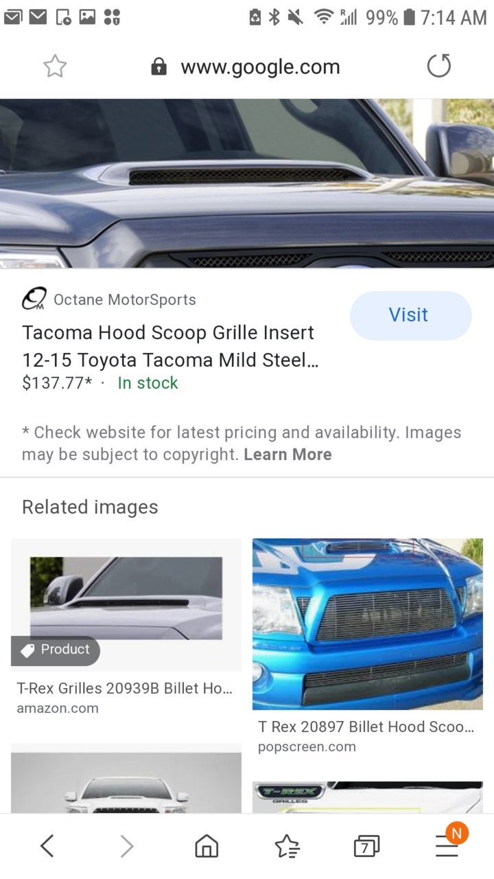

    You know I really wish they made a vented hood scoop for the 2012-2015 Sport models.
    I believe T Rex grilles makes something for the Sport models but I don't know what is comprised in making it work or if it even opens up the scoop at all.

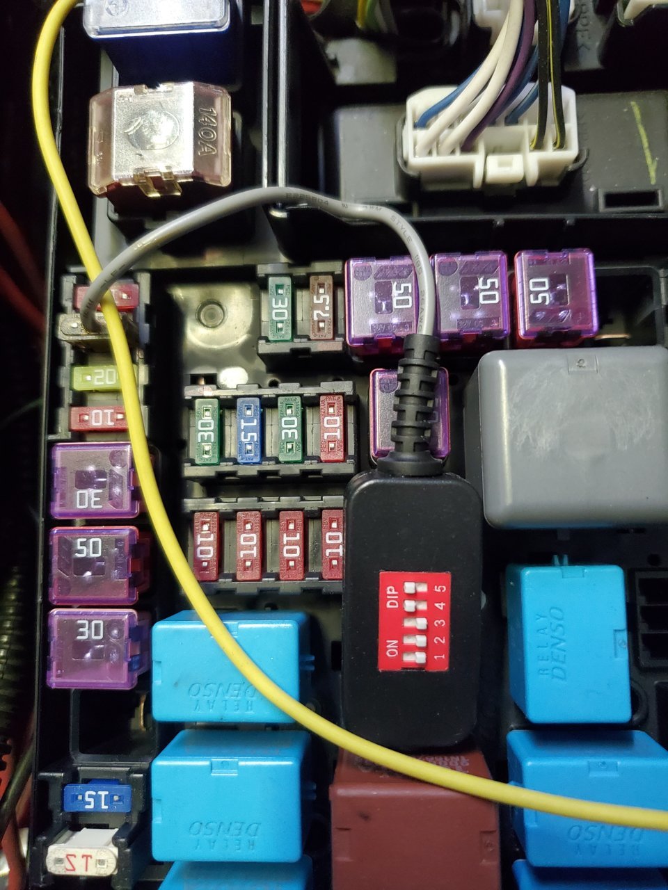

    So the speedhut gauges are installed correctly.
    The afr gauge requires 13.7 volts to start its warm up cycle.
    Mine has been working on cold start but on a warm start will not respond. I only have 13.4v on warm start.

    I'm not arguing, but I don't remember seeing/reading that anywhere. Is that a gauge or the sensor requirement? Which model gauge and sensor are you using?

    I have been working with speedhut support and this is what we came up with.
    I’m using there GR1-236 stand alone afr gauge.
    Options
    1. They can reprogram the gauge to start the warm up at Cycle a a lower temp.
    2. Do the voltage booster mod
    Norton[QUOTED] likes this.

    Interesting. Gotta wonder why that's not a published requirement? If you go the voltage booster route and you're running a "normal" wet-cell battery, be careful you don't boost too high for it.
    FWIW, I'm running their GL1-265 standalone AFR, which comes with the same sensor and I assume has similar "programming."
