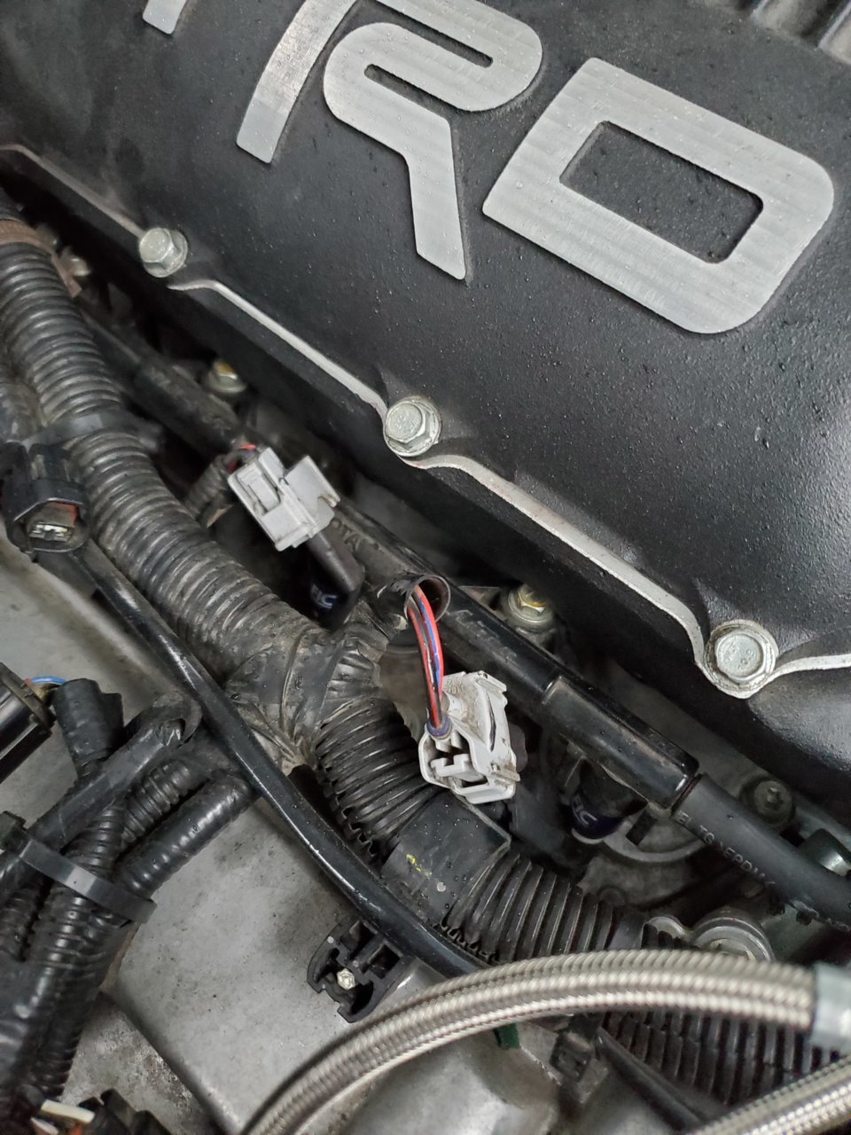

  12. May 30, 2020 at 9:05 AM

    Got a picture of them? The color doesn't matter to me, because that is not specified in the verbiage by TRD. As long as they 100% PnP. I'd really rather not splice in 6 individual plugs. That's 12 wires I'd have to solder and heat shrink and make look all OE like to pass inspection.
    Passenger side is now exposed because of the TRD intake.

    i dont have a pic. visualize a 3" wire adapter clip similar to a urd maf extension wire. i highly doubt a tech would spot it. i bought the adapters for the same reason as yourself. not cutting factory wires when not mandatory.

    crazy thunderstorm out now but i got a quick snap @12TRDTacoma 20200530_092150.jpg

    They would see that. You don't know California too well brother. Lol. The techs out here are dicks because their job and livelyhiod is on the line, so they are THOROUGH.
