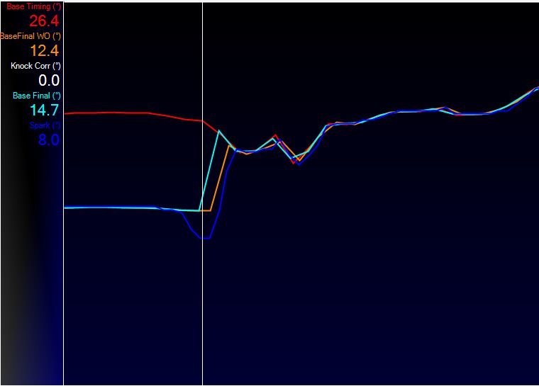

    Below is a snapshot of what is happening when this hesitation/stumble/bog/etc occurs. This screenshot will show you some of the general parameters at play. If your attention isn't drawn to the dip in the ignition timing (Spark), this is why the truck experiences (insert above verb here). Lets look closer at that in the next image.

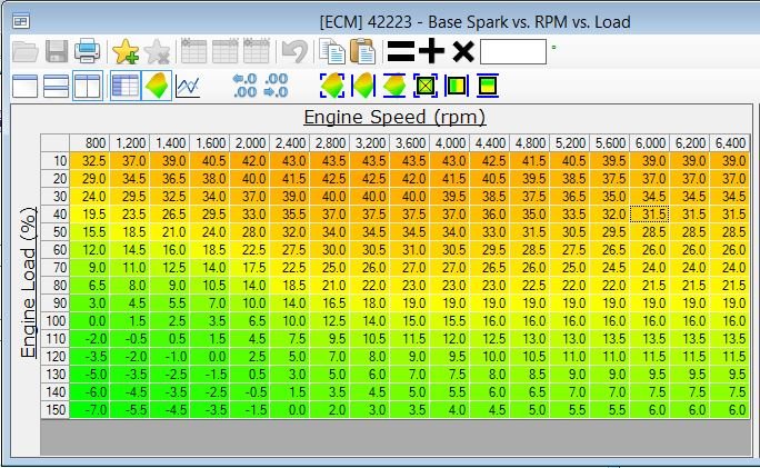

    To start with the ignition, lets familiarize ourselves with the Base Ignition map. (Disclosure: do not run this table. This was a specifically modified table that was specifically setup to combat specific mechanical issues that are not relevant to this discussion. It's being posted in its entirety for the sake of transparency). This map is generally speaking, the ignition advance your truck will run at a given RPM and Load.

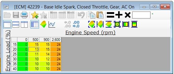

    Up next is the Idle map. Their are (4) specific maps related to Park/Neutral vs Drive/Reverse and A/C ON and A/C OFF. I'm making the assumption here Roberto had the A/C on ;) But this is the map for the trucking being in gear with the A/C on.

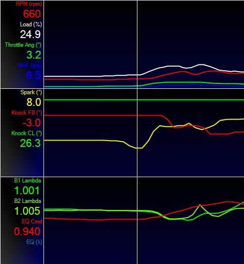

    Now lets take a quick dive back into the datalog.. In this image, we'll take a closer look at timing at the exact instant in the screenshot above. I'm going to share a little about how the ECU derives what value to use and how it gets from A-Z.
    Base Timing: Reported value of 26.4. This is derived directly from the base table. You may not see this value exclusively in the base table, but if you interpolate the cells, you'll find this to be the value or close to it. Keeping in mind that the ECT/IAT corections are applied to the base table and then it is checked against "Max Limit" value and then...that value is then reported here as "Base Timing".
    BaseFinal WO: Reported value of 12.4. This is essentially the ignition advance value (without knock correction) that is sent to arbitration.
    Base Final: Reported value of 14.7. This is the final base timing, including knock correction that is sent to arbitration.
    Knock Correction: Reported value of 0.0. This one is a little misleading. This PID reports both knock correction that is applied, as well as torque management correction. BaseFinal WO + Knock Correction = Base Final (In this case you can see it is clearly off.)
    Spark: Reported value of 8.0. This is the final ignition advance value as delivered to the engine.
    Now lets work this through.
    Base Timing - 26.4
    Base Final WO - 12.4
    This is where the two timing maps above come into play. The base value (+IAT/ECT and Max Limit check) has the idle map subtracted, leaving us with a 12.4 value minus knock correction.
    Knock Correction - 0.0
    Base Final - 14.7
    With zero knock correction, Base Final WO should equal Base Final. Yet we don't.. We have a difference of +2.3deg. I cannot account for where this additional advance is coming from. Moving on..
    Spark - 8.0
    Spark should equal Base Final, however in this instance it's not. We've got an error of -6.7deg of timing present here. This advance (or retard rather) cannot be accounted for either.
    As observed in the detailed view of the timing advance view, you can see typical/normal behavior following the hesitation event. Observe how all the values essentially line up/overlap? This is typical/normal behavior. The expected correction for idle condition is to be expected when observing the timing in this view, however under the conditions present when at take-off, this is not to be expected. To compound this problem their is additional timing being added and pulled throughout the spark calculation process that cannot be accounted for with the tools available. My initial statements that the problem is with the truck thinking it's at idle are still relevant, but I now see that the picture is a bit bigger in scope and not as simple as I initially thought.
