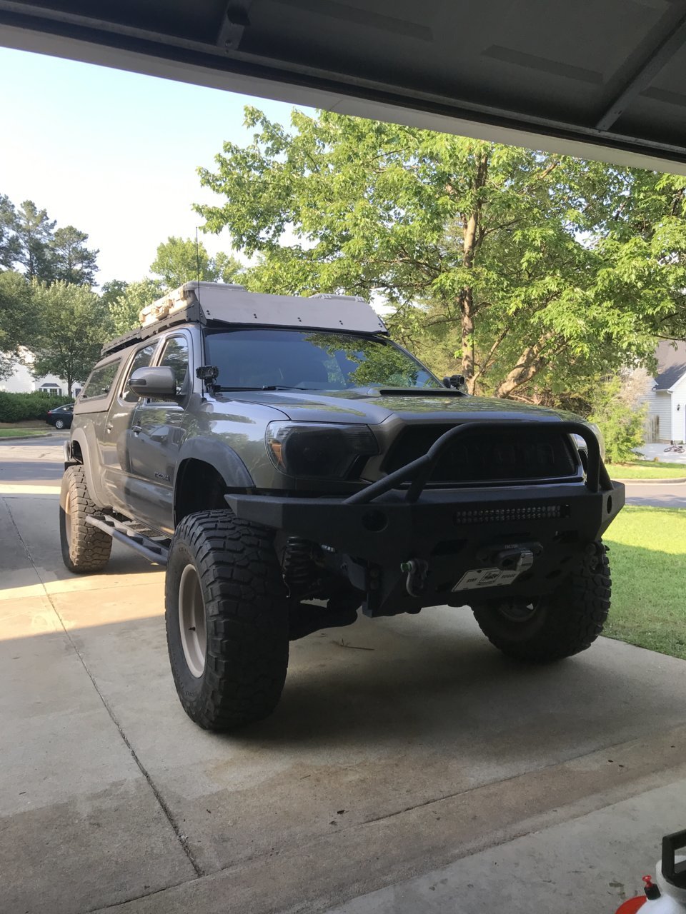

    I was getting 10-11 mpg before the S/C but found my plugs were shot and needed a TB cleaning I would figure with the added power it would not be that bad. Even folks with 37's prob getting better than me.
    My first couple tanks so far have been 6.5 and 7.5. No matter how yo look the overlanding crap should not drop it that much. My buddy with a stock S/C and 285's gets 14 mpg. Your getting something like that. truck is also regeared so hoping that its just not getting enough fuel at times and working harder. Engine def is producing a ton more heat which is to be expected but I was surprised at how much.
    Also to note that at this mgp all of my heavy ass BAMF skids have been off some savings. I can try removing my rear tire and see but that big of a drop was not expected.

    Full armor, cage, 37’s and 4.56 gearing and I get about 12.5-13 during daily driving. You have something going way wrong to be getting that low of mpg’s.
    what tune are you running?

    That is what I was thinking. I was thinking of you and your 37's when I commented. Big diff on our trucks is i have a bigger pulley, 35's and need a few supporting mods but that would not cause that big of a drop. I have TRD layered with some HP tune action from @JustDSM. Justin not sure if you saw anything that would lead to any fuel issues on the last log files?
    Any ideas I can dig into? Would the fuel pump hurt that bad? I do know I need I need to replace but not to this extent.

    Fuel pump would cause lean issues not overly rich. It needs to be done no doubt 100% but if you are actually getting low MPG there may be something in play that's hurting you. Poor aerodynamics will also cause a heavy hit on fuel economy. Like for example a tonneau or a topper or something may do more harm than good because it's changing the aerodynamics at the rear of the bed.
    I'm just going off a mythbuster myth which was busted about the tonneau, not sure if the topper would cause the same, but my better intuition says yes.
    You need an AFR gauge if you don't have it yet and a boost gauge to know what PSI you are running.

    Yah I hear you there. but I had all of this prior to the setup. a 30-50% drop is a bit much. I was getting 10-12.5 with my current tires and current setup. I was getting close to 14 with 285s. I did have a big drop last year before hand but after seeing plugs prob was a big part.
    I am getting 8 PST on my Boost Gauge.
    AFR should be soon. just got my gaskets and will get the bung welded. its already wired up.

    Yah i doubt its a aerodynamics issues. I would have seen that already. Something else is up. Nothing I have is drastically different then most of the group. Even without the fuel pump I would not expect. Its not being driven much but is getting shit mpg =)
