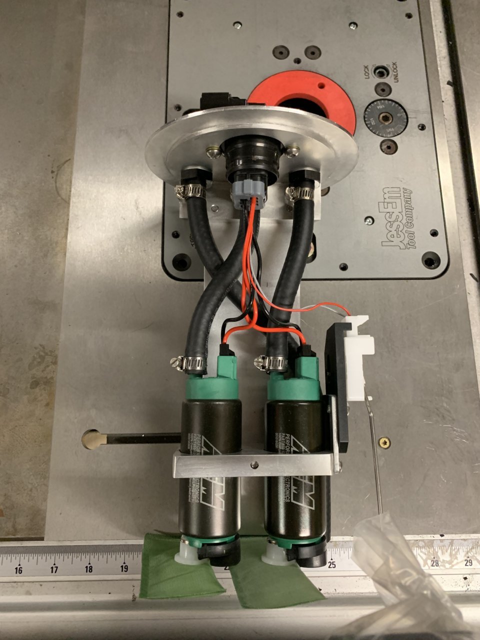

    nice, I already have an AEM 320 in I plan to drop in. I am thinking of doing an external one still. Any issue running an external one with the 320?

    Hey @nudavinci64 do you have access to a scanner? I want to see your STFTs as well as your LTFTs.

    I would actually appreciate that, I do not have anything to compare to.

    I have an ODBlink mx+ BT reader if that will pick it up

    Well I have brand new FIC’s so I doubt that’s the issue. I am hoping the fuel pump is just not up for the task. if anything I expected the same but not that much worse.

    If that’s the case wouldn’t I had seen the issue before the install? it was not gradual it’s been like that since first fill on SC. I figured it was wall the tune testing.
