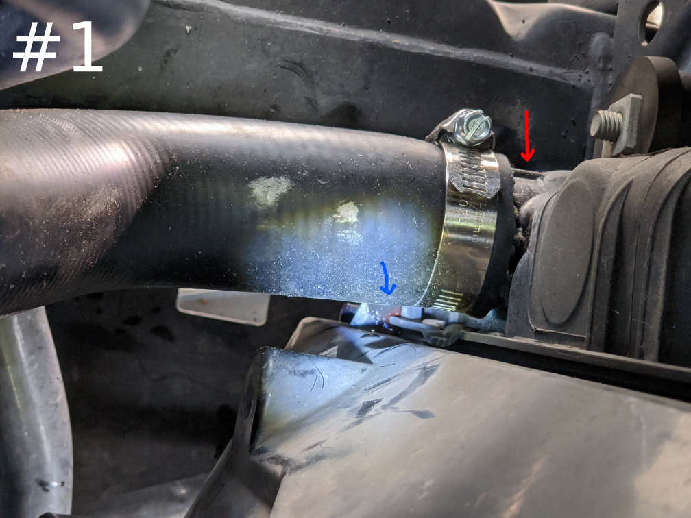

    Found a spot on the driveway this morning and looks like I have a coolant leak from the driver side radiator hose, and have a few questions for you guys before calling the installer.
    In #1 the driver side hose looks like it doesn't make a good connection to the radiator tube(?) very well, specifically where the red arrow is pointing. It looks like there is a notch or something causing the leak? Is this how it is supposed to connect?

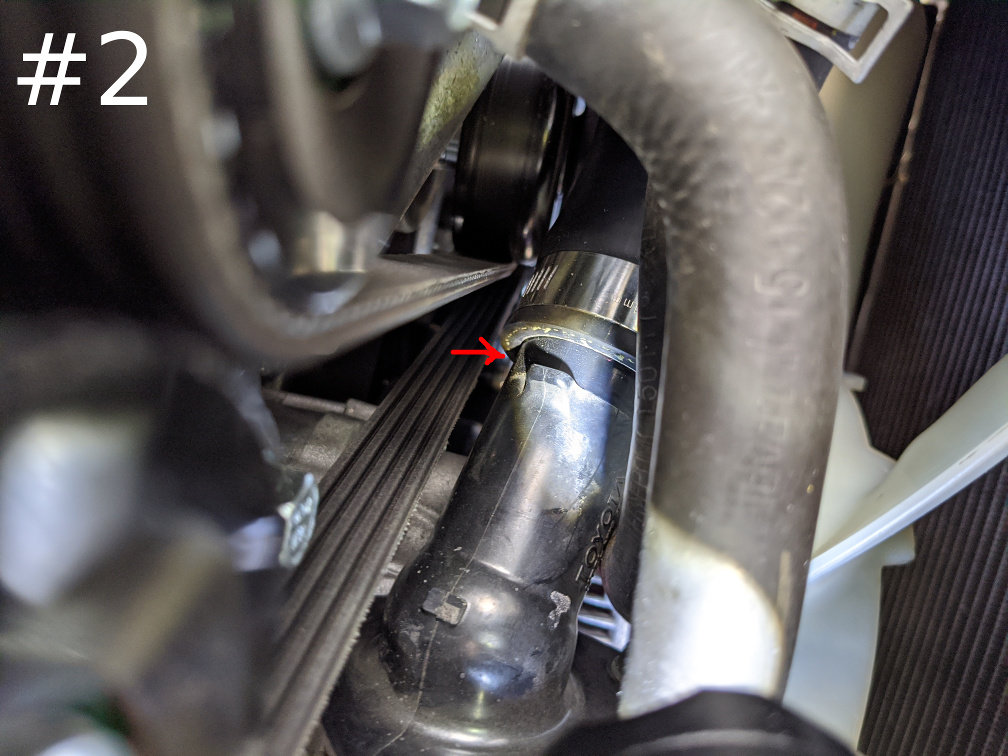

    In #2 where the same hose connects to what looks like a junction, looks like there is a gap, like it needs to move up another 1/2" or so, this doesn't seem normal, is it?

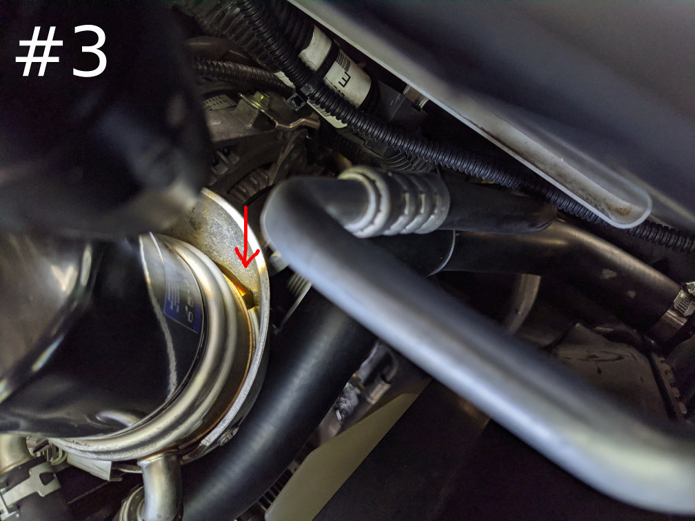

    In #3 I'm thinking that oil is just from prefilling the oil filter before installing and since it has to be inverted some inevitably leaked out before it was tightened, or excess dripped from lubricating the ring before installing. Oil level is normal. Thoughts?

    In that first pic, id replace the hose clamp with an oem style spring clamp. Also looks like it was cut way too short, so you'll likely need to replace that too. The hose should seat all the way against the notch on the t-stat housing in pic 2 and all the way on the radiator outlet in pic 1

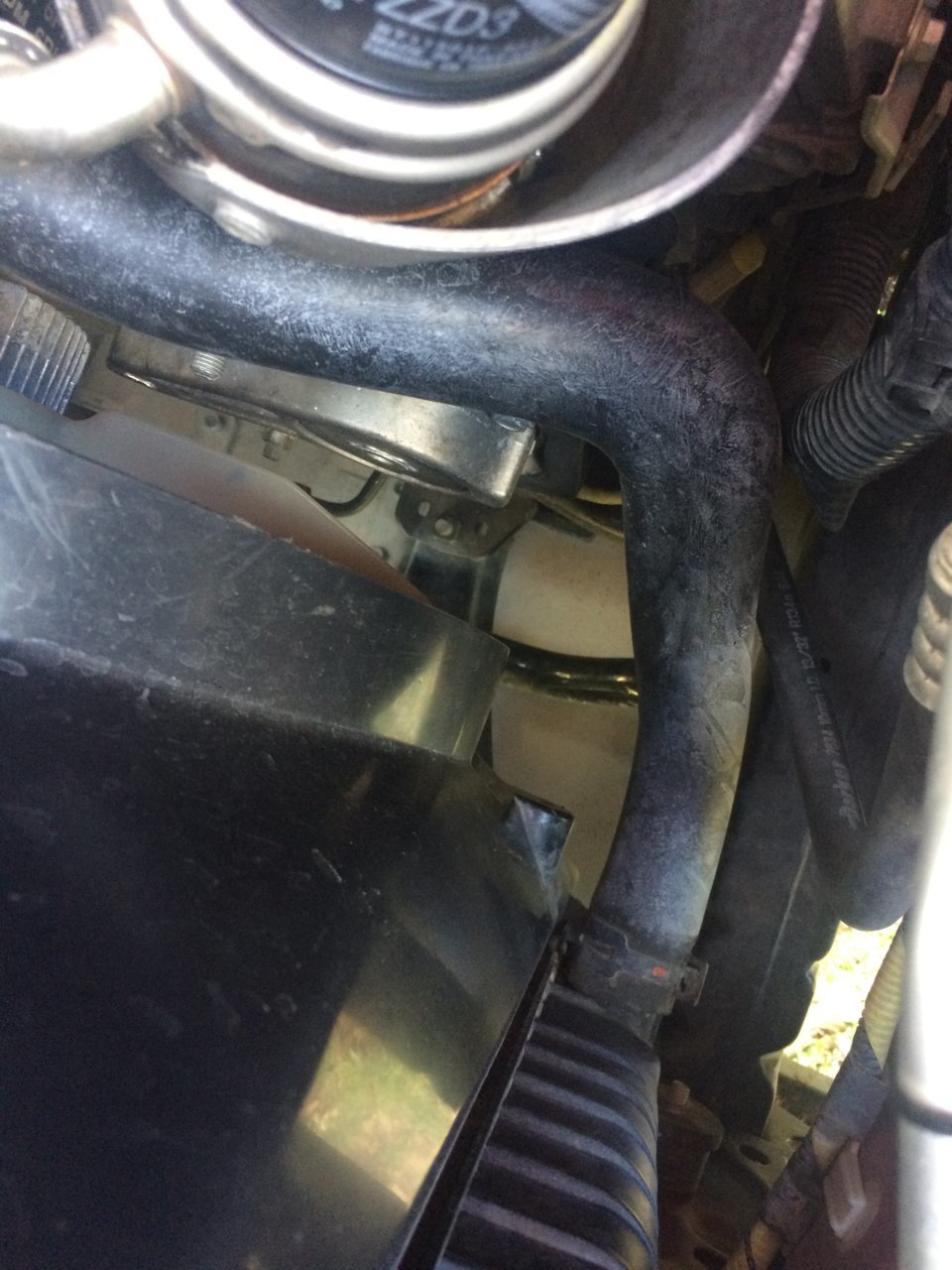

    Heres a pic of mine for reference

    #3 pic is normal. I have a little residue in mine there too from the last change, its hard to get it all cleaned out of there. Just make sure the filter is snug and its not leaking

    @BassAckwards Cool thanks for the reply. OK so it's not like they were supposed to use a special connector, the hose just connects directly? So you think the leak is caused by the clamp style? Looking at it it seems odd that the tube (male end) has that notch, what is going on with that? Seems like it would leak for sure even with a spring clamp, but I'm a computer nerd, I rarely work on cars.
    Thanks for confirming the hose was cut too short. Missed the part about it seating up to the radiator outlet. Looks like I'll just see if I can get a new hose. Installer is in another town.
    Also thanks for the info re the oil filter.

    I am fairly confident the hose is cut way too short, and that is why it's leaking, because it's not seated all the way on the rad. It also isn't seated all the way on the t-stat housing either.. best to replace that before it causes bigger issues
    Yes the hose should just slide right on both the t-stat housing and the rad. Spring clamps should be used and not hose clamps imo. They are a pain in the ass to put on, which is why they probably threw the hose clamps on

    @BassAckwards Thank you for the info, much appreciated. Yeah, length makes sense. I'll grab an OEM hose and cut as per the install manual instructions and install with spring clamps.
