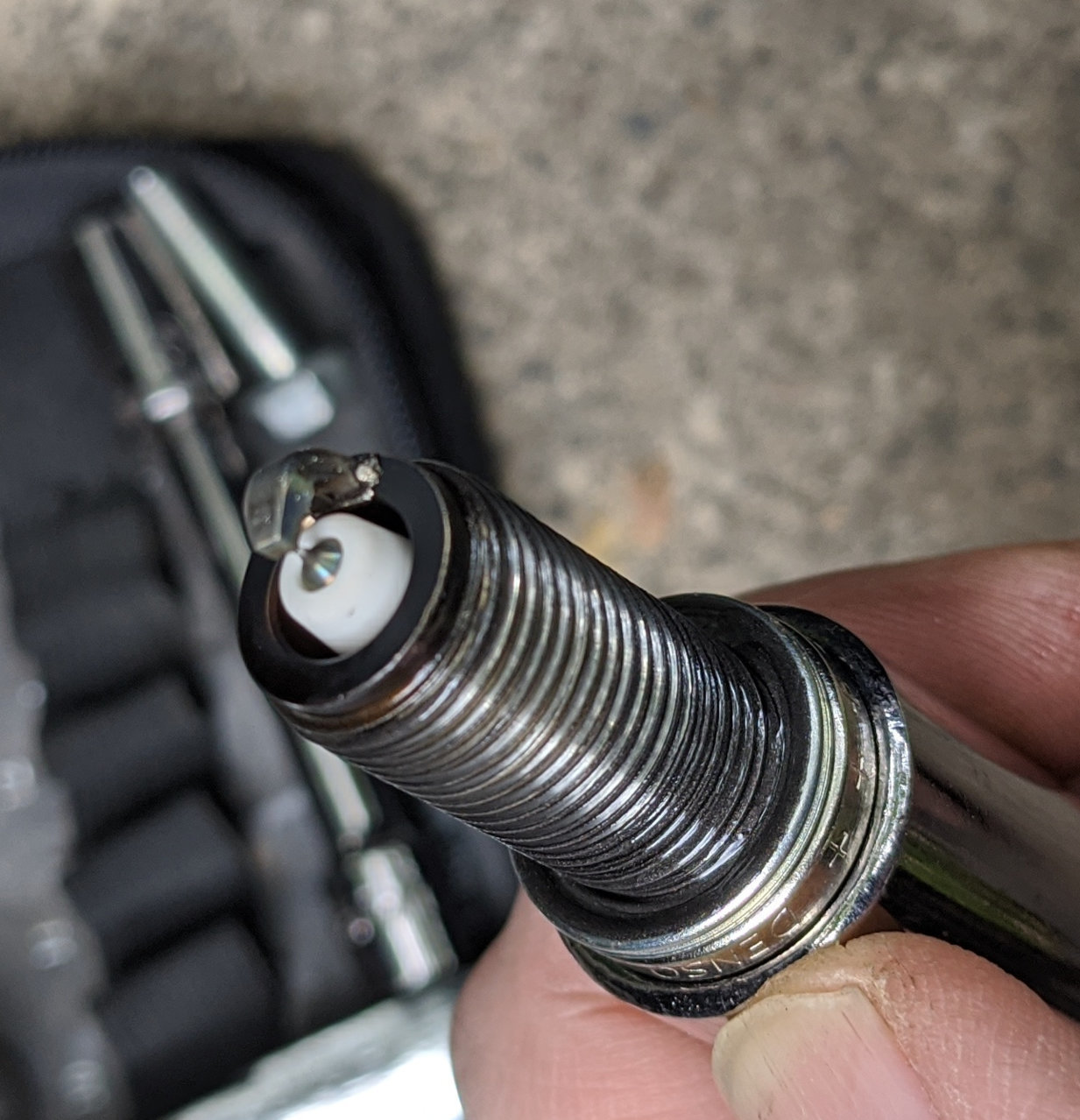

    Was reading through the Magnuson install manual, and noticed that cooler spark plugs are supposed to be installed, and the old ones returned to the customer. I got a box of parts but no plugs.
    I want to pull one and check to see if the installer installed the correct ones. Once I remove one, how can I tell if they are the correct plugs?

    Part # should be on the plug. I believe it should be iridium plugs that came with blower kit.

    My magnuson came with Denso IKH22 plugs, the ones on the passenger side should be easier to get to

    Thanks guys, I'll be checking that out soon.
    Update:
    Yep they are correct, at least the rear passenger one is. :)
    Looks a little too white, possibly running lean?
    Did get my ECU reflashed to TRD spec by @JustDSM so I think that is highly unlikely given all the recs for his work.
    Have a Speedhut AFR all in one on the way so I'll know when it gets here, 6+ weeks! :mad:

    What's the problem? The plugs look great.

    I thought they were supposed to have a little color to them, I'm just paranoid. Thanks for the reply.
