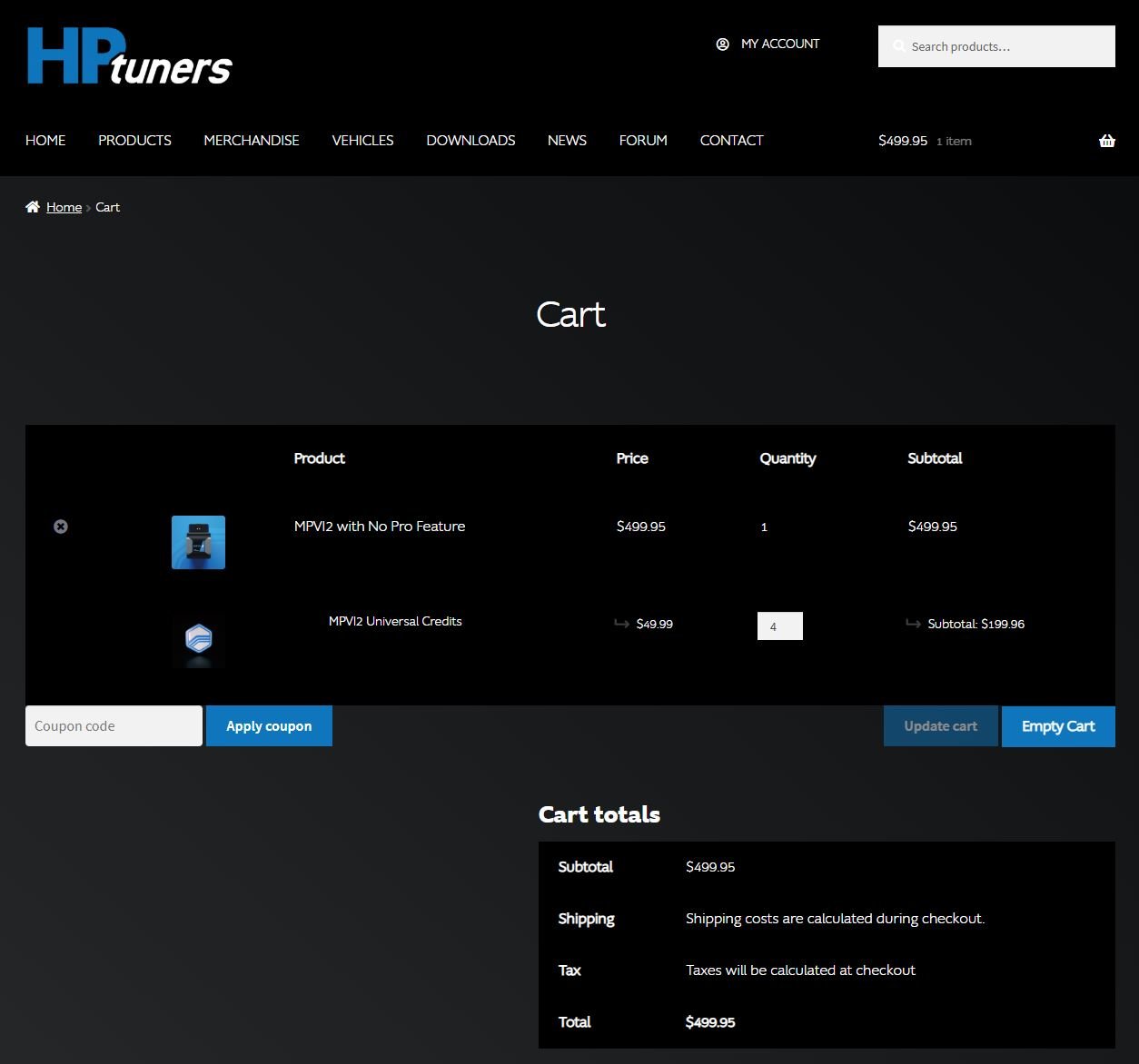

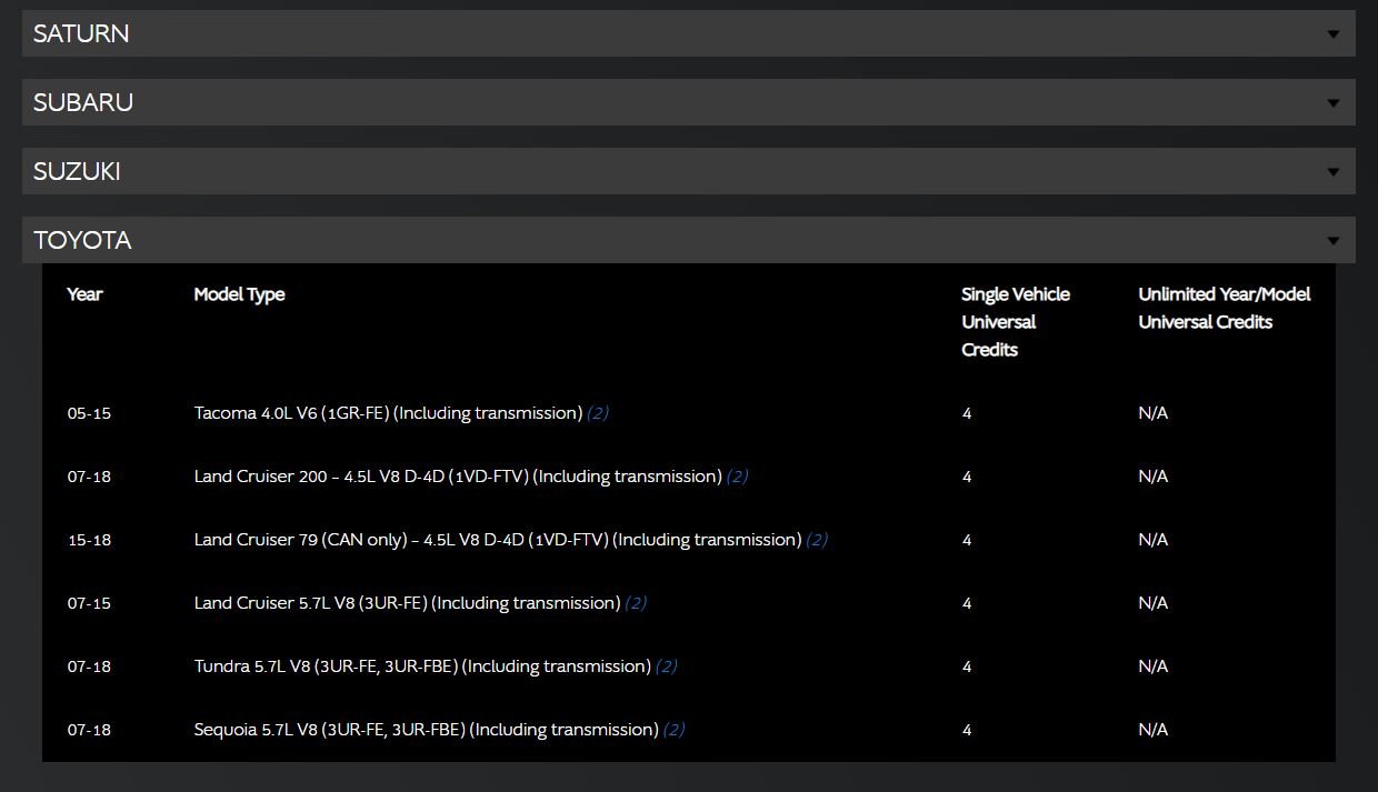

    Awesome! Thank you guys very much for the info, when @loginfailed says 4 credits.. what exactly does that mean..?

    This is sort of like a licensing fee to tune a particular vehicle. You buy the MPVI2 and it can be used on any supported vehicle. But each vehicle requires its own license. Tacomas are 4 credits.
    MPVI2 is $299.99
    One credit is $49.99
    So for a Tacoma you would be at around $500
    See:
    https://www.hptuners.com/vehicles/
    I purchased directly from HP Tuners. There are other places you can get a little better price if you look around a bit.
