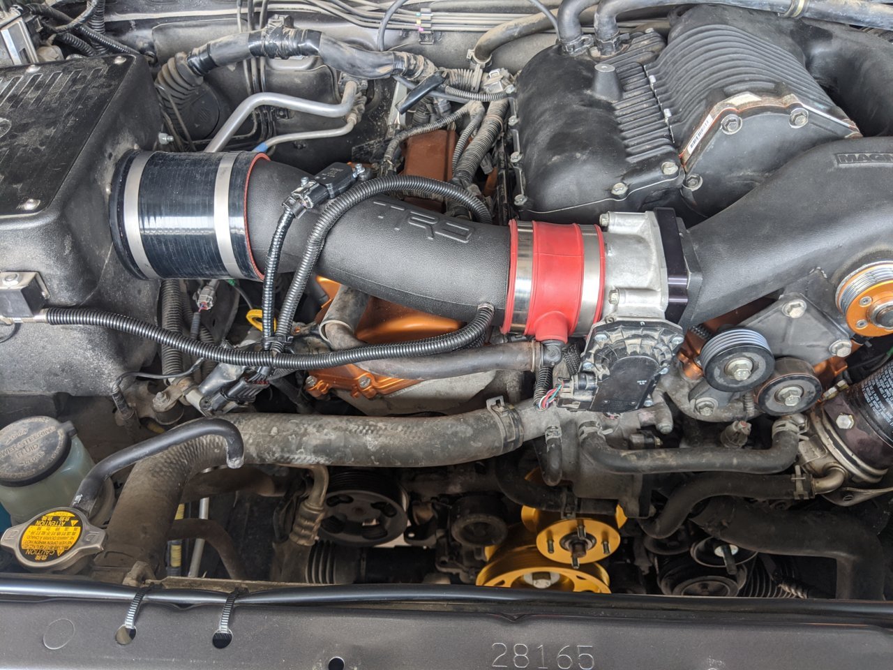

    Well the FJ tube transplant on an AFE airbox seems to be a success. Still waiting on my damn gold alternator pulley, which is in Canada somewhere at least. Should be a couple days and I can finally get this thing on the road again!
