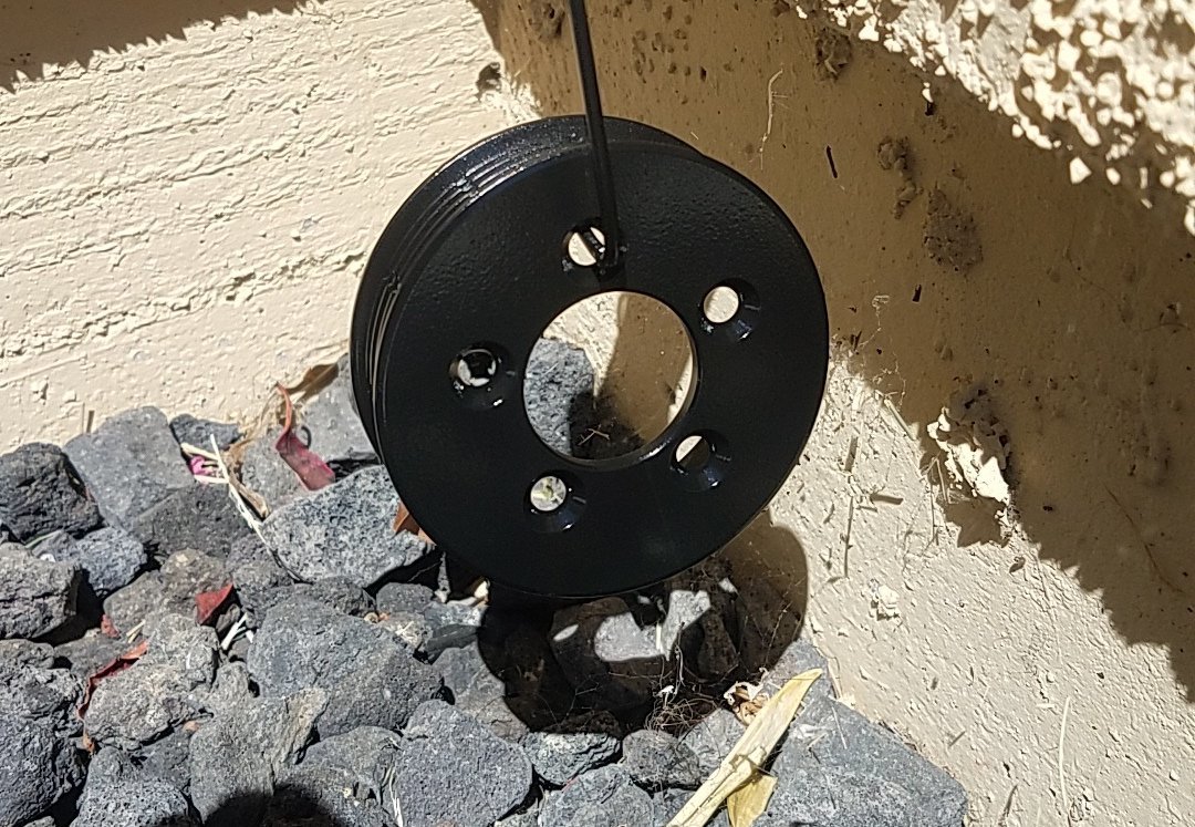

    Speaking of 2.8 pulleys I did a sweet blackout mod on my 2.8 yesterday. Silver to black.
    Look at that sweet 70.5" OE sized length "no cut required" RPM belt. ;)

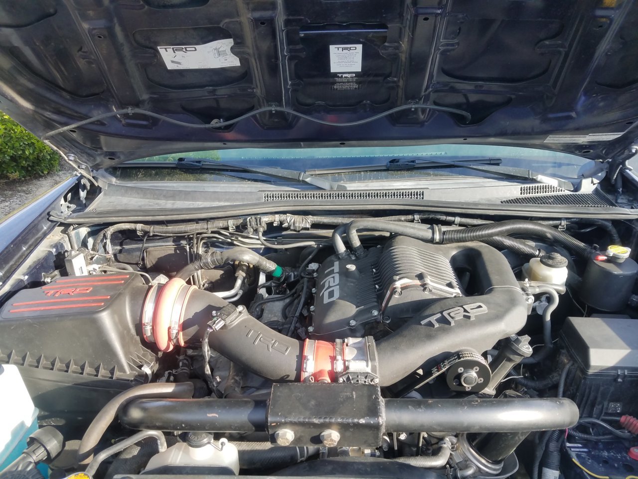

    Mandatory engine bay picture.
